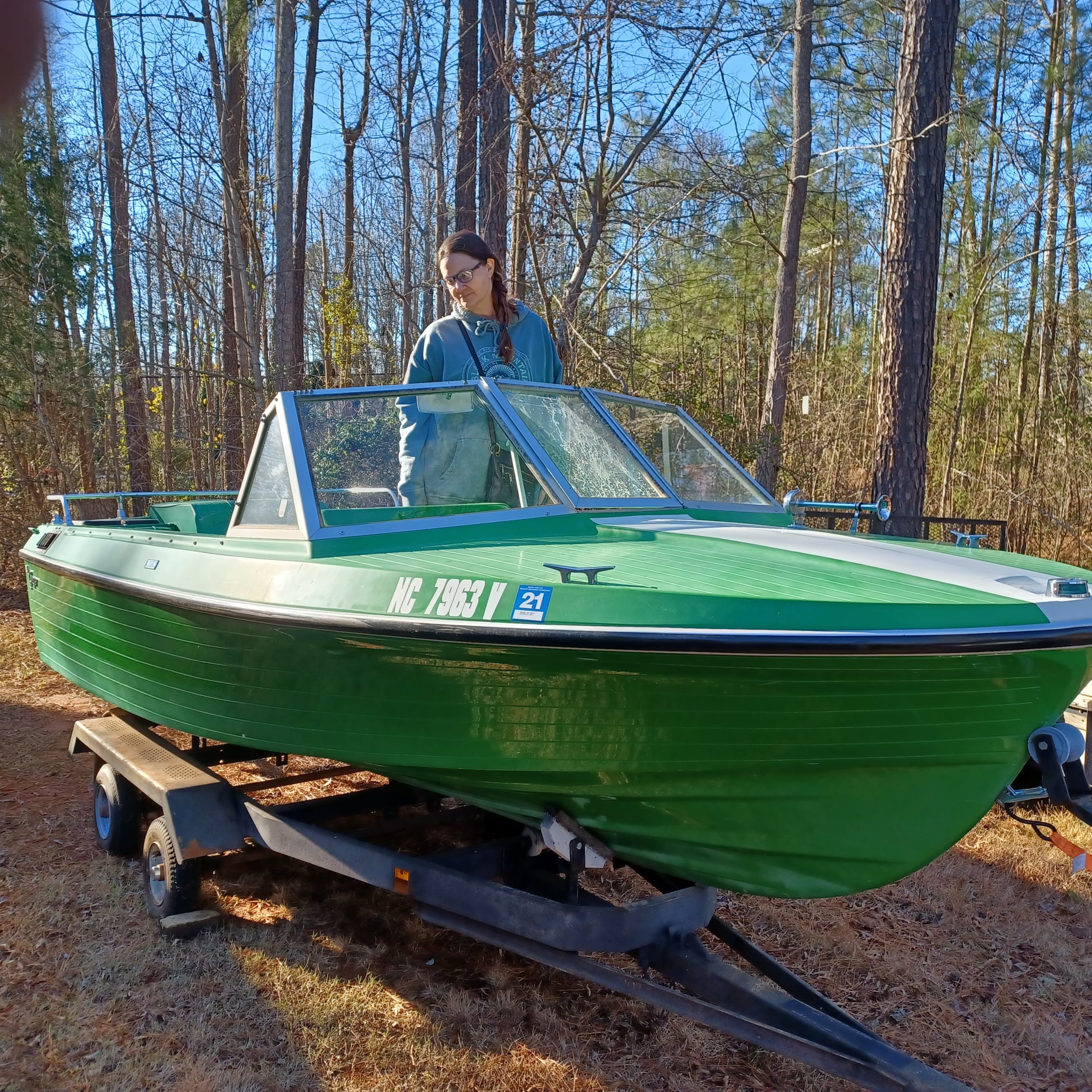

I did it! 100% impulse buy and now I am just sitting in euphoria and obsessing. I am so delighted. But I know I will need a lot of help to preserve as much of her natural splendor as possible. The floor needs to be pulled and repaired and re-fiberglassed. Upholstery needs to be redone/repaired/replaced. Small superficial nick on the exterior I need to patch. And I would love to find any info I can on this model, etc. Bring on the experts! Thanks in advance.

Congratulations! Your "new" boat looks to be in great shape however, replacing the floor is not something easily done. If it feels soft, you can bet that the framing beneath also needs replacing as well as any/all foam, which is most likely waterlogged. It's not really a job for a first-timer. It requires a lot of tools, a lot of material, some fairly proficient carpentry skills, beer and a lot of cussing.

I'm not a misogynist but unless you were raised in a family of boat builders...... It's just that I've seen several failed attempts where the owner tore the whole boat apart, eventually gave up and ended up selling the boat for parts or junk. You don't want to go down that road. If it were my boat, I'd strip the carpet, glue down another layer of 1/2" marine plywood on top of what's there, re-carpet and then go have fun with the boat. Even doing just that will not be quick, easy or cheap. It's hardly the right way to do things but it's expedient and will get you out on the water for a few years until you sell it. Let the next guy deal with decking replacement.

From looking at the picture of the transom/outdrive, I'd guess about 1972. Biggest clue is the access plugs on both sides at the top yet I don't see side mounted trim senders. (Pictures don't have great detail)
Color says early 70s but could have run later (Crestliner & Lund (fiberglass built in Wi) used it into mid 70s.
If you can't see a HIN on the upper right of transom, then it must be pre Nov '72 built.
I'd be a bit concerned if the transom is solid. Check for water leaks around the outdrive.
Truthfully, the Larson/Glasspar boats had nice lines but weren't really well built. Rotten floors came early if they weren't kept dry.

Trisket: I have given this following little piece of advice before. It is meant to be helpful, not critical in any way: It costs more to restore a green '67 Ford four door sedan than it does a "resale red" '67 GTO. The resulting dollar values are about 5 to 1. In other words, pick your fights carefully. If you decide to have a boat either restored or partially restored by a professional, make sure of its' "historical value," so to speak, before you make a major financial commitment. Some boats, the really classic designs, must be saved and cared for. Others should probably just be put out of their misery. Still, others are what you could call "drivers" and certainly worth a fix-up." I believe your boat is one of the latter.
