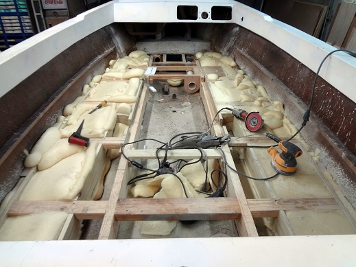

I know a lot of you (especially you Bob) are thinking, "Will I ever be as cool as Nautilus?" Well frankly, no. However, you may, with practice, master the Nautilus highly technical system of installing foam into fiberglass runabouts. To that end, I will enlighten you with the following treatise:
I buy my foam from US Composites: www.uscomposites.com/foam.html You'll need three 16 lb kits of the 2 lb foam (FOAM 0216) for a 17'-18' inboard boat or an 80 lb. kit (FOAM 0280) for an eggbeater. The 80 lb kit is a better choice in either case because if you haven't used it before, you'll screw it up and use too much. You don't like the price? Tough titty! You need it.

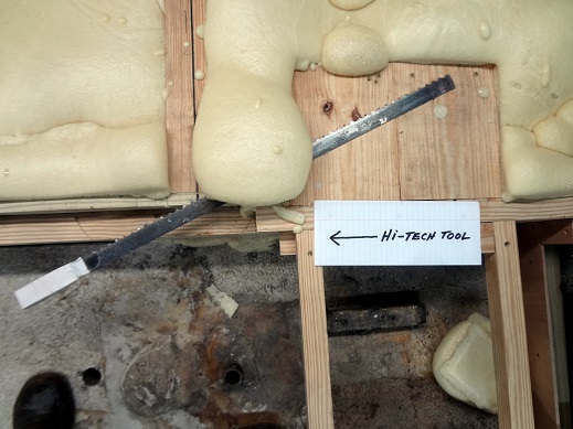

Observe the "slight" protrusions above the framework. Now is when my hi-tech state-of-the-art foam removal tool (in which NASA has expressed great interest) comes into play. It will allow you to remove many of the giant globs that have expanded way above the framework because you didn't know what the hell you were doing and you poured too much.

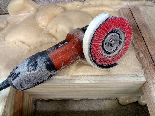

I also use a Sawzall with a 10" blade to cut away any foam that it can reach. After that, I attack with a really mean-looking sanding disc on my angle grinder to remove large portions fast.

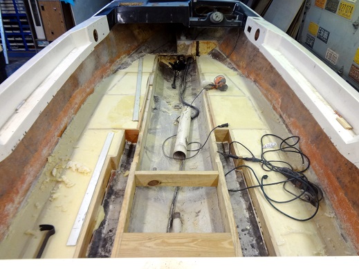

Any low spots and voids can be filled with small pours and finally, a palm sander with 60 grit will easily smooth it all down to frame level.
By now, you are, understandably, overwhelmed by my genius (and who wouldn't be?) and many of you are wishing you were me but don't let envy distract you. If you have followed my flawless directions carefully, the result will be a bilge filled solid with marine foam that forms a hard flat base which will help support your decking and make your vessel unsinkable.
After the decking has been installed, it must be completely fiberglassed-in to prevent any water intrusion. This foam "resists" water but can be saturated over time. Once the foam has become water-logged, your boat could gain several hundred pounds in weight and performance would seem like you filled all the seats with fat chicks. Ride high and dry.

Nice! I really like the high tech tool.......which will remove more than just foam if you're not careful! :)

The high tech tool is a piece of a broken 1" wide band saw blade with 3 teeth per inch. For a handle, I used two small slabs of wood (mahogany of course) and wrapped them with white duct tape. The handle goes on the end that allows you to cut when pulling, not pushing.
The foam sets up fast...really fast. Once you mix it, it needs to be poured immediately, no longer than about a minute lag time before it starts to turn to mush in the container. Over-pours are unavoidable. It's all guesswork. The first time you pour, you'll think you didn't use enough...then you'll watch a giant mushroom form WAY higher than you wanted. At the speed it needs to be poured, it's best to opt for more, not less, to be sure that area is filled, hence the fat blobs here and there.
You should also order about 10 pre-measured 2 quart mixing containers from US composites. They can't be reused so they're a one shot deal. Mix each batch very thoroughly and very fast...then pour fast. The foam needs to set up at least an hour before cutting.
