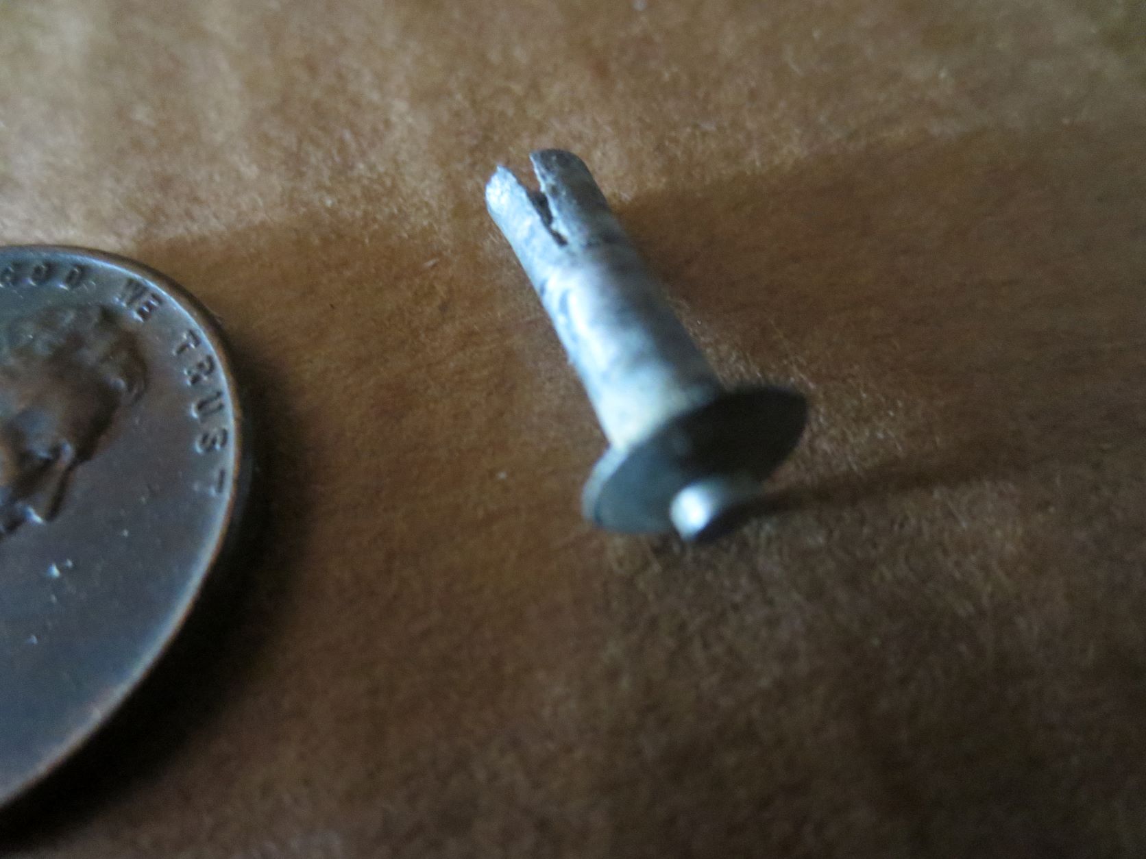

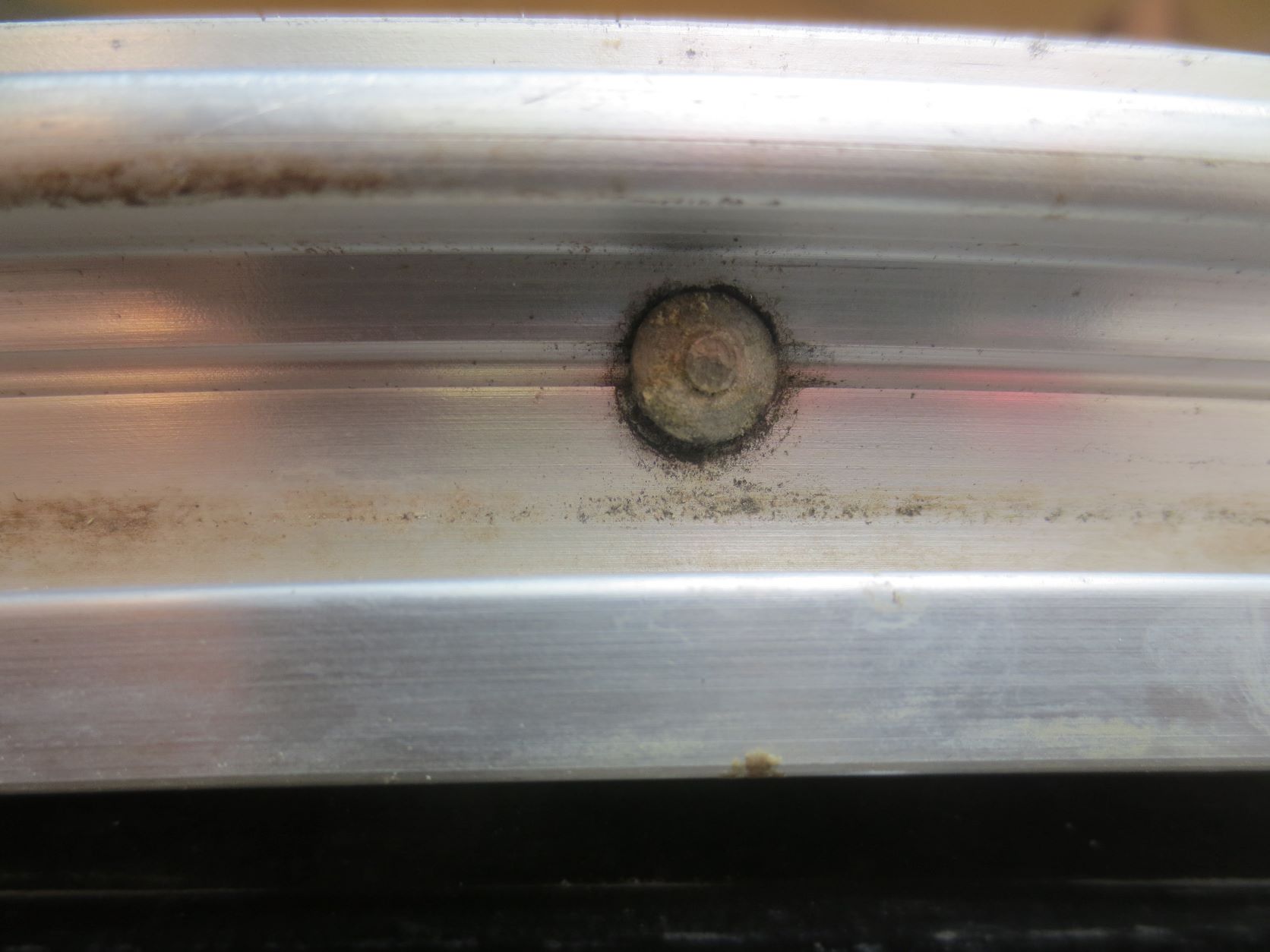

Has anyone had experience with removing the aluminum base for the rubrail on a Seafair? Mine got whacked in the bow at some point and the bow piece is heavily bent. I was able to locate another from a donor but the seller just used a sawzall to get it off, fiberglass and all. I can see a few rivets, easily enough drilled out, but it seems the aluminum is crimped in place to hold the deck cap and hull together. I've been thinking of carefully "walking" a thin screwdriver underneath the hull edge to bend the aluminum out just enough to get it off but I don't want to damage the glass or the aluminum. Any thoughts? It sure would make polishing the metal a lot easier too off the boat.
Thanks in advance!
Eric
Glasspar Seafair rubrail base removal 4 years 10 months ago #145686
Hello Eric,
The base simply slips over the sandwiched edges of the top deck and gunnel and is riveted.
Can be tight may require some persuasion to knock off.
Most of these rivets pulled or pried out. Be careful to remove the complete rivet when drilling them out.
Get help cuz that 12’ extrusion takes some wranglin.
Terry

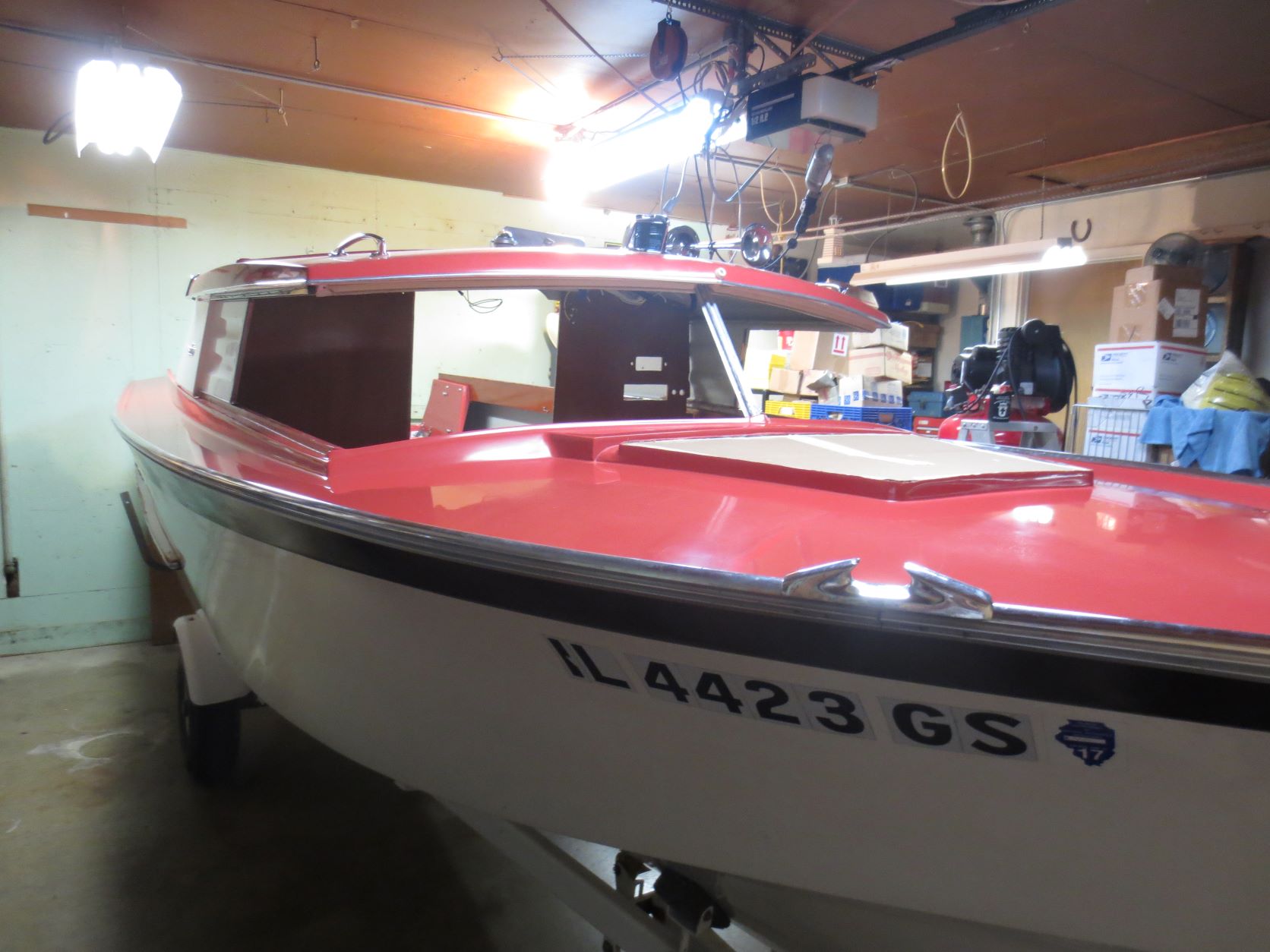

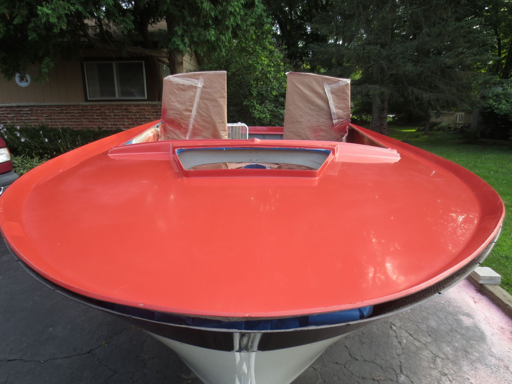

With all the aluminum off, are you able to achieve full deck separation? That first picture certainly looks to be the case. Because I was thinking it might be a good idea to add some stiffening to the underside of the deck. I notice when I walk around on it , especially the narrow section along the sliding windows there is a decent amount of flex that I fear could contribute to new spider cracks.
Also, it would make access for cleaning and painting of the chain locker and other areas much simpler.
As ever, thanks for the info and the great pictures. You sure love that boat, and it obviously loves you. What year(s) did you do the restoration?
Eric
Glasspar Seafair rubrail base removal 4 years 10 months ago #145783
Hey Eric,
Yeah, the cap should lift off with the rail and motor well removed.
