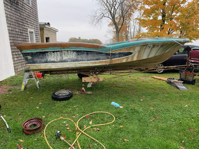

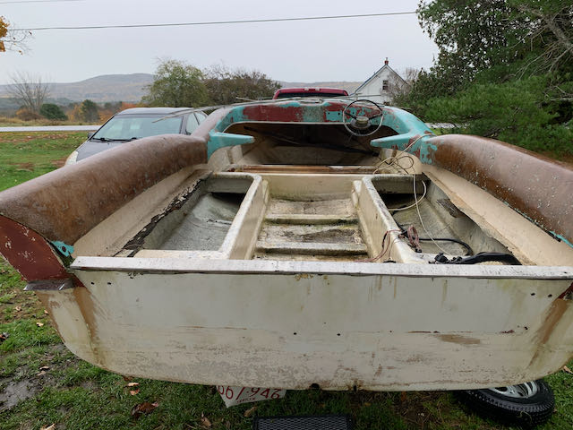

Getting ready to start a new project. I got this years ago from a guy who had started to grind off the badly weathered gelcoat and then abandoned ship. I've been looking at it for years, knowing that it would be a huge project, but a friend recently looked at the boat and got very excited and offered to help restore it.
Starting question: The remaining gelcoat looks to be a turquoise color. The 1958 brochure lists Bimini Blue. Could Bimini Blue, baking in the Texas sun for decades, have faded to look like turquoise?

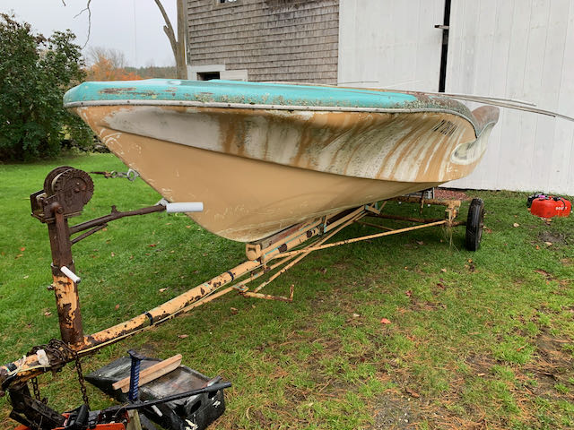

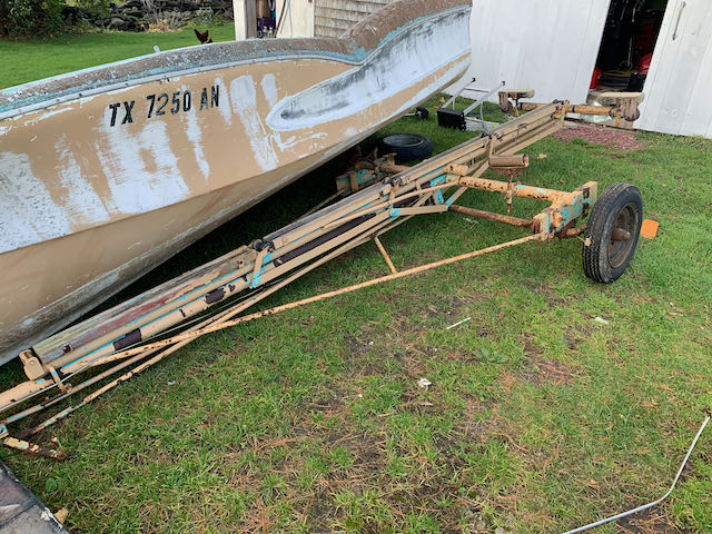

Question 2: Anyone know anything about this trailer? It has a funky lever/lifting system for launching the boat. I wonder what the fenders would have been like? The tongue is bent. Gotta figure out how that can be straightened.

kensikora wrote: Looks like it could be a Tee Nee.
www.fiberglassics.com/library/index.php?title=File:Teeneea58004.jpg
Thanks for the suggestion, kensikora, but this trailer has a tubular main beam that is very different than the Tee Nee.

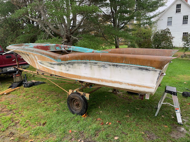

High winds blew the boat off the trailer so here's a view of the complex lifting system to add more clues.

And your trailer is an engineering marvel.

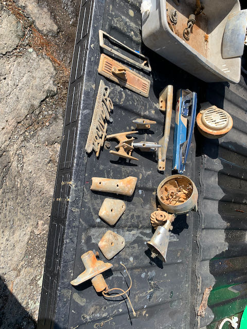

Terrydi, thanks for the photos of your friends' beautiful restoration! Very inspiring......and somewhat intimidating. I'm missing some of the cast trim pieces. I know it will be a long time before I'm ready for those but I'd better start the search. Kevfin shows some recast pieces on his website but the contact links don't seem to work.

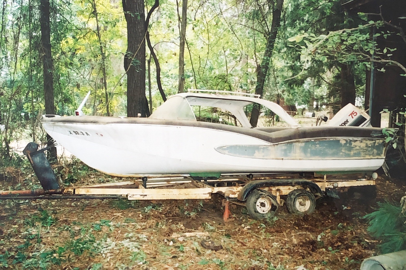

Nice boat! I have a '58 Seaflite too. Just noticed how similar our TX numbers are, but these were made in Austin I suppose.
I think the original paint was the red gelcoat, and someone painted on the turquoise later (as well as the black stripe, which was originally vinyl glued on).

You're lucky to have that hard top!

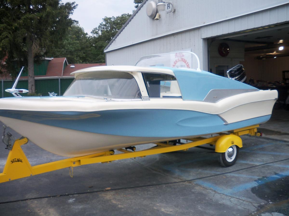

Hey David,
Coincidentally that is KevFins Glastron. We haven’t spoken lately, but you should be able to reach him at the Gem Shop in Rockton IL.
He may be able to splash you a hardtop too.
Good Luck, Kev and Becca got hitched a few years back and I know she was keeping him real busy.

Bill showed this primo example on land at Geneva Lakes in 2011 . Cant find my pics but I think he submitted this image with his entry.

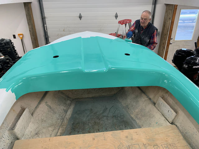

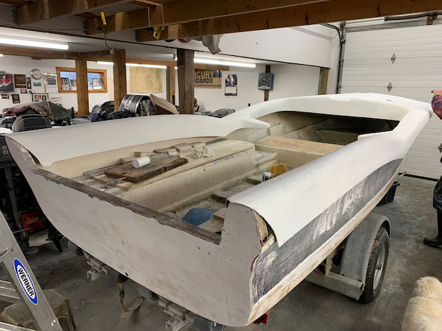

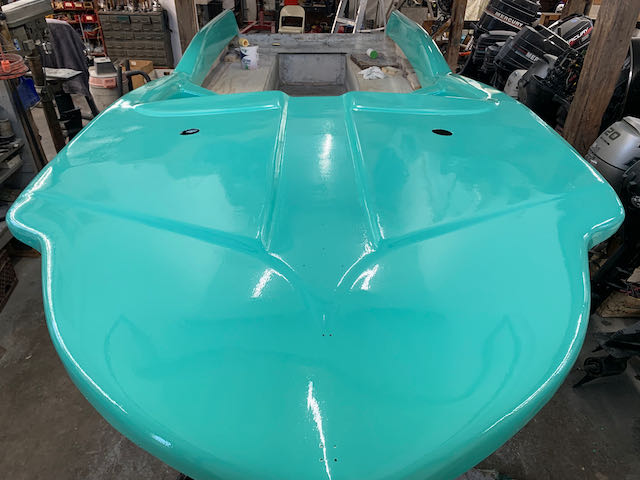

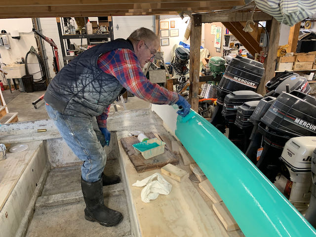

Making great progress on the Seaflite. Deck repaired, faired, primed and first coat of paint. Transom repaired. I'm missing many of the castings. for the trim : (

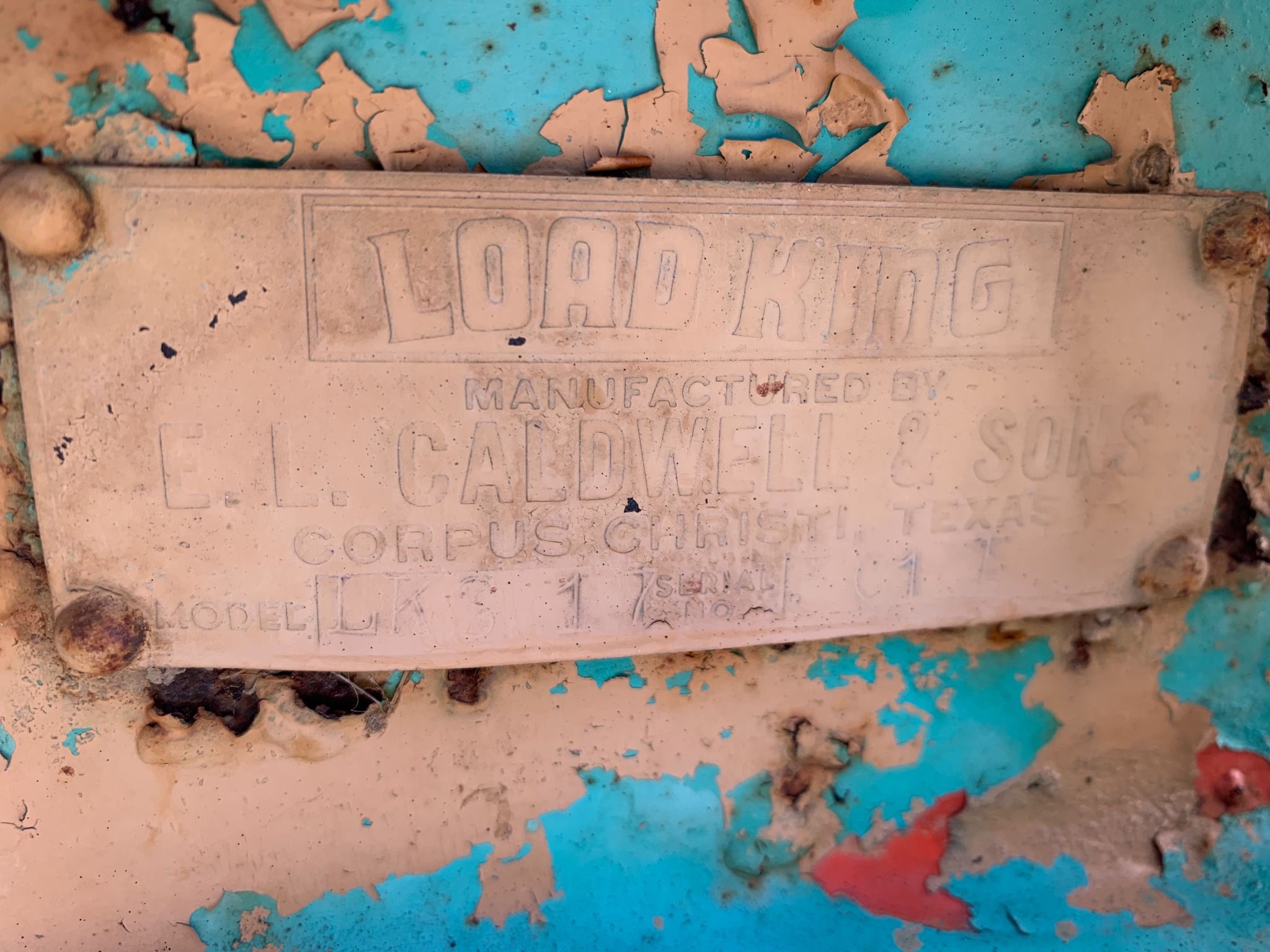

Found this tag today on the mystery trailer. It's a Load King LKS-17
