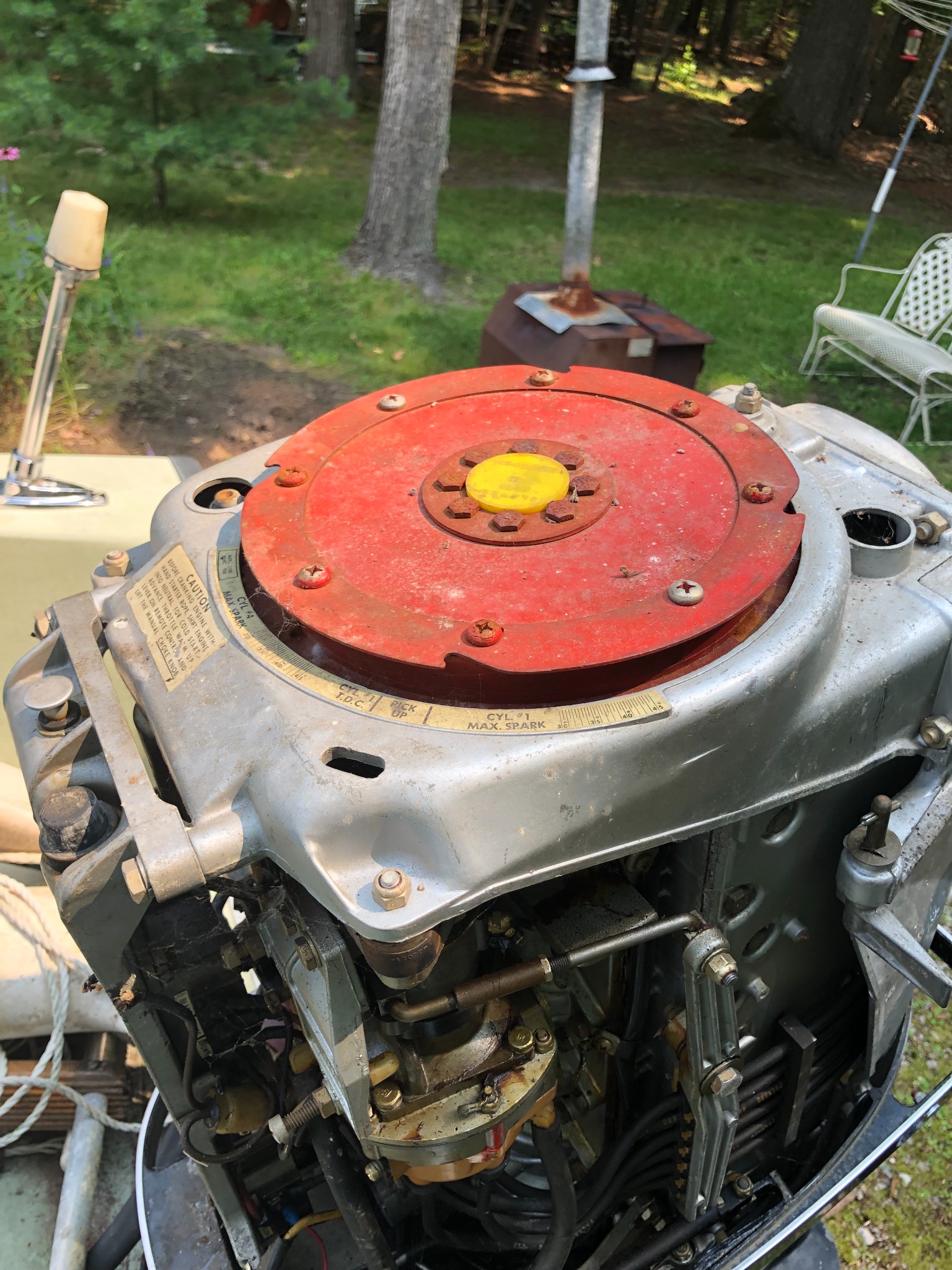

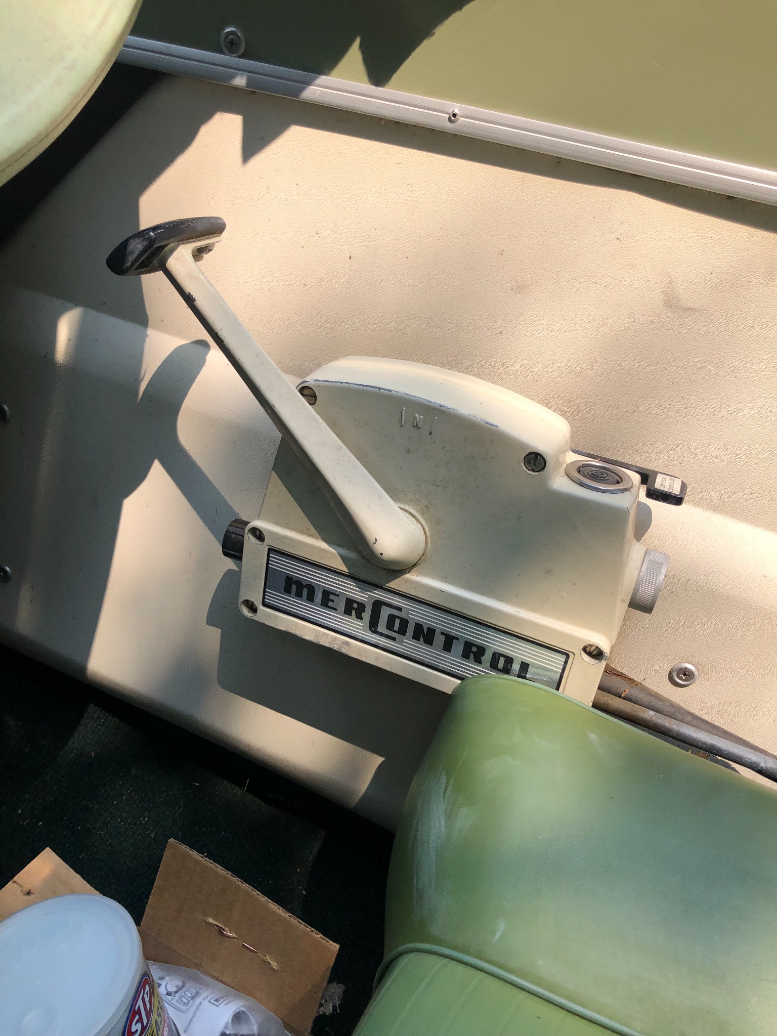

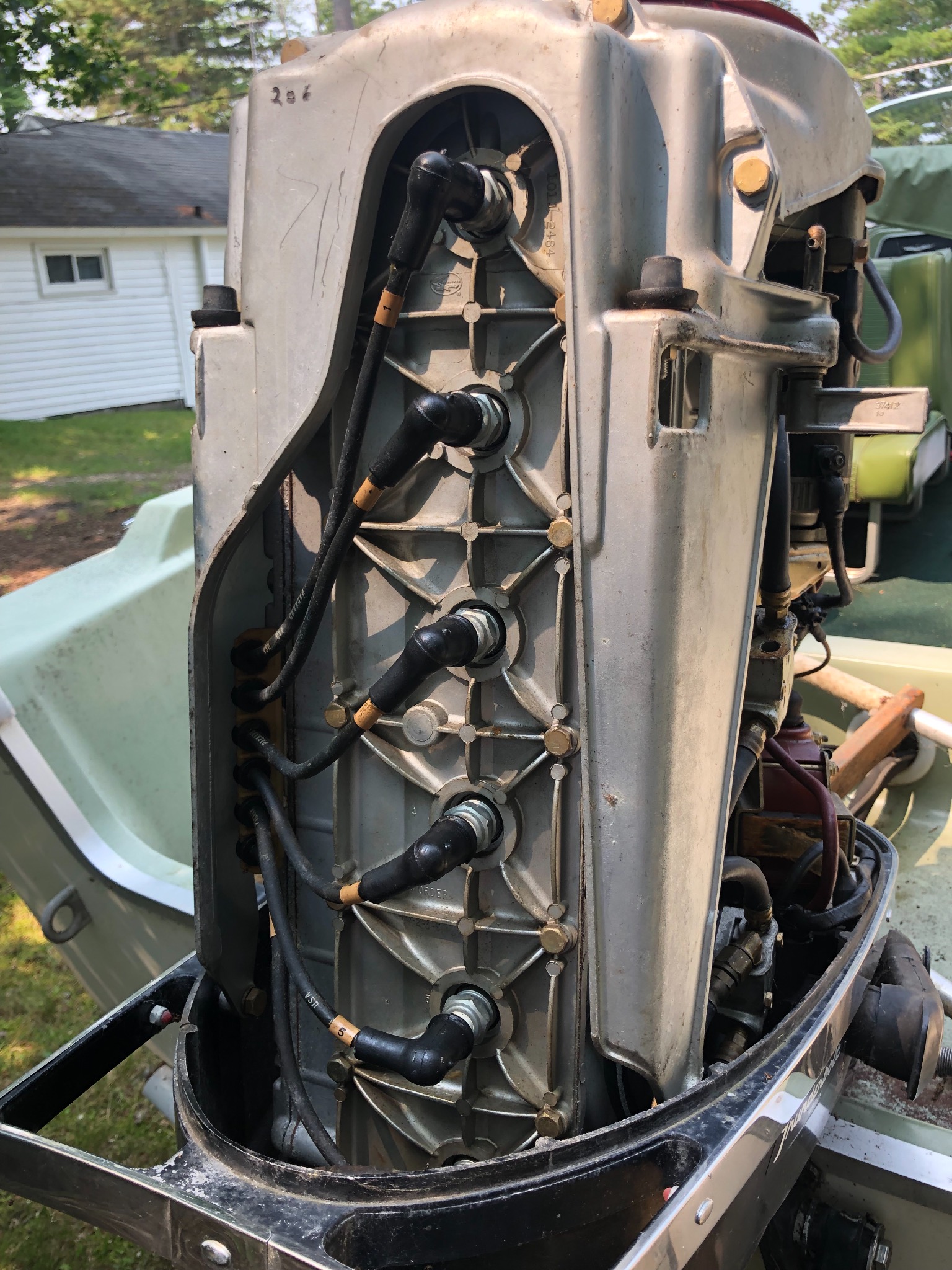

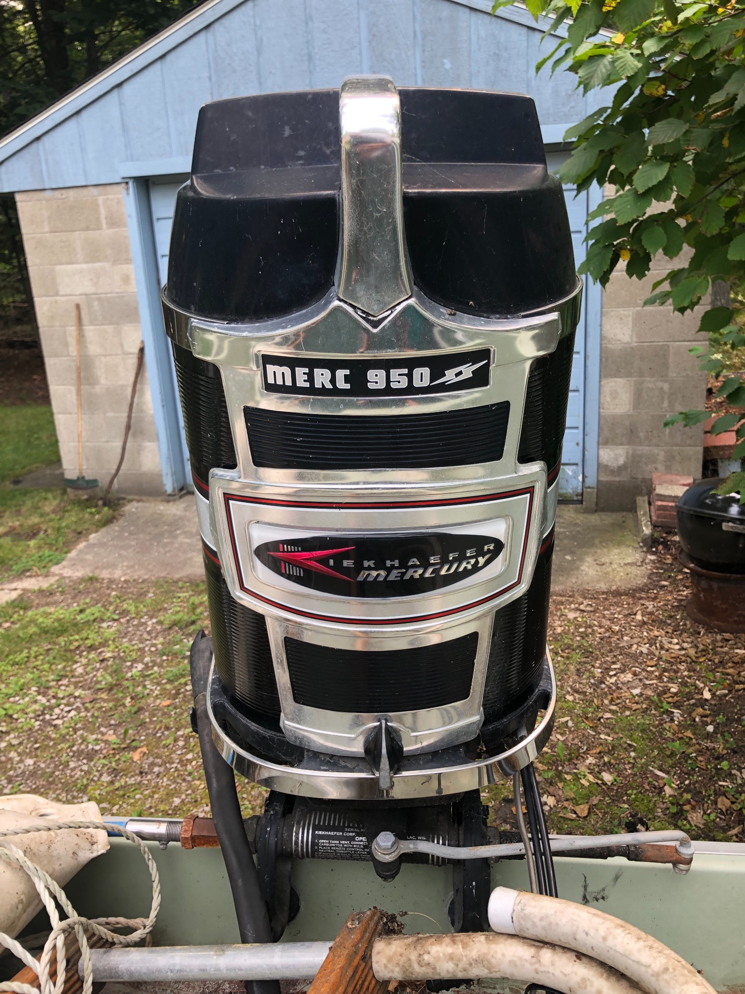

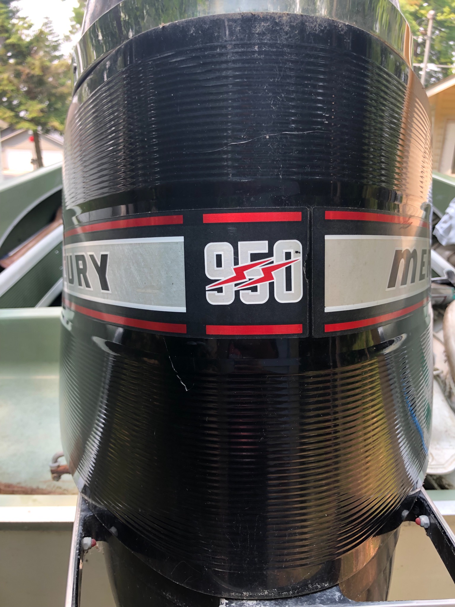

Hi All! I have recently acquired a ‘67 Larson All American with a ‘67 merc950ss on it. Neither have seen the water since ‘09. Both have been garaged most of their lives. Both are in extremely good condition. All of the controls for the motor are free and functional; steering, starter, elec. choke. The lower unit has been drained, refilled and there is no visible leaking (wetness) anywhere around the unit/drive area. The owner stated that the impeller had been replaced but may open it up and check it regardless. I’ve replaced the primer bulb and any other rotted fuel lines exterior of the motor. All lines interior appear serviceable. I’ve pulled the plugs, fogged the cylinders and cranked the motor on the starter to distribute oil. All cylinders have good compression and the rotating assy spins beautifully. At this point im going to make a heavy oil/fuel mix and give ‘er hell.
I’m really expecting the fuel pumps/carb diaphragms to be the weak link and am looking for info regarding replacement parts/overhaul kits. I have seen some YouTube stuff on old marine motor start up and have read some of the forum material in the same. I promise ill try and not be a giant pain in the ass……but I figured I’d rely on expert knowledge before i wasted too much time fishing about.

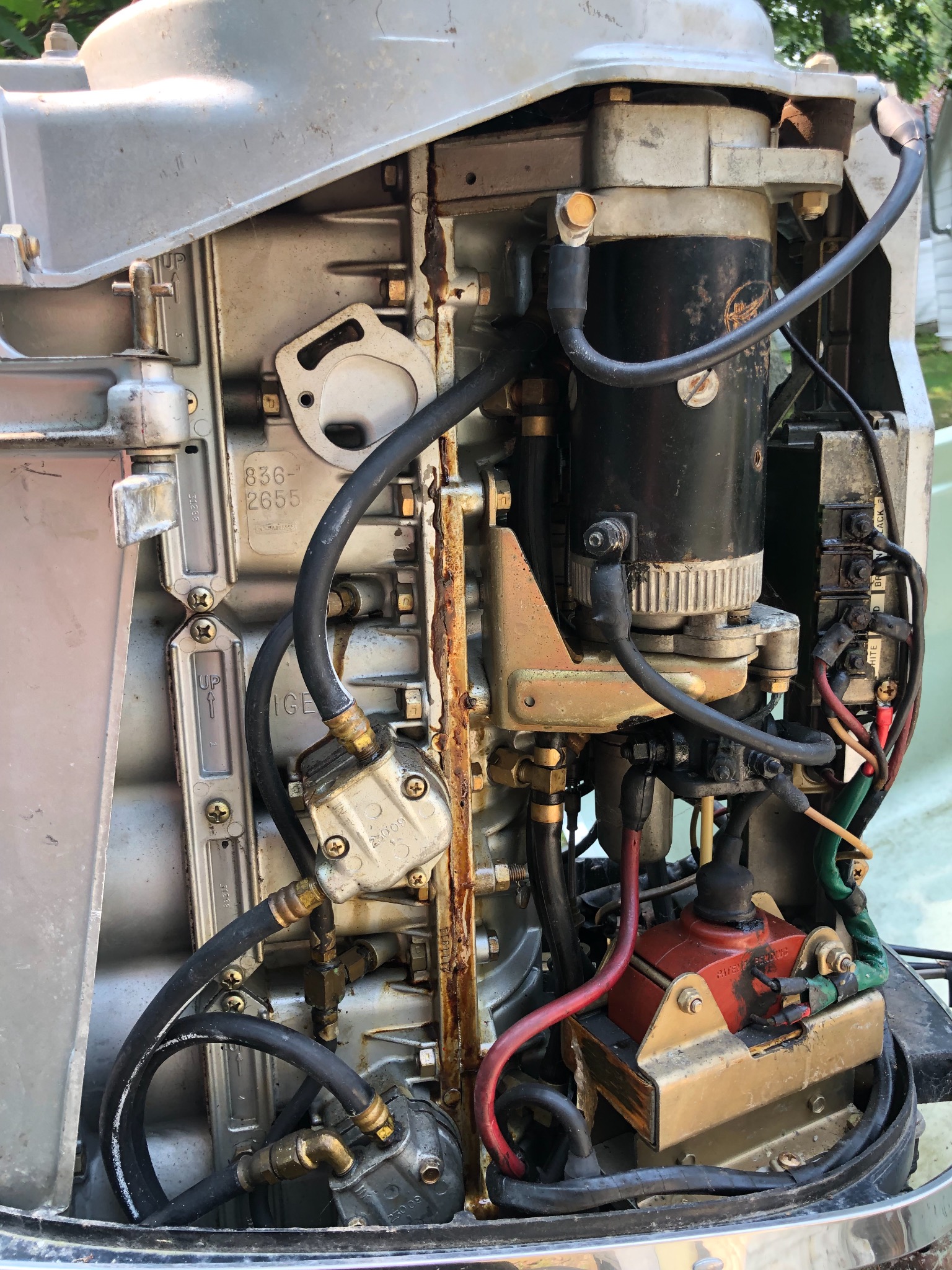

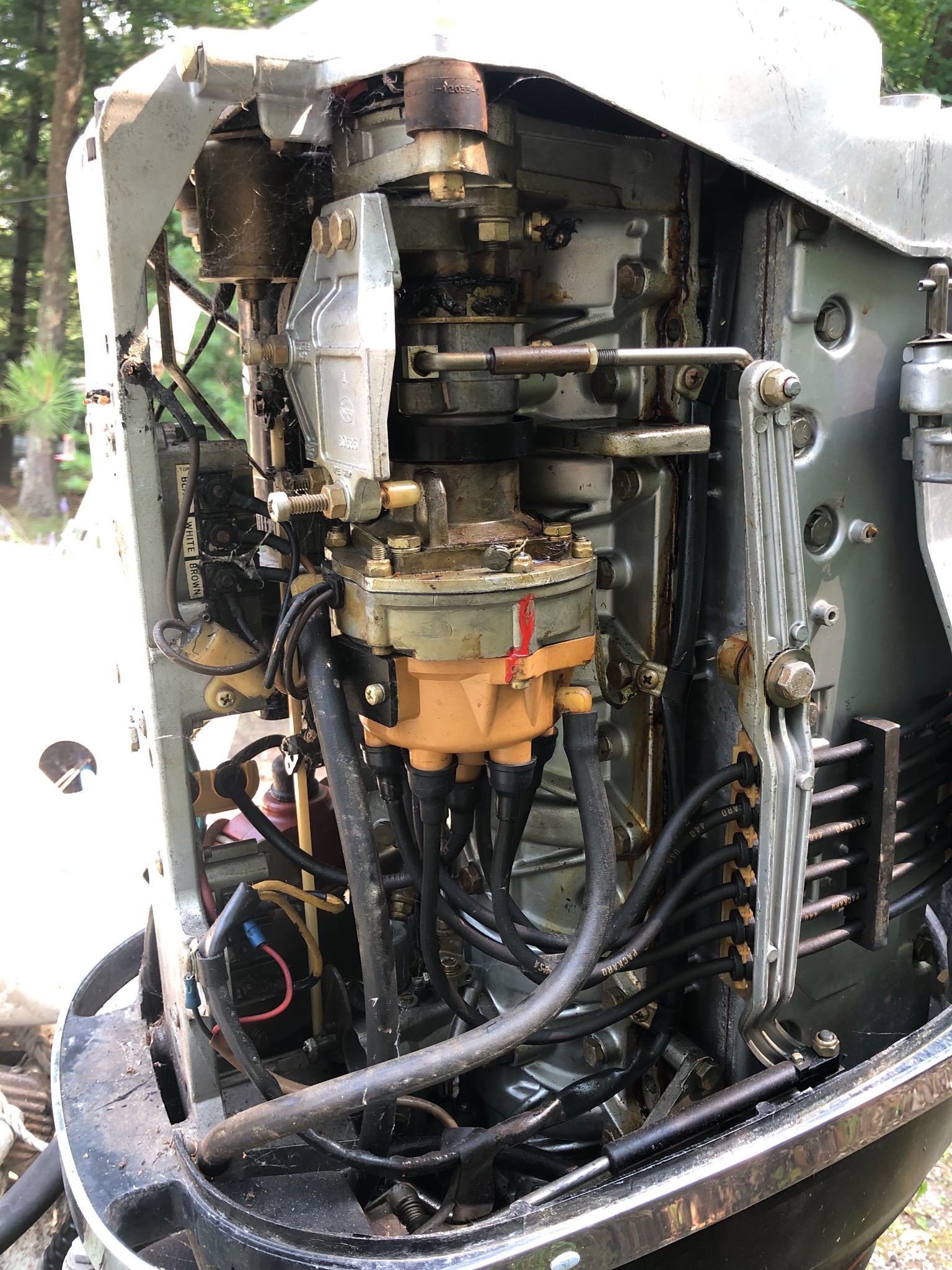

So.......the usual can of worms has been cracked open on my '67 950ss. Rebuilt the fuel pumps and pressurized the fuel system via primer bulb to see fuel pissing out of every factory crimped end on every fuel line under the cowling!! Given the supple condition of the lines themselves, was a little surprised that the connections were the weak link. Oh well, a resto is a resto, right? Have decided (based on parts avail/unavail)to build my own lines. Feel as tho i need to try and maintain OEM volume/flow as much as possible?? For access removed starter/soleniod and what im assuming is the coil? Not fun. During this process have discovered that the main wiring harness is 50/50 trash. Was fully willing to cut back to clean wire, splice in and try to keep the OEM merc plug etc intact.......but just not an option. The choke wire and the main power feed are losing casing at an alarming rate dangerously close to the plug. The harness, for safety reasons, needs replaced. In your opinion is the a/m unit avail from marineengines a decent product or should i be looking somewhere else for a harness?? Also.......and this is embarrassing.......where do i find a good shop level manual for this thing?
Swimming in the deep end.......
Michael.
1967 mercury950ss 4 years 2 months ago #146820
I prefer the after-market CDI-electronics components, and use them exclusively.
The internal harness part number from CDI is 414-2770
You will have to fabricate a retaining piece since the 950ss used the (4) screws through the side of the engine pan, where this harness is specifically designed to replace the harness on the 1973 thru early 1979 inline-6 harness,
Another option, that avoids the cost of the replacement internal harness is to drill a hole in the front of the engine pan, insert a grommet, and hard wire in your external harness.
