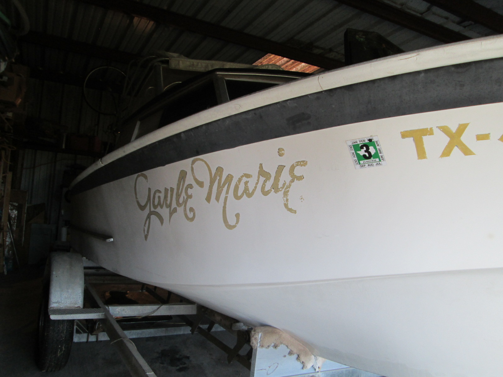

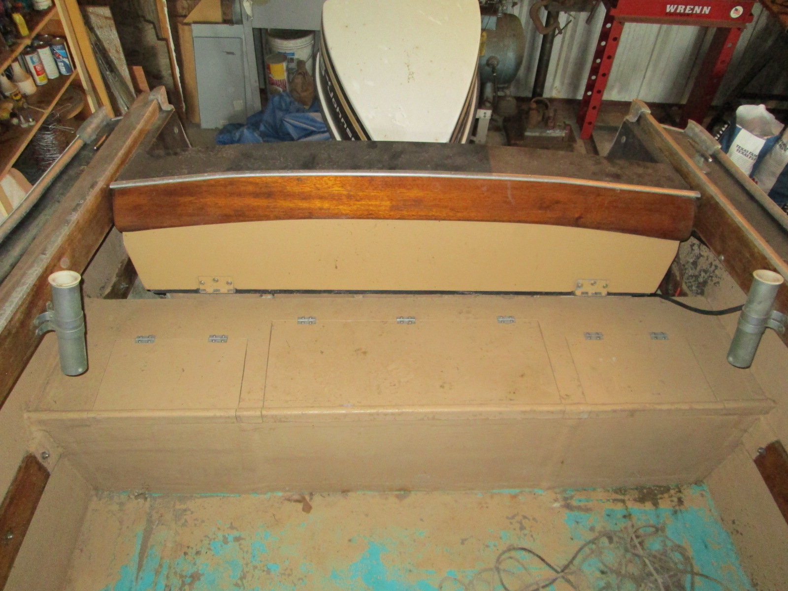

This is my Granddad''s 1959 Seafair. It's been around ever since I can remember. I know he bought it used in the early '60's. I've had it since he passed away in '82. The "Gayle Marie" was put on by the original owner.
It (obviously) has never been restored. I know it's not much to look at, but I haven't used it much the last ten years. Hopefully that will change.

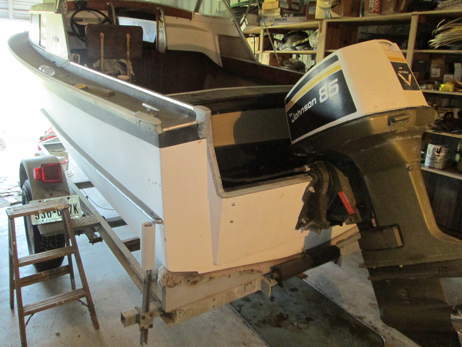

When I was about 12 he took it into a huge boat shop in Houston. I remember it lying on its side and guys doing fiberglass work on the bottom. I'm guessing that was 1975 because the 85hp Johnson is a 1975 and it would make sense that he repowered it at that time. I do not remember the original motor at all.

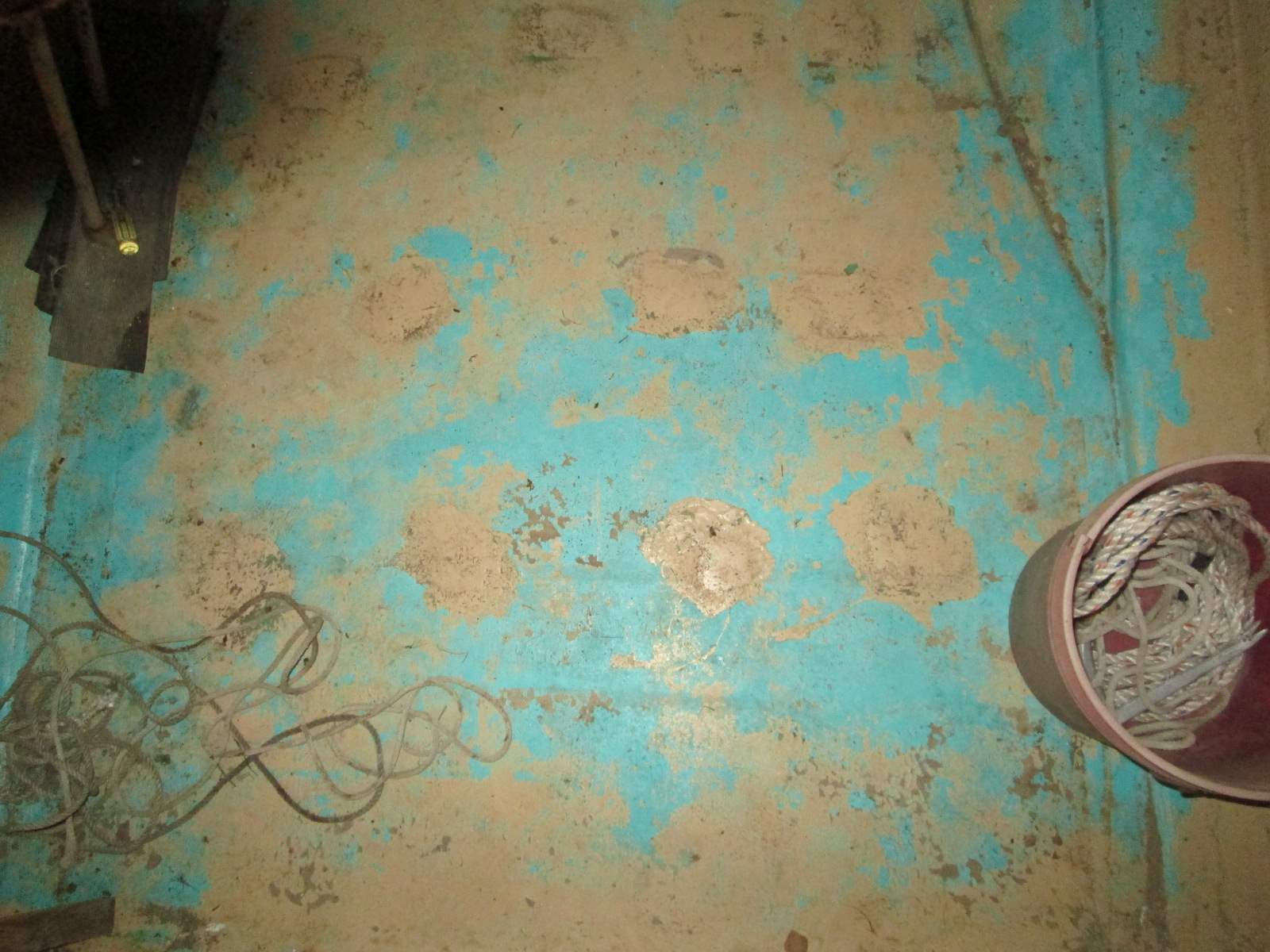

After seeing all the stories here and elsewhere about stringers and transoms, I'm wondering if they did any work on these. The floor and transom are both very solid. In one of the attached pics, you can see the floor and it looks like there are holes drilled for foam . I know there is foam in there because I can pull pieces out through the drain plug. What do you think?

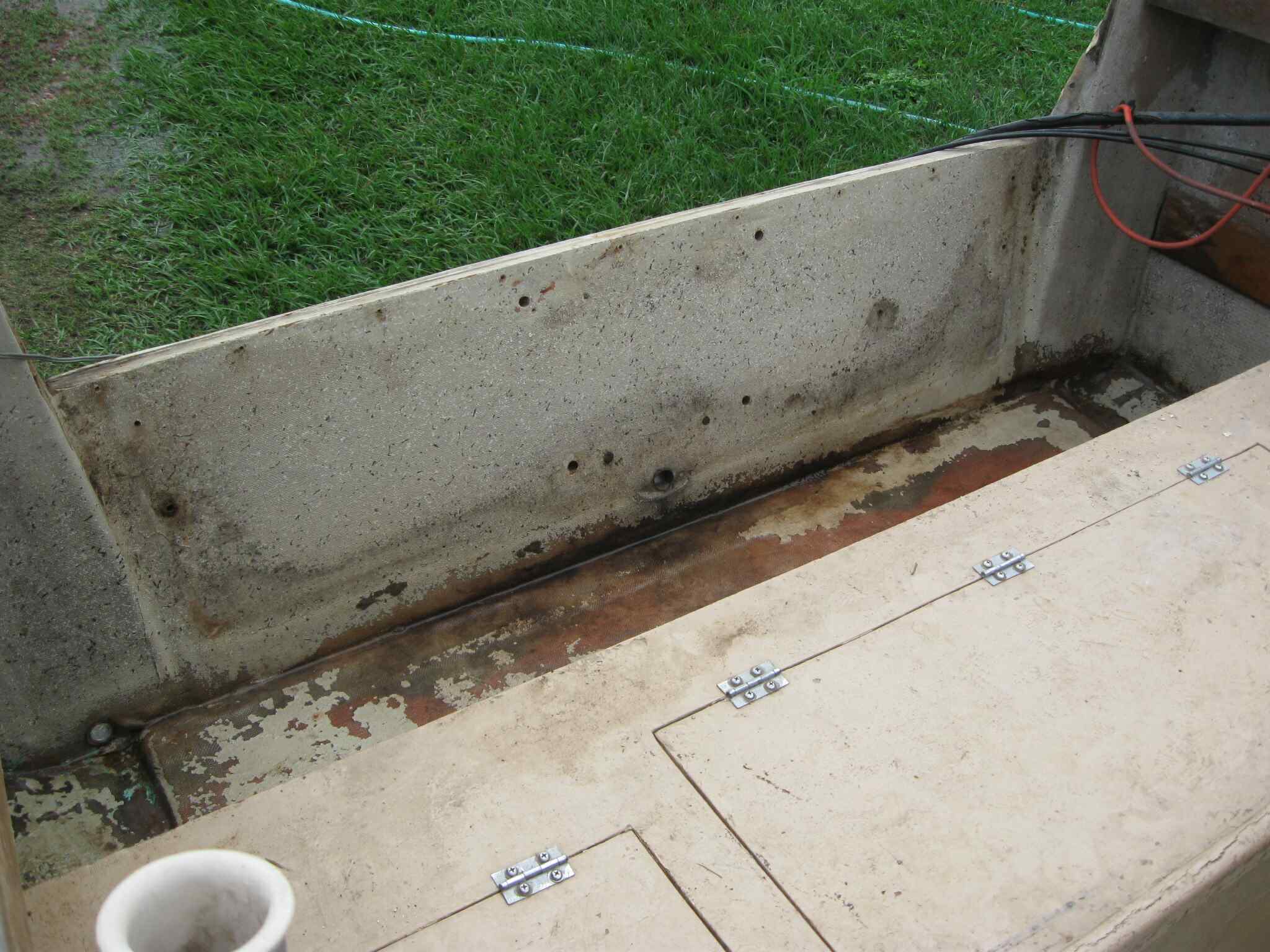

The bait wells have been there as long as I remember. I thought they were factory until I saw pictures of other Seafairs. Now that I'm curious and I've got room in my barn, I'm going to pull the engine and rear well and take a look back there this winter.
I bought the black rub rail and will put in on this winter. I'm kicking myself for not buying the white when it was available, but at least I'll have something. It's really going to change the look of the boat.
I'd like to replace the forward non-skid deck mats while I still have something to use as a pattern. Anybody (Terry) know where I can get the material ? I also wonder why it's left hand drive. Any comments are welcome. The last pic is from 1975-76.

Hey. So I wouldn't know anything about the presence of foam within, although it certainly sounds like that may have been done at some point. I'm still wary of flotation foam for my '59 when it comes time to put floors back in. I've read so much about it becoming waterlogged over time and adding tremendous weight to the hull.
As far as the boat having the helm to port, back in 1959 there was no standard yet. Mine has a more traditional Starboard helm. But that makes your boat a little more interesting. Drive stations were set up by selling dealers from what I understand, so you could choose either.

The only question I have about your Seafair is, is the black paint or original gelcoat? I've only seen one other in black and I'm not sure if that was redone as such. In clean shape it really looks incredible, though.

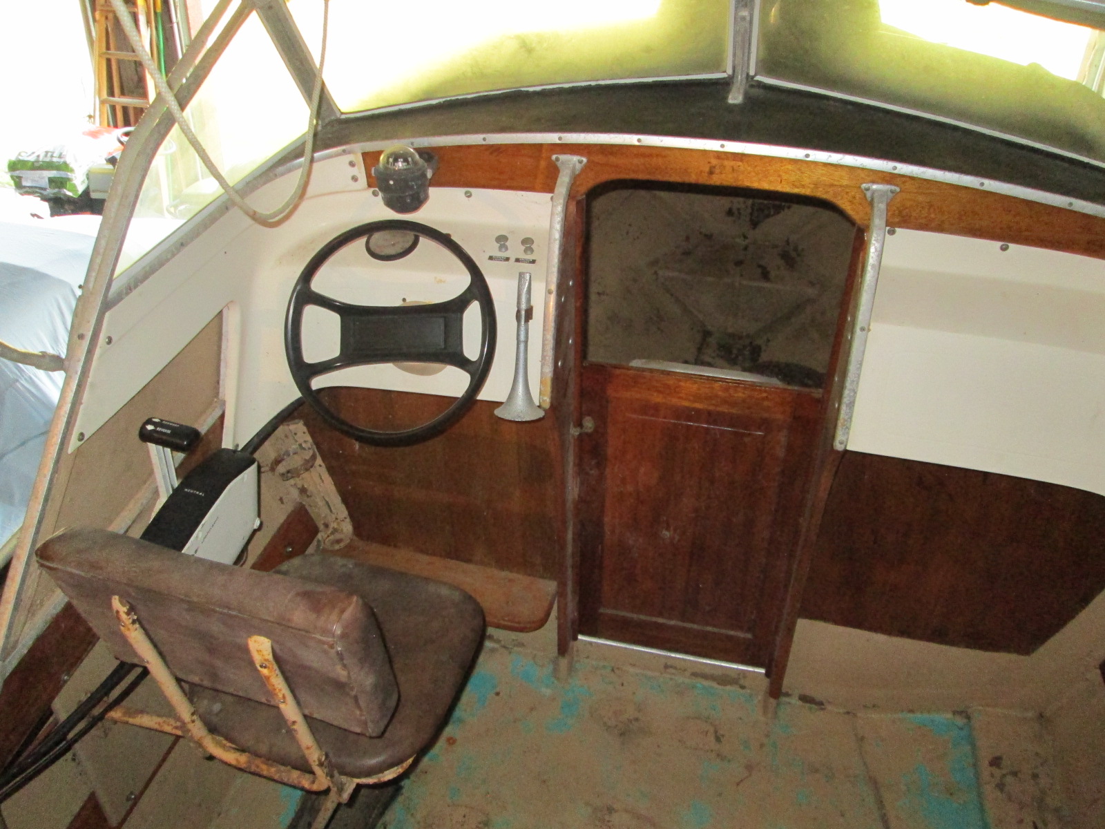

Looks to be a very original 59. Hope you have the Glasspar data plate that is missing here above the door and do you have the model number which was stamped on that plate?
Good shot of the original helmsman chair which was standard while the passenger chair was an option.
Yeah, somebody custom built those wells and obviously this boat was all about catching fish.
The 59 Seafair had a sealed bilge so foam would have been added at some point. If she was stored dry you may be OK and overall she looks solid in these photos.

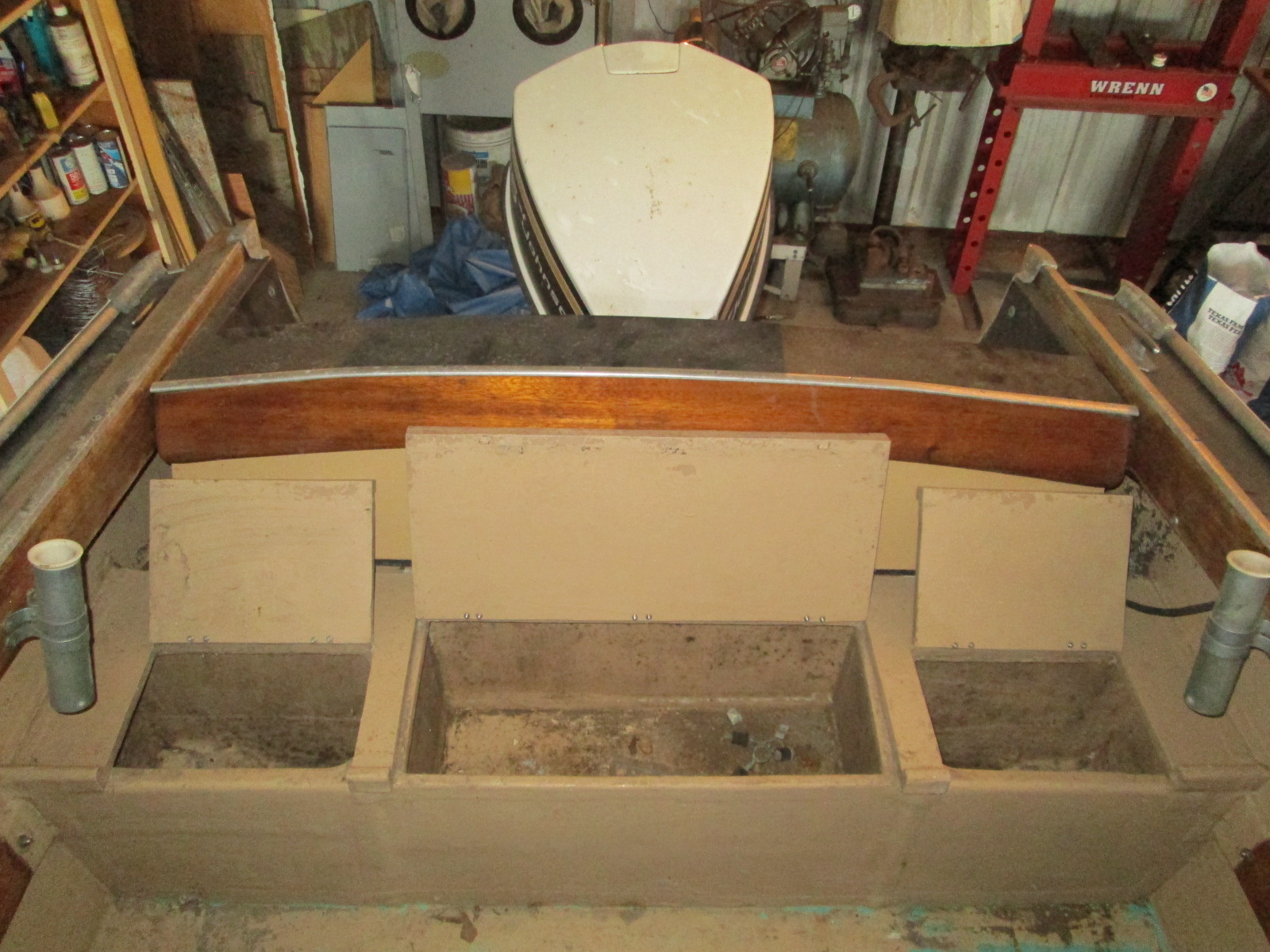

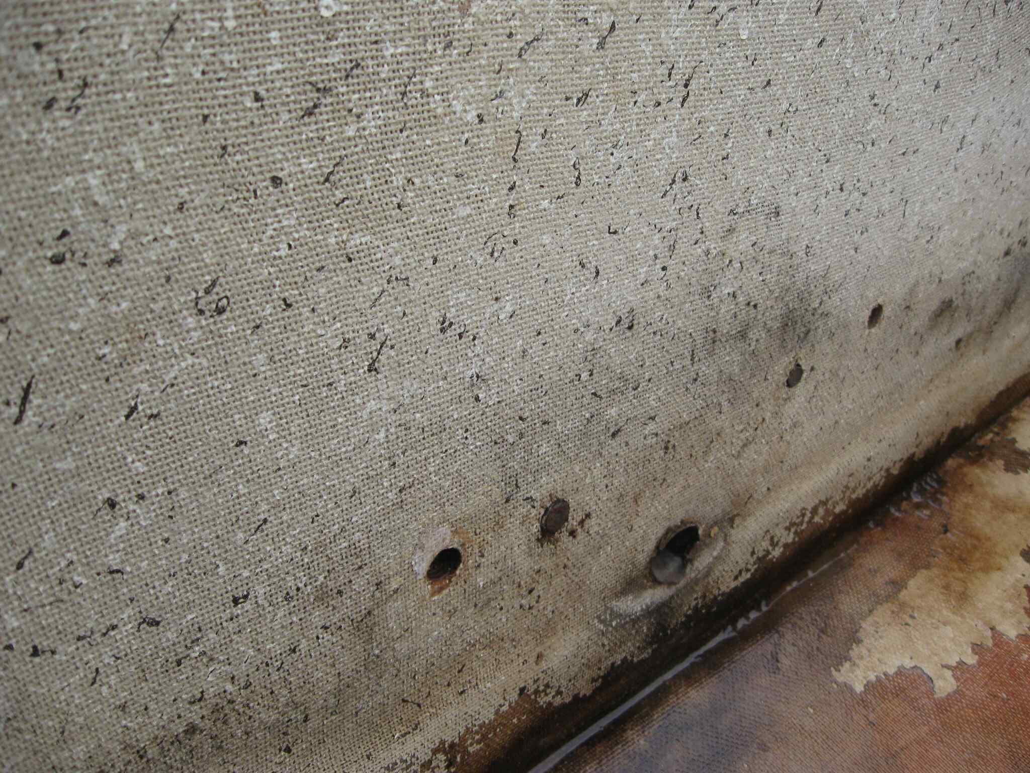

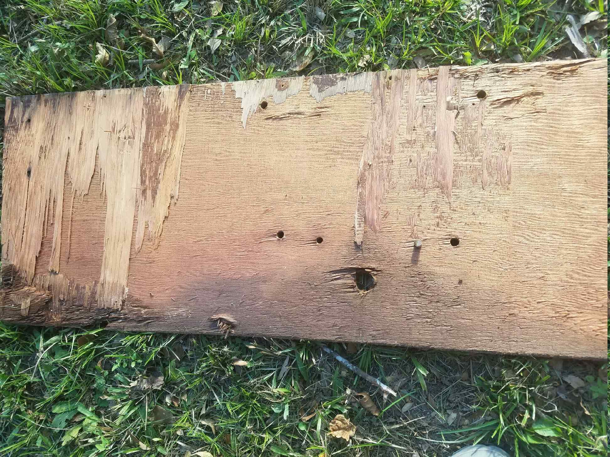

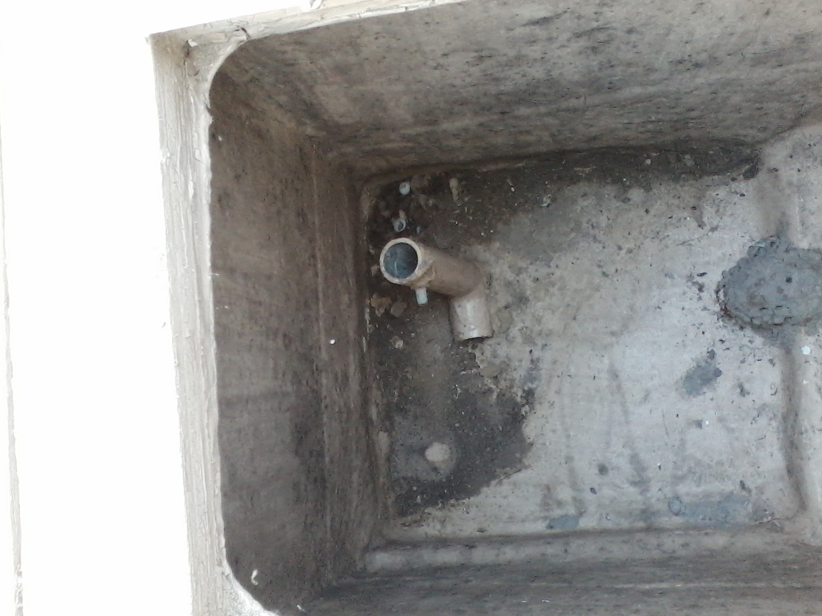

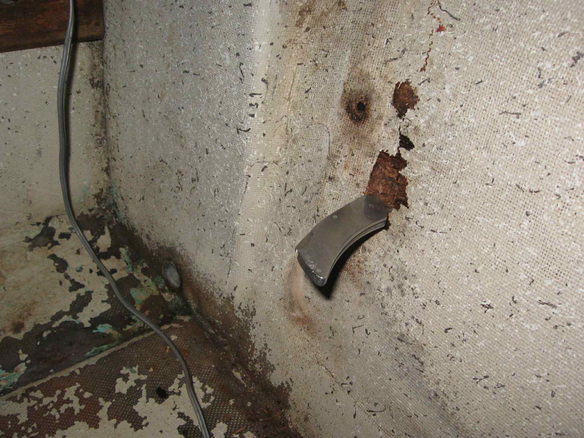

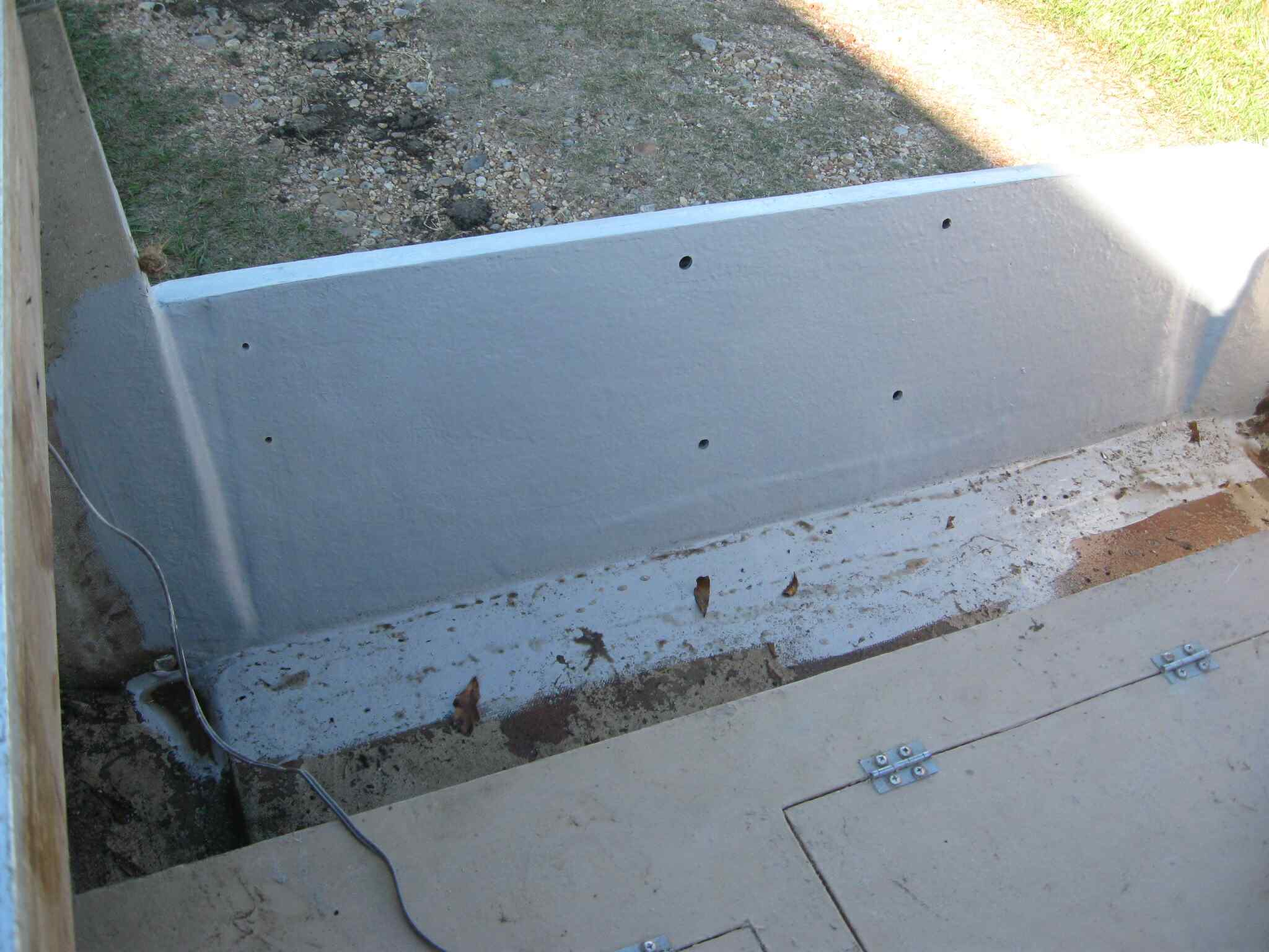

Well, I took the tub out and had a look at the transom. At first I was happy with what I saw, then I start poking around and Oh-no! My knife went all the way through like butter. Not wanting to do that job, I found a guy close by that talked me into using composite. It turned out "Real Nice!" to quote Randy Quaid in Christmas Vacation. Also got a couple good shots of the original splatter finish.
Next up is to replace the rub rail with the black that I got. I'll post pics of that when I get it doe.

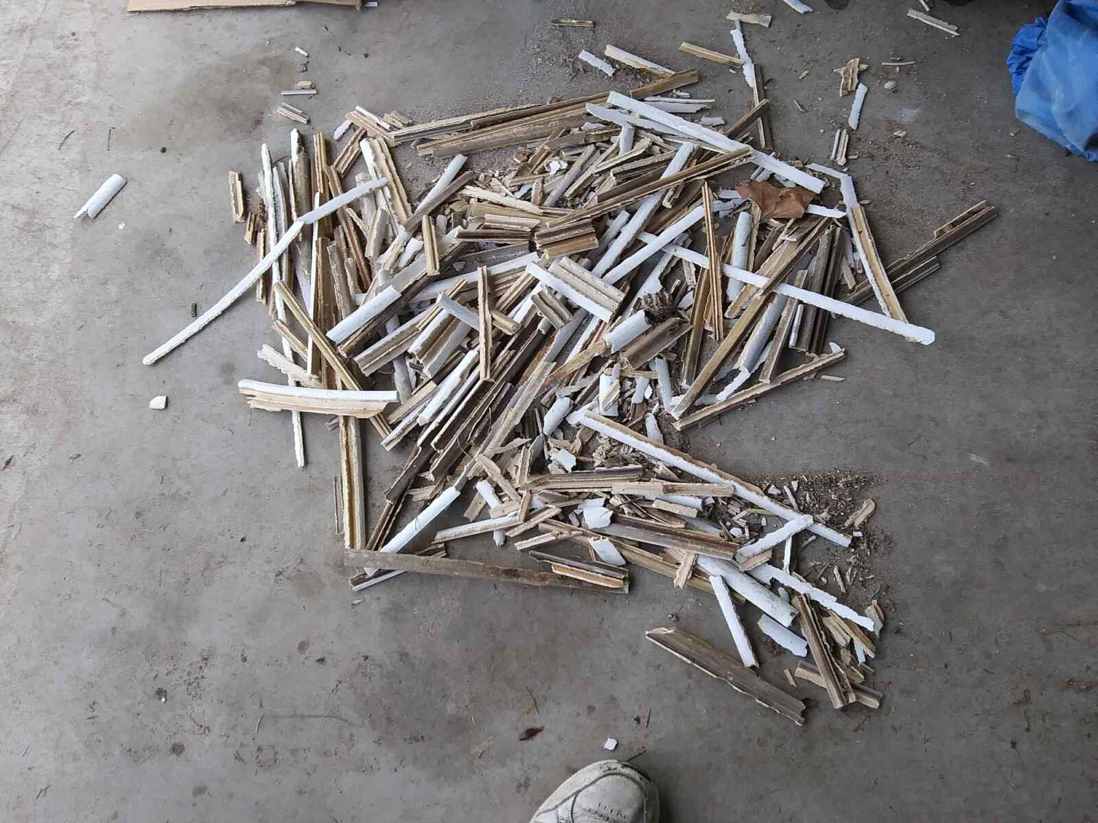

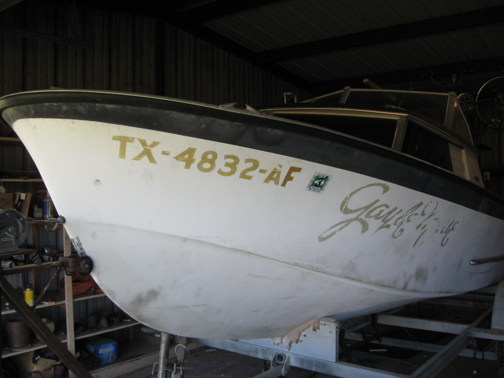

Well, this what a Seafair looks like with black rubrail. The old stuff just crumbled off. Comments?
My Granddad's 1959 SeaFair 4 years 9 months ago #145880
Hey Scott....I'm so jealous of your nice straight transom. Mine....not so much.
As for the rubrail, I really think you've just solidified my crusade to secure a manufacturer to cut dies for the main rubber extrusions and run them in white. Not saying it looks bad...to most laypersons who don't know about Glasspar they'll likely assume they all look like that and came from the factory that way. But being so used to seeing white, personally I need white. Even if it costs an arm and a leg.
Glad to see you are making some headway! Hope to have the boat on the water next summer?
-Eric
My Granddad's 1959 SeaFair 4 years 9 months ago #145886
I have some rub rail left over if you need a sample. It fits perfectly. If you get someone to make anything in white, let me know. Maybe we can get a couple of folks together and get a decent sized order.
My Granddad's 1959 SeaFair 4 years 9 months ago #145891
I did manage to get a small piece of rubrail from another member (white, no less!) that is in perfect shape, so thanks anyway. What I would need is someone who has leftover for the windows and for the forward hatch seal.
And I would like to try to get a group buy in, not to make profit but to help defray the cost of tooling. I will certainly let you know.
