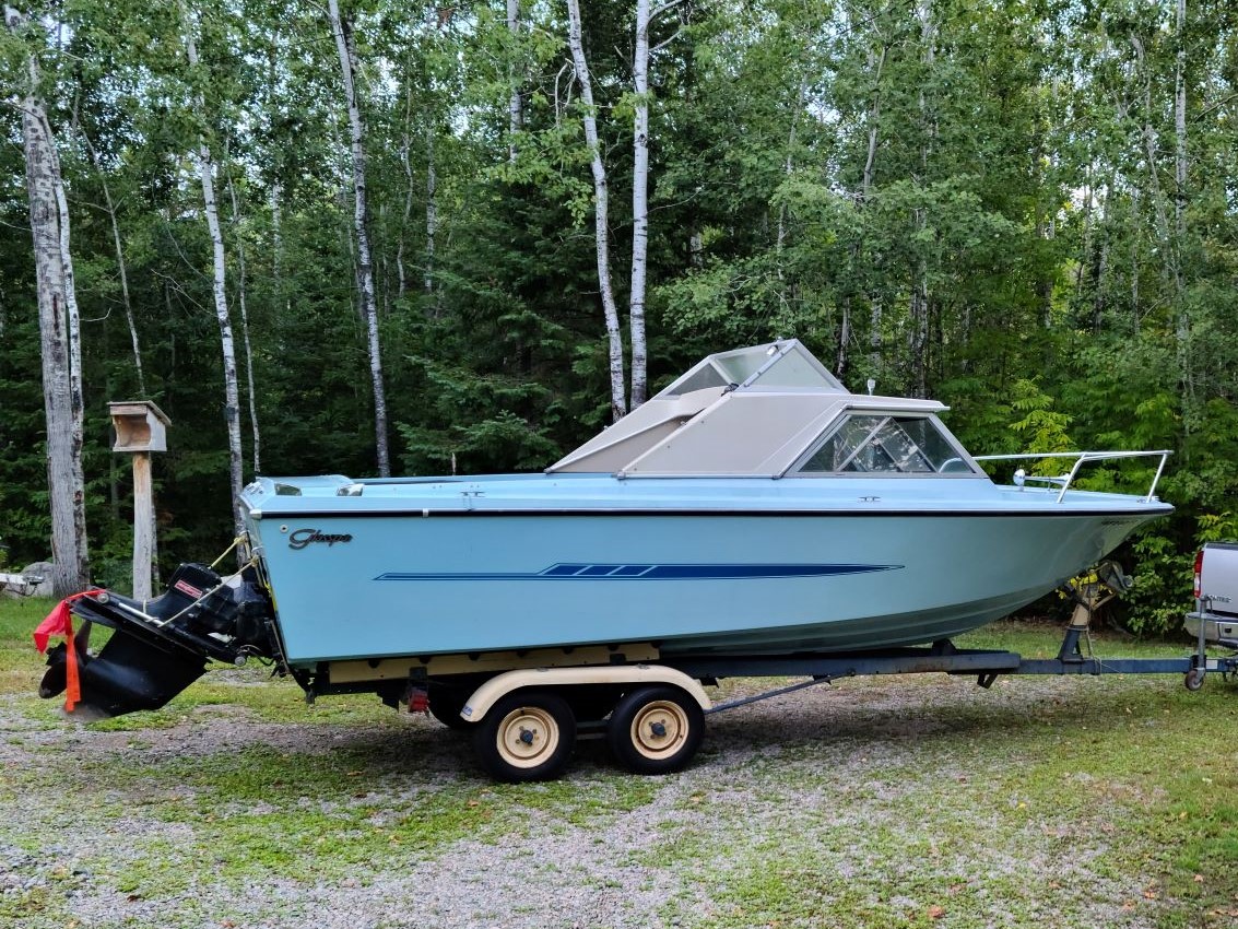

New to the site. Please meet my new to me 1971 Glasspar Newport Cruiser.
I realize it's a Larson product and not loved as much as the pre 1968 Glasspars. Still, I've not found another one like it and I'm smitten. I promise to stick to the 70's site in the future.
File Attachment:
File Name:
File Size: 0 KB
File Attachment:
File Name:
File Size: 0 KB
I made a down payment on the boat back in early May but was not able to close the deal until Labor Day weekend as it was in Canada and the border has been closed.
Back story: The boat is a survivor, apparently spending the majority of its life on Lake of the Woods in Canada. It was apparently pampered, staying in a boat house when not in use during the short boat season and in a garage during the cold months. The gentlemen I bought it from, (has become a friend over the last 6 months) has owned it since 2018. He suffered an engine failure in 2019, lost interest and left it outside. So, it now needs some help, but it's all there.
Details: Built in Minnesota, it's 20 ft long, and is powered by a Mercruiser 215E, with twin 18 gallon Tempo saddle style tanks. Engine is Ford 302 (351 heads stock) and the outdrive (looks massive) turns a 19 inch prop at a 2:1 ratio and appears to be a predecessor of the Bravo series drives. The engine failure turned out to be a dropped exhaust valve (stem broke) in cylinder #4 which destroyed the piston. It appears the cylinder and head seemed to survive pretty well. Machine shop will confirm.

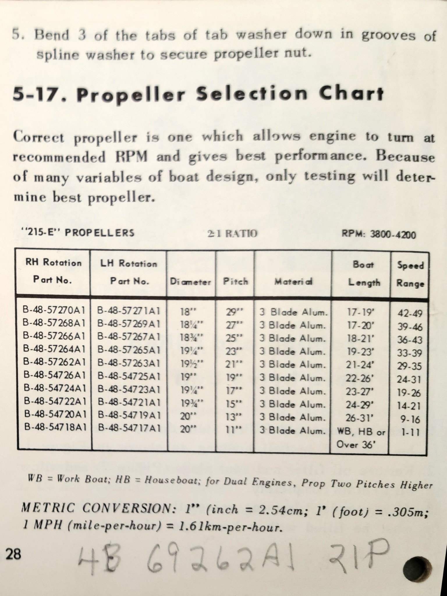

The prop that came with the boat, is 19 1/2 x 21. According to Mercruiser 215E owners manual, based on length and weight of boat, I should be running 18 1/4 x 27 or 18 3/4 x 25. Apparently Bravo 2 props will fit the 215E drive, but the most aggressive available appears to be a 17 1/4 x 25.
Regardless, want to run something that will properly govern top end engine rpm. Finding the 'best' prop may be very challenging.

The largest Mercruiser #1 drive was the 188 302 in 1971. So maybe the 215E was special order. I don't see any reason to need a high torque drive that size to push a 20' boat on plane. Truthfully, between the extra drag and any increase in weight, top speed increase wouldn't be much. I'm sure there was a big jump in dollars too. The Bravo 2 props do fit but I am not sure about the thrust hub, you may need to swap it out. Have you prices a B2 prop? Ouch......
Regarding props, most likely the 20" diameter (max for that drive) were not cupped props in 1971. I know the 16" diameter series were not. So you can expect to drop down one pitch size (2") to achieve the RPM the old charts spec out. I'd expect you to run about 40 MPH when all done.

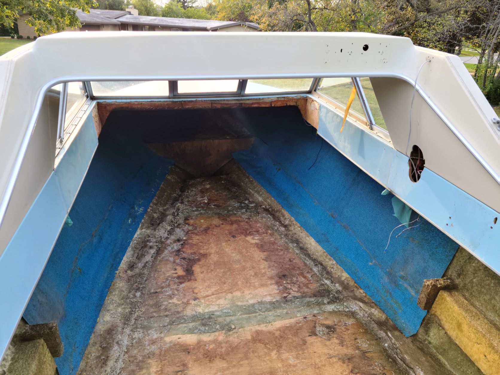

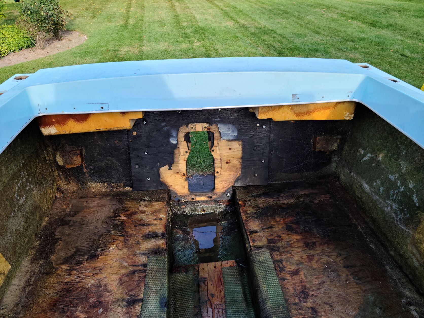

I have nearly completed stripping the boat with the intention to deliver it to a local boat/gel coat repair guy. He'll help me reverse a few aftermarket modifications punched throught the bow and transom, along with healing of the bumps and bruises experienced over the last 50 years. The floor, bilge and transom look to be in excellent shape, so thankful for that.
I'll start a build thread and provide pictures of what I have after removing everything.
Some of the resin applied to the plywood flooring have cracked and flaked off, so will be seeking advice on that and a host of other subjects.
jimandros - update on props. I have been able to find originals on ebay and a prop specialist sites. Was shocked to find an OEM in the box 27 pitch prop collecting dust in Michigan for $150 plus tax/shipping. The internet is an amazing tool!!

I don't know if you can turn a 27P, I have my doubts. But the price is right.

Sorry way late to this, welcome aboard, obviously. You have been busy and making good progress. I'm with Jim on the 27P prop but you may be able too with that 215 running in top shape. Maybe a tweak on it. I have to say I don't know the area but a depth finder is always good to have. I even bought one for my 18' Wagemaker Clipper since I used to run her in back waters up in Maryland.

Thanks for the advice on props, I recognize you have far more experience than I do. I'm trying to acquire 21 - 27 pitch props (have 21, 23 and 27) to test with. I'll resell the unuseable. The method to my madness is driven by this table in the original Mercruiser 215E owners manual which came with the boat.
If I understand correctly, 50 year old props do not grip the water as well as modern technology.
1971 Glasspar Newport Cruiser 5 years 1 week ago #145496
WOW it even shows a 29P! Yeah give it a shot.
