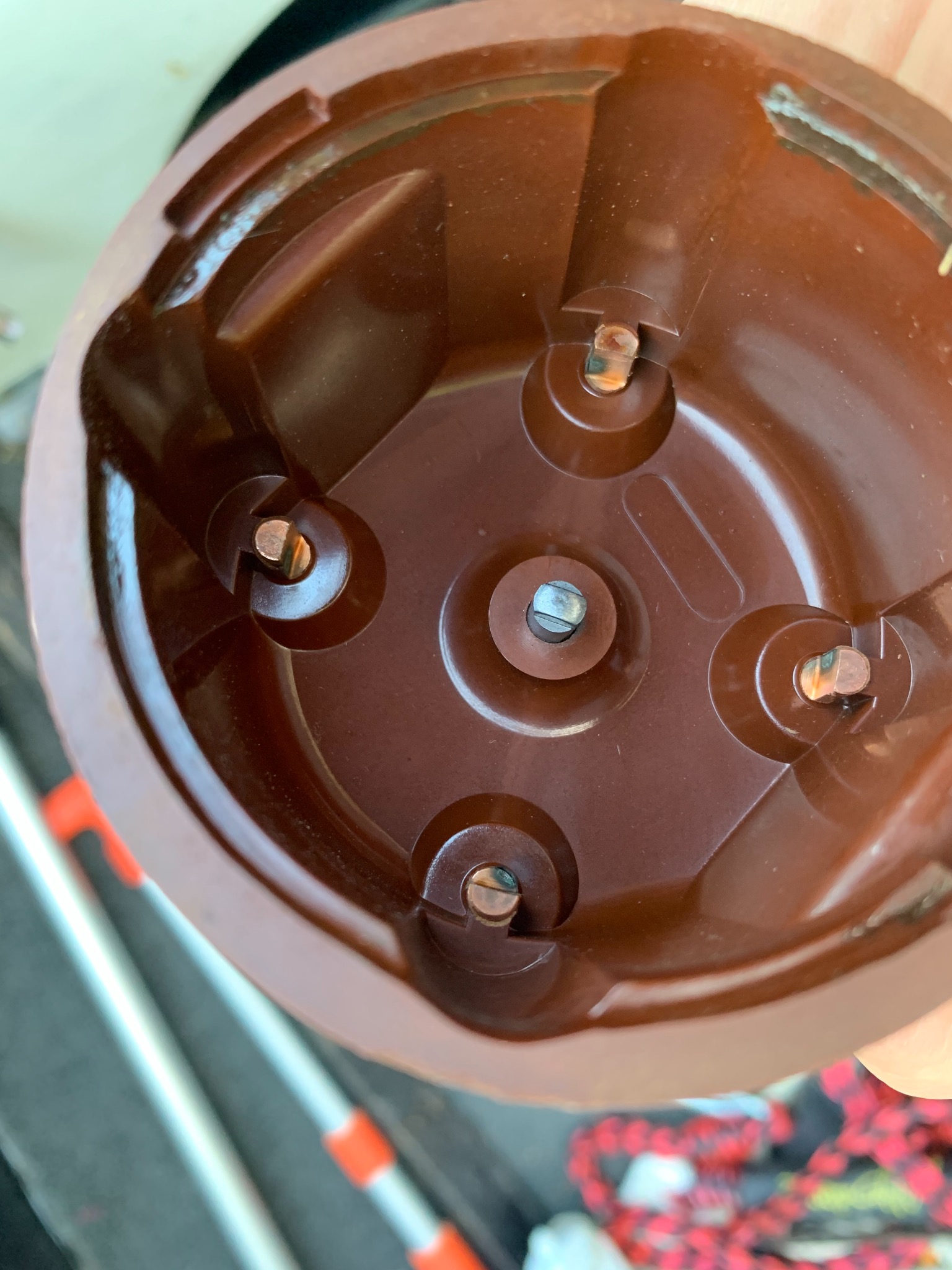

I checked for spark and am not getting anything. So could the distributor be bad? All the contacts in the distributor cap have burn marks. I traded the cap out for a new one and traddd out the rotor but still no spark

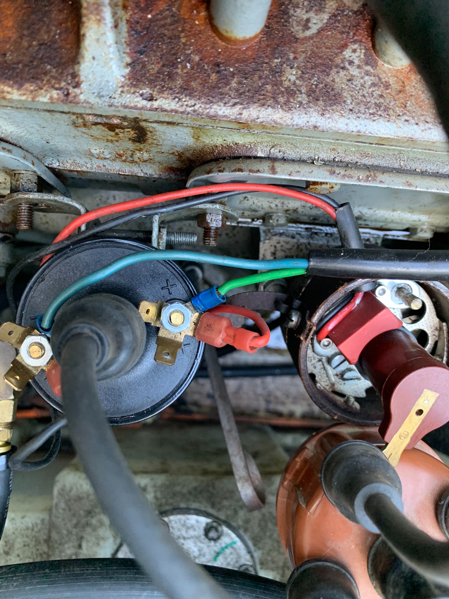

Engine failure...I'm stumped! 5 years 5 days ago #145502
I’m wondering if the electric ignition is the problem. Motor turns over fine, but no spark. I replaced the points with electric ignition when I restored it 7 years ago
Dreams do become reality!

Engine failure...I'm stumped! 5 years 5 days ago #145507
I reread your post. This is the 1st time I see where you had installed an electronic ignition. Are we talking Petrolux? I don't like them, I still run points/condenser.
Regarding the timing, if it somehow changed you would still have spark, just at the wrong time.
It sounds to me as if you are a bit mystified by a distributor. Find an old timer that grew up with conventional ignition (automotive is OK, doesn't need to be marine) & you'll have spark soon.
Engine failure...I'm stumped! 4 years 11 months ago #145571
Pull the tach wire off the negative side of the coil, I have a tach go bad internally for what ever reason and it grounds out the coil. No sparky sparky. Pertronix are good have used them for 30 years.
