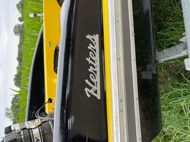

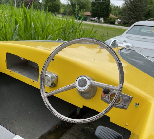

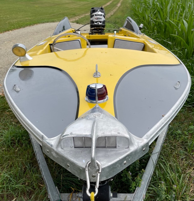

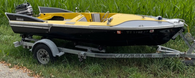

Hello Everyone,
I'm new to the site and now an owner of this 57 Herters Flying Fish project.
I'm sure I can get carried away with this restoration (I hope not haha! ) but, I would appreciate any suggestions, tips, and overall suggestions from you guys.
Here are some pictures, she isn't perfect but, I think it's a good start.
Sadly she is missing the glovebox lid and the cigarette/lighter holder :( hopefully ill find them one day.
Thank you all!
Andrey
P.S. I'm not sure if the images are showing, let me know if they aren't. Thanks

First, is it possible to find someone here, or if someone knows other places to get the glovebox lid from Herters?
Maybe someone makes replicas?

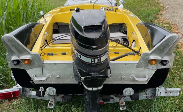

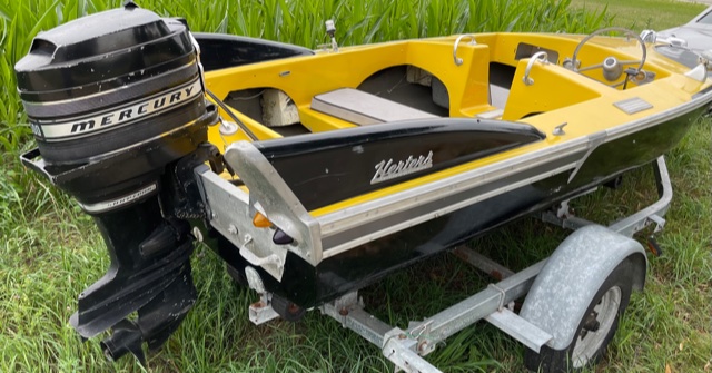

Another question is regarding an engine.
I have a 50 HP Merc on it now and I have no clue about the year of it. I was going to rebuild this one just because it was sitting for a very long time. However, I've noticed that it's a pull start only and I would love to have an electric start.
So I went on a hunt for a starter and other parts for this motor to convert it and ended up picking up another 50 HP Merc of that era +/- but with an electric start in it.
The problem is that this other motor doesn't have the bottom end and so I thought to swap them.
I have both serial numbers from the engines but Mercury isn't much of help because they don't know much about the old engines. They can't even tell me if two are compatible with one another.
Based on my visual inspection both engines look identical, one is a pull start and another is an electric start.
Anyone got some knowledge or could take a look at serial numbers and tell me if it's possible?
I can take any pictures necessary of both engines if needed.
Thank you!
1957 Herters boat 5 years 1 month ago #145328
The glove box is probably going to be impossible to replace with an original, if your really lucky you might be able to sweet talk someone who has one to make you a 3D printed one. If it where me I would just make something out of a piece of mahogany, a splash of wood never looks bad on these old boats. The outboard is a 1967 if the decals are correct and haven't been changed for some reason. If you get a mercury selco manual for your motor it will have a list of serial numbers and corresponding years for them to confirm my guess. I see no reason the lower units wouldn't be interchangeable so long as they are the same shaft length. Also that would not be the correct year motor for a that boat, so I wouldn't get to hung up on trying to replicate your existing motor although it looks just fine as it is. Hope that helps.
