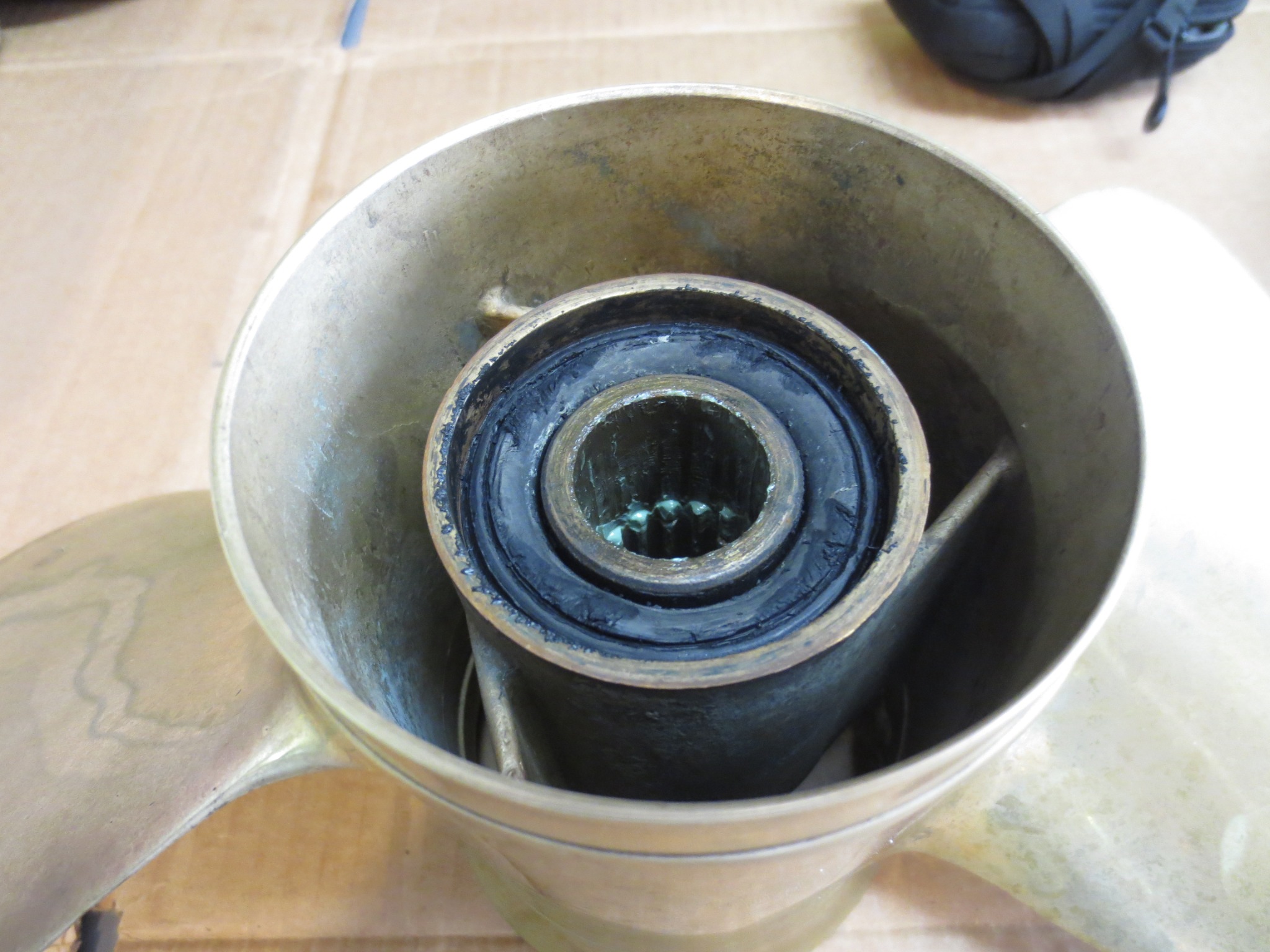

If you have a propeller repair shop in your area, they can re-hub your prop for a nominal fee. It'll be as good (or better) than new.

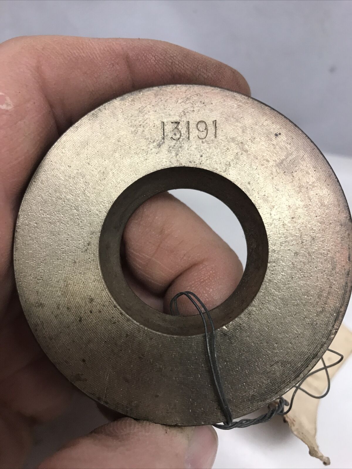

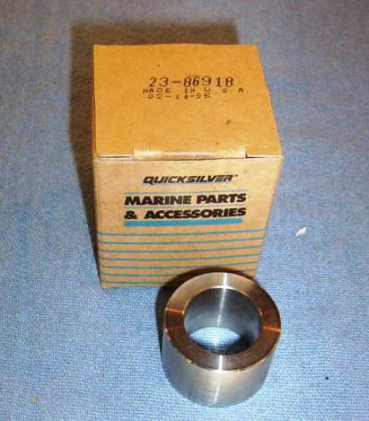

You can also adapt a "modern" prop to your classic Merc. I'm assuming your propshaft has a square shoulder where the bell-shaped propeller thrust hub rides against.
Well, if you pick up the correct spacer (P/N 23-86918), you can use the commonly-available flat thrust hub and a new-style prop. You may find that a 15"-pitch, cupped 3-blade aluminum prop gives you better acceleration than your Stone-Age 2-bladed bronze prop, while giving you a top end that's at least as good as what ya got.
There's a spacer on eBay right now for $5.99 shipped. You ain't gonna find one cheaper than that unless someone gives it to ya!
The P/N for the flat thrust hub is 75282 and you'll probably find lots of old stock for that superseded number. The current P/N is 13191K01, and IDK what's different about it from the old washer, definitely more expensive! Marineengine.com still stocks the old part as well as new. Cheap as $10.05 shipped on eBay.
One caveat, with your special water-intake trim tab, you won't be able to use a prop with a ton of rake. The swept-back prop blades could hit the trim tab/water pickup. On a later-model engine with removable trim tab, you can merely replace that with a trim tab with more set-back. There ain't any of those for your old Merc! BTW most props in the pitch range that your engine will handle, won't have a ton of rake and should fit OK.

Took it down there and they will re-hub and repair and balance the prop.

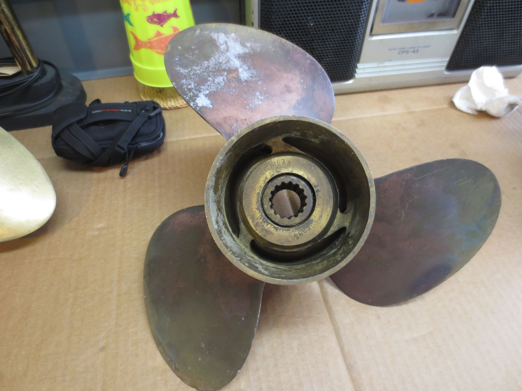

They recommended an upgrade to a modern 3 blade too and also said the thrust hub needs to be replaced.
Would you believe I actually have a Michigan 3-blade bronze SMC-893.
It crosses to the Merc 48-3146A3 and is 15 pitch. The AirMarine folks said it would be a good selection.
The original owner of Mama Mia! gave it to me and said it was the ski prop. I just never swapped them out.

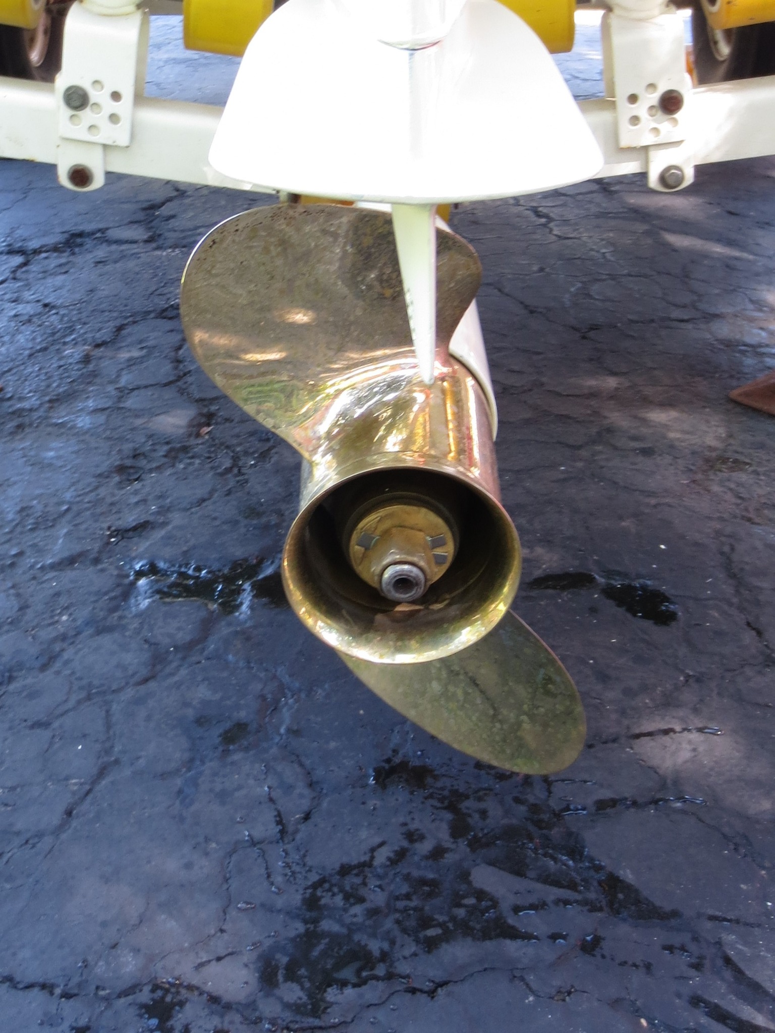

Thanks much! All good information and the folks at the prop shop say the same about using the 3 blade 15 pitch.
I was half joking and wishfully thinking about a NOS prop but that is just what I got.
It’s a 48-29658-17 although Michigan Wheel shows it as a replacement for the 48-30390-17.
AirMarine had it on the shelf and they been down there since 1940 so who knows what they have.
Gonna rehub the original and keep as a spare as the Merc owners manual suggests.
And still gonna play with that 15 pitch too next week.

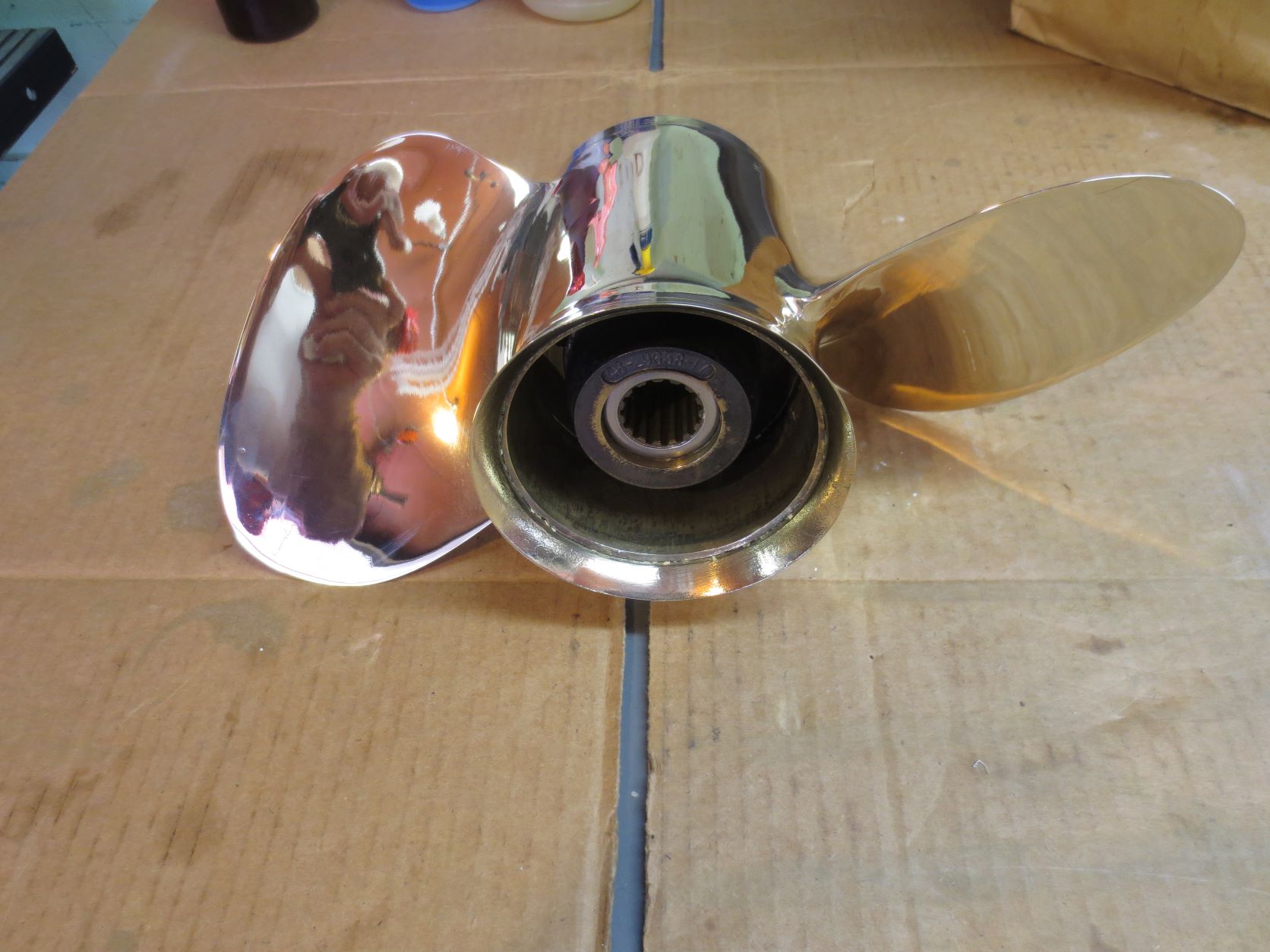

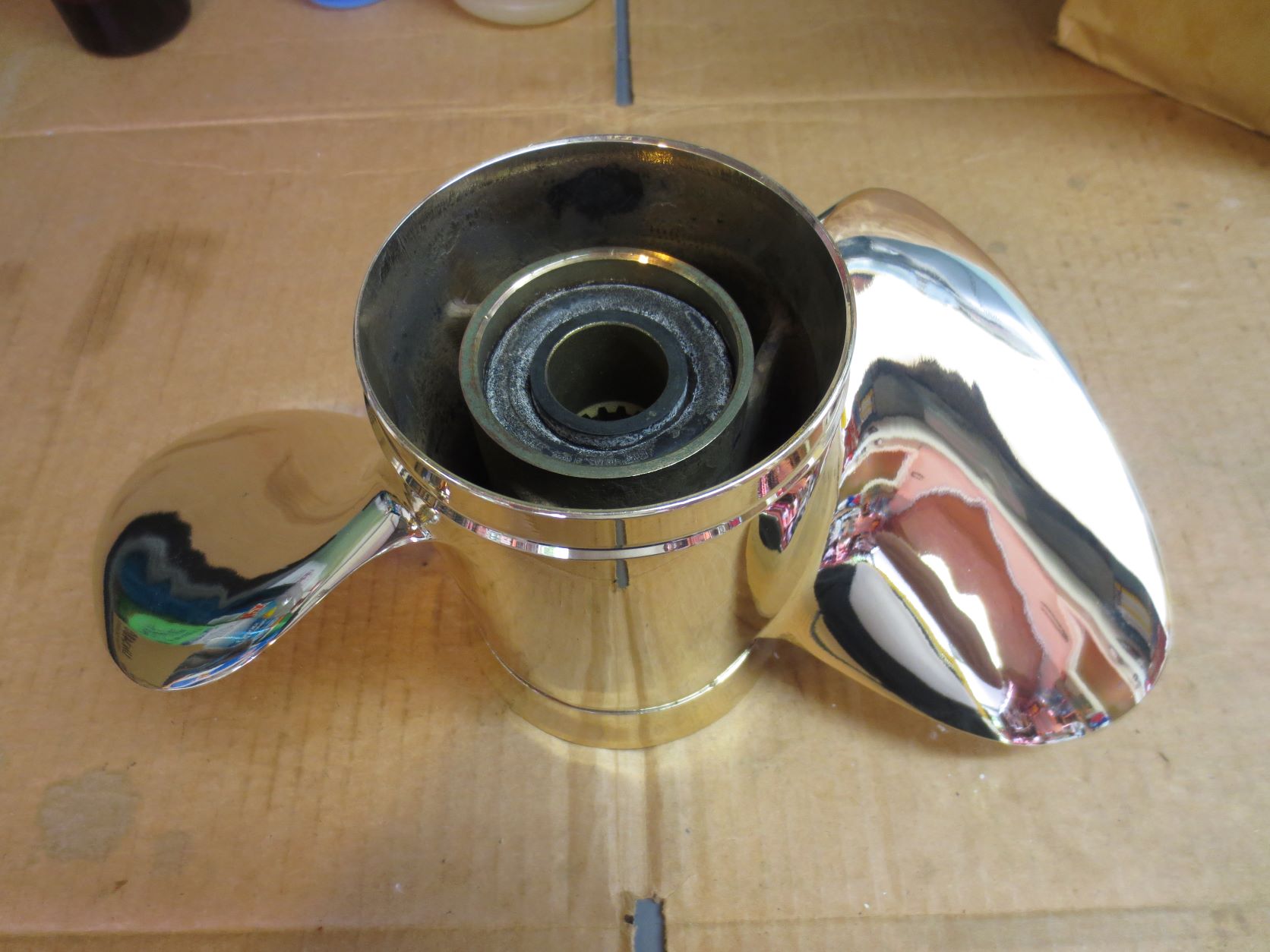

Did you buff your own prop? If so, who has the best procedures and compounds? Seems like somewhere I saw a big wheel on a bench grinder that looked originally white and a bit soft, but very gray looking like some sort of polishing compound. I have one shiny prop and my other 4 bronze need buffing and I would like the methods (secrets) to making mine shine like the ones in your pictures! Great thread of information. I need to connect my Airguide tach before next summer so I can play the prop swap game and dial it in. Props truly can make or break how any boat performs.
