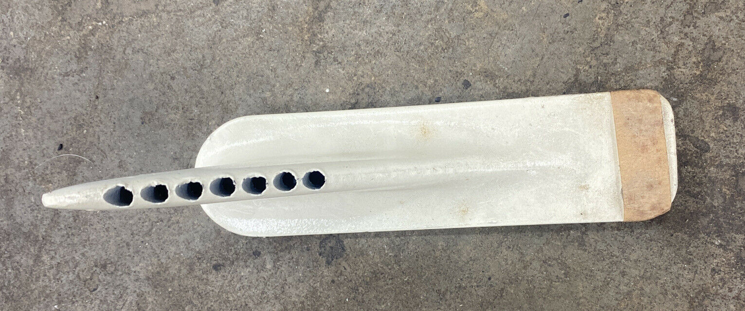

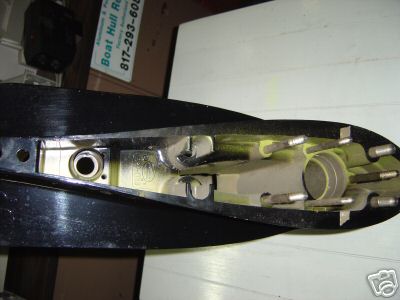

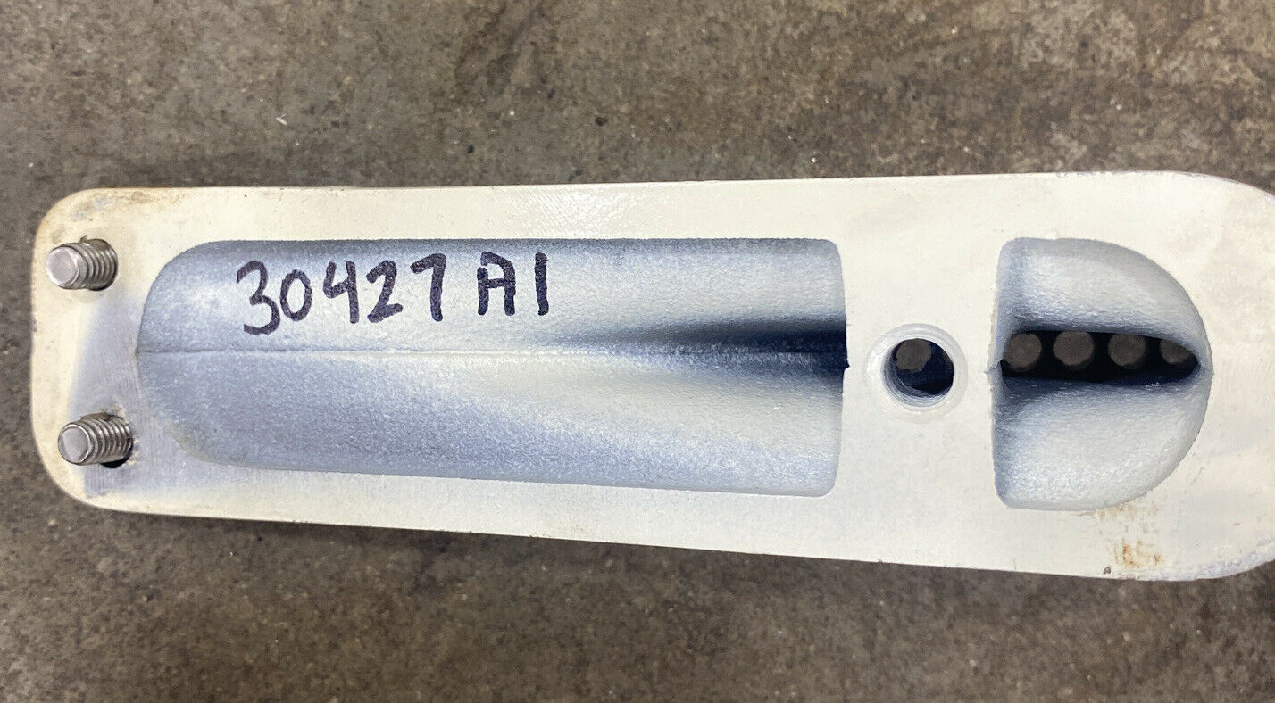

Bill, I don't have a real good pic of it, but the MK75 and MK78 don't have a "trim tab" per se, they have the exhaust "snout" that acts like a trim tab. Of course, non-adjustable.
www.marineengine.com/parts/mercury-mark-outboard-parts/mark-75a-78-78a/all/gear-housing-assembly-complete
The old D/R lower units intake water from the underside of the anti-ventilation plate, same as the non-flow-thru-hub 4-cylinders do. There should be a stainless louvered screen over the hole. On the inside, a short run of copper water tube goes to the intake side of the water pump, sealed at both ends by a rubber grommet.
See the attached pic which has a decent view of pump side of the gearcase.
Flow-Thru Exhaust D/R models 700 and 800 have a removable, non-adjustable trim tab/water intake.
Hope that helps...........ed
