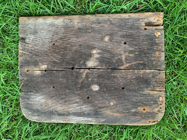

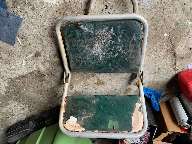

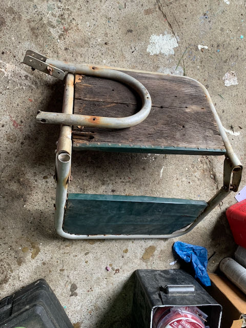

I want to have fold down seats for my Delmar project. I have (most of) one of the original seats. I want to repair/rebuild that seat and try to make another. It attaches from the side and had some kind of post that would swing down to the floor, right? That post and bracket are missing. Anyone have pictures of what that would have been?

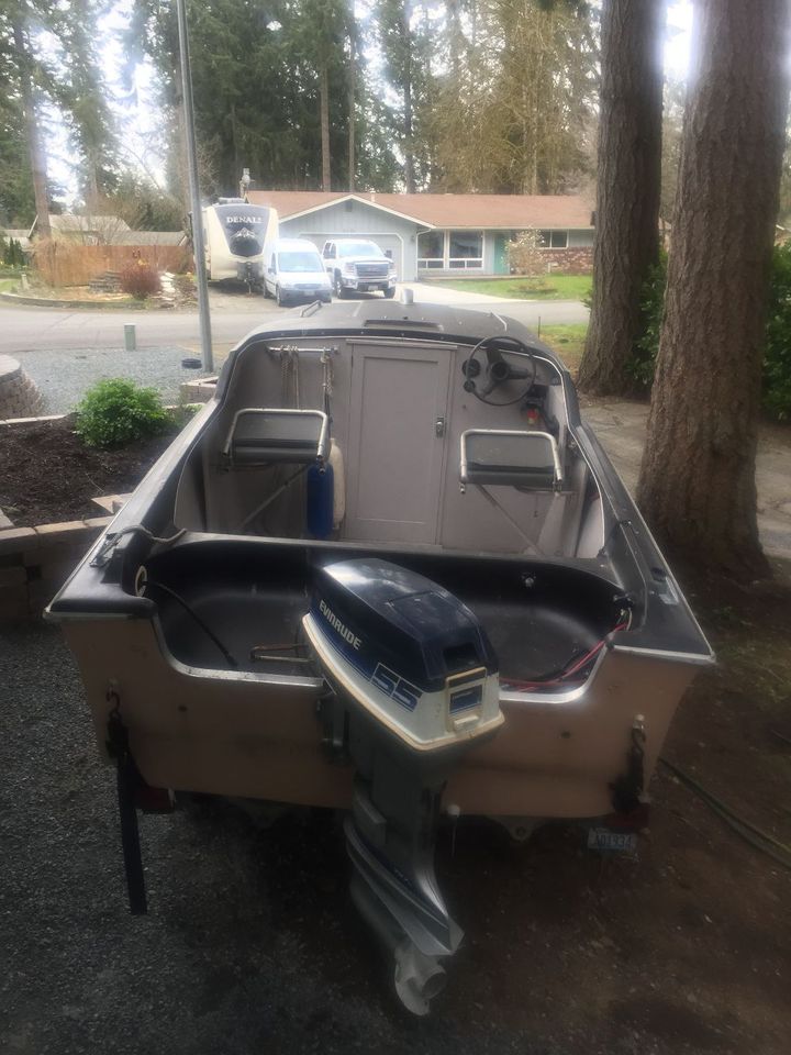

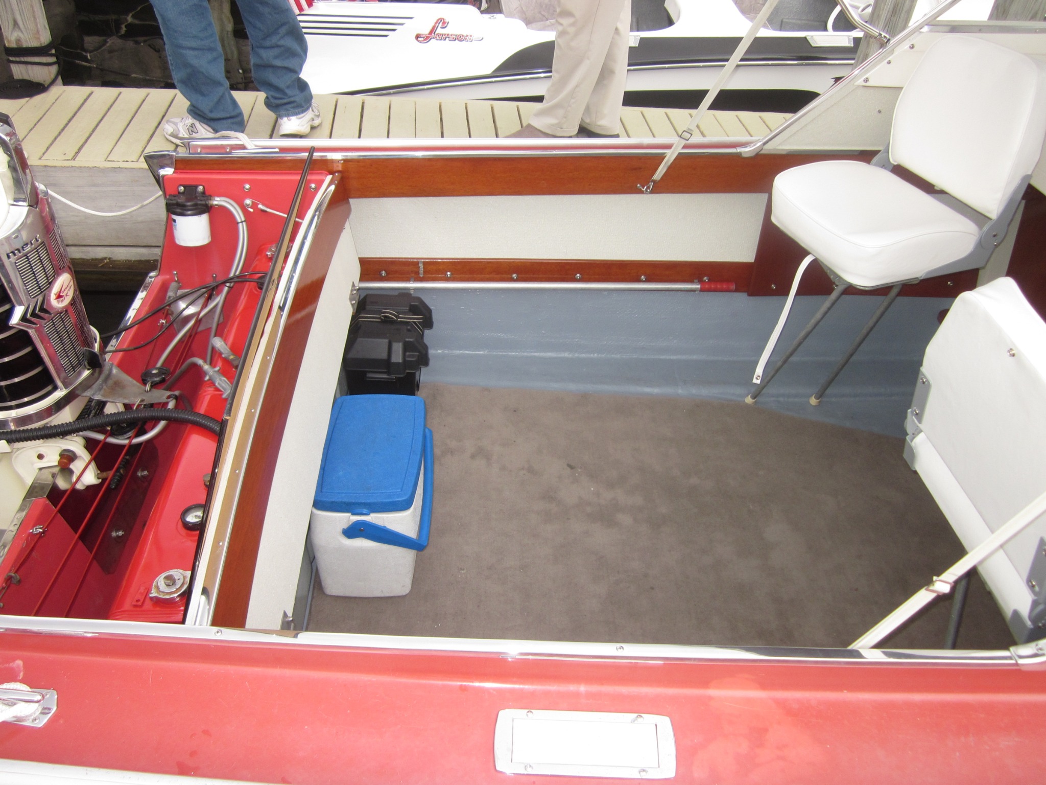

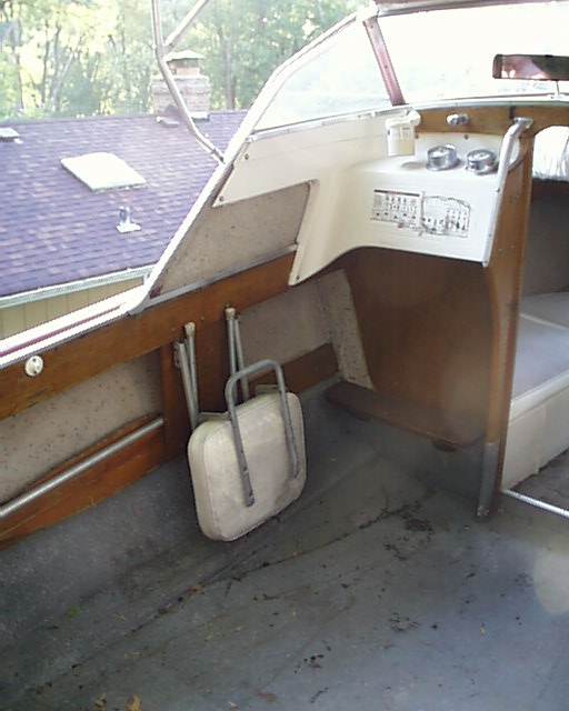

From another thread on this site. What I think I'm aiming for.
Delmar fold down seats 5 years 3 months ago #145081
I have to recreate something similar for the 1959 Thompson wooden 19 ft cabin cruiser that I am restoring.

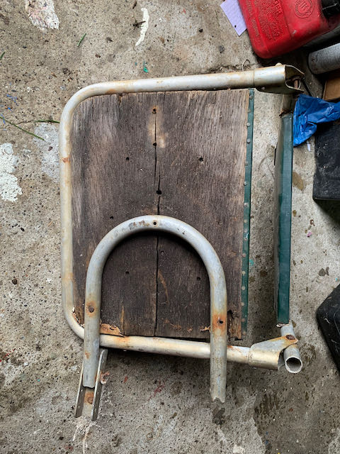

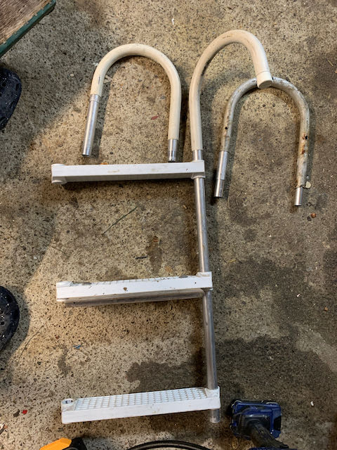

The aluminum frame is 1 inch tubing. I have several swim ladders from the many project boats I've had over the years. The "hooks" are close to the shape of the support piece under the seat.

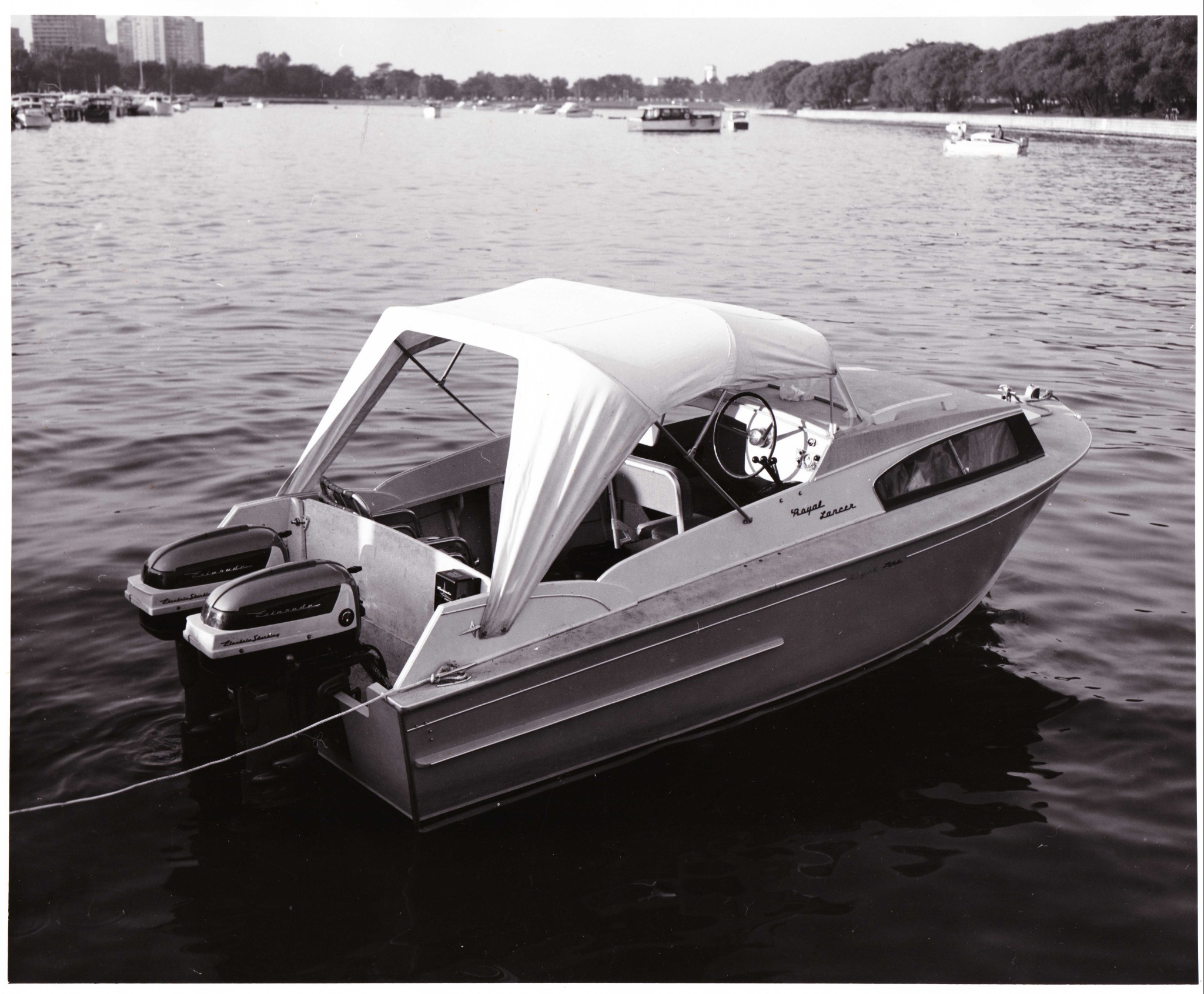

Hello David,
On your question I thought of this boat and recalled it had similar seating. Only one there but looks like what you showed on the cruiser.
Photo late 50’s in Belmont Harbor in Chicago on Lake Michigan. The small yacht directly above the Royal Lancer is the Robert Allan II which is still in use. And coincidentally that is a Delmar motoring into the harbor at top on right.
Thanks,
Terry

That's a great photo Terry !

Thanks for the photo, Terry. You have quite a boat image library! Cool that there is a Delmar in the photo. Looks like a large Merc on the transom. I'm going to try a Mark 75 on mine.

Delmar fold down seats 5 years 3 months ago #145169
Hello Davidk,

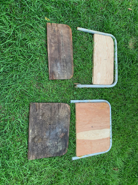

Seating on the 59 sedan was similar to what they used on the Delmar.

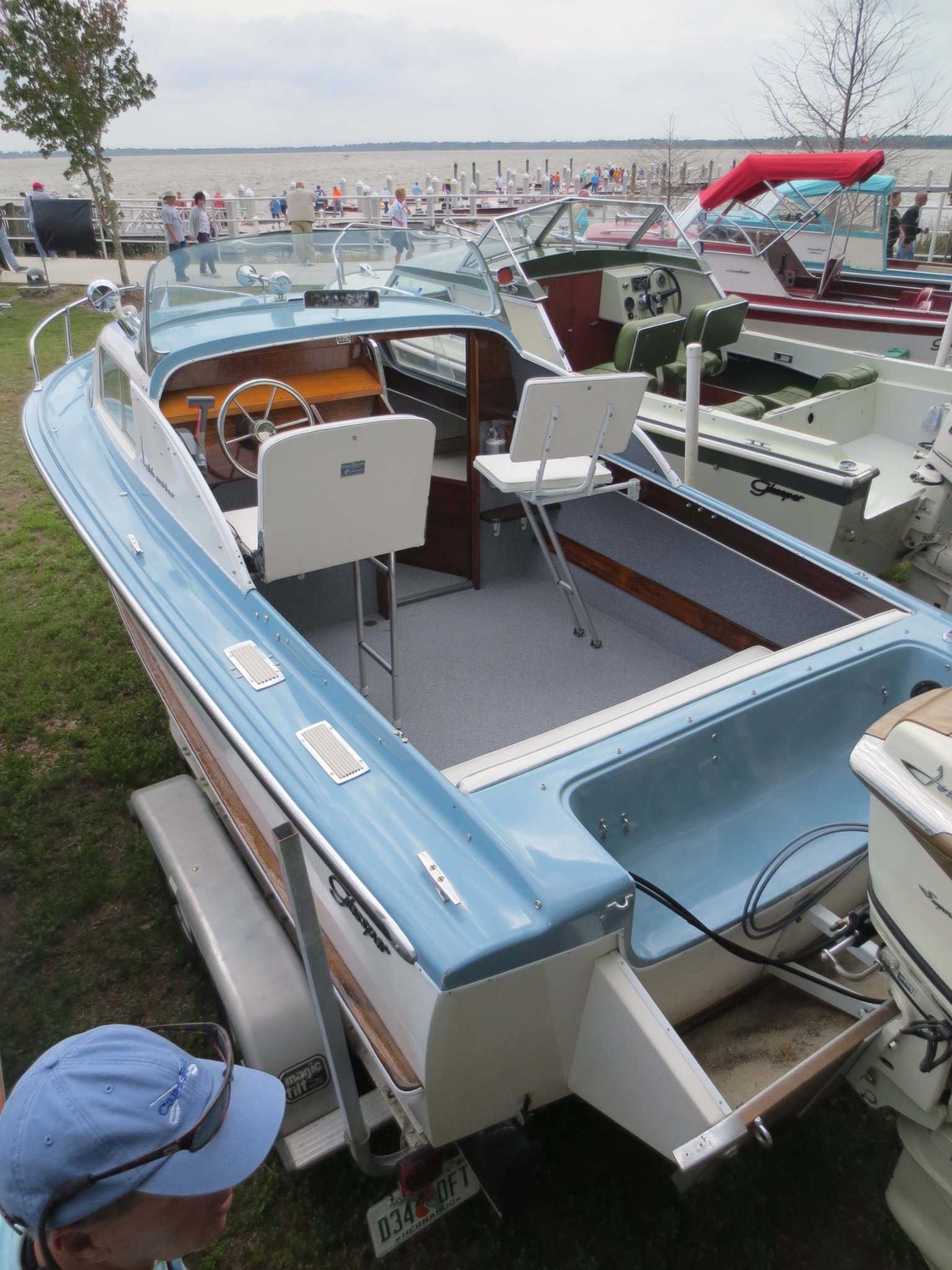

Original
Legs are not hinged. They simply fit into a slot in seat base.
Had tubing anodized and replaced the seats.
Delmar fold down seats 5 years 3 months ago #145175

Thanks Terrydi! Those photos and comments are very helpful.
Delmar fold down seats 5 years 2 months ago #145241
You're doing great work on the Delmar and glad to help.

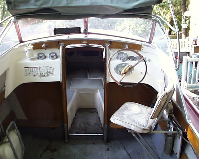

Noticed this from the picture on the Mariner ID post.
I believe the passenger seat was originally the pilot seat.
Looks like the original hardware other than the legs.
