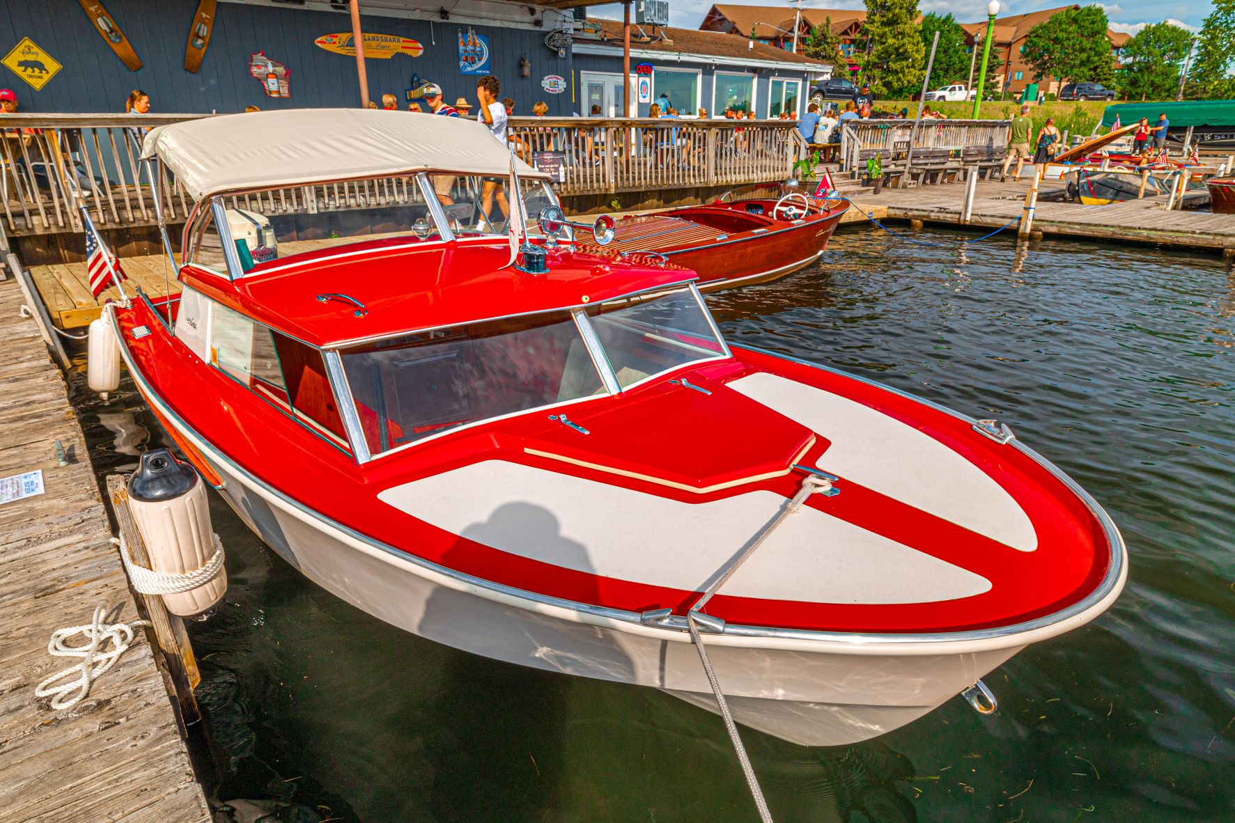

1959 Glasspar Seafair convertible top 5 years 2 months ago #145045
Hey Guys, (Eric)

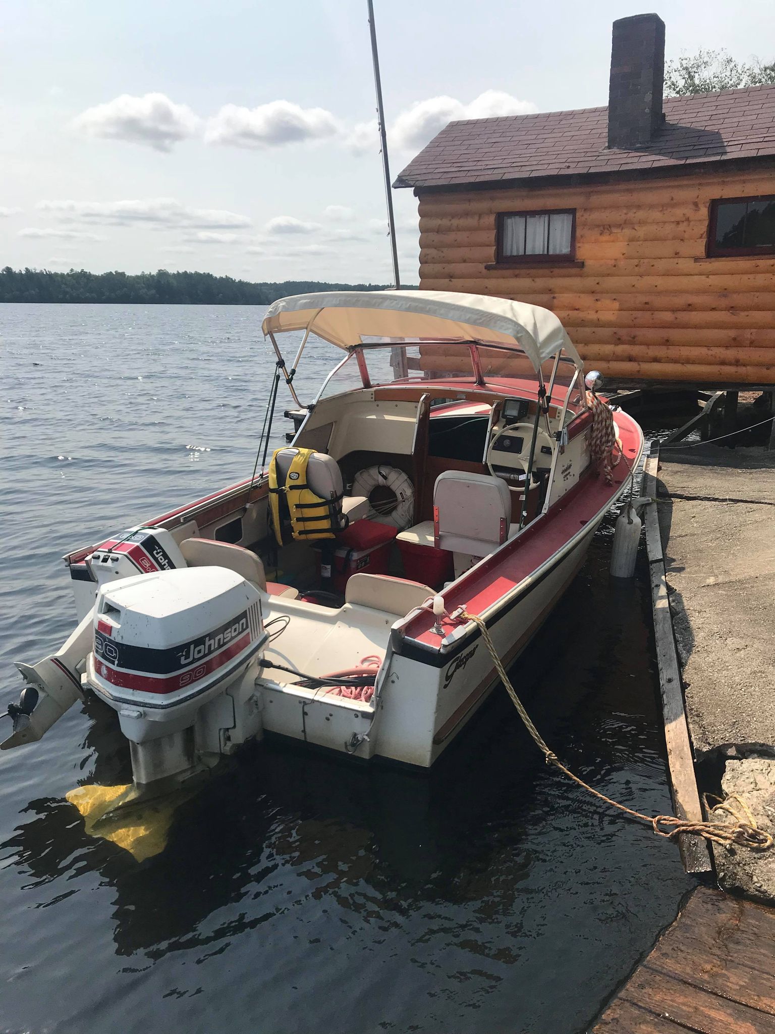

Naaty Lee posted a picture of an early Sedan with a decent aftermarket top. I'd guess its a 1960?
I’m sure the original could be replicated given proper tools and materials.

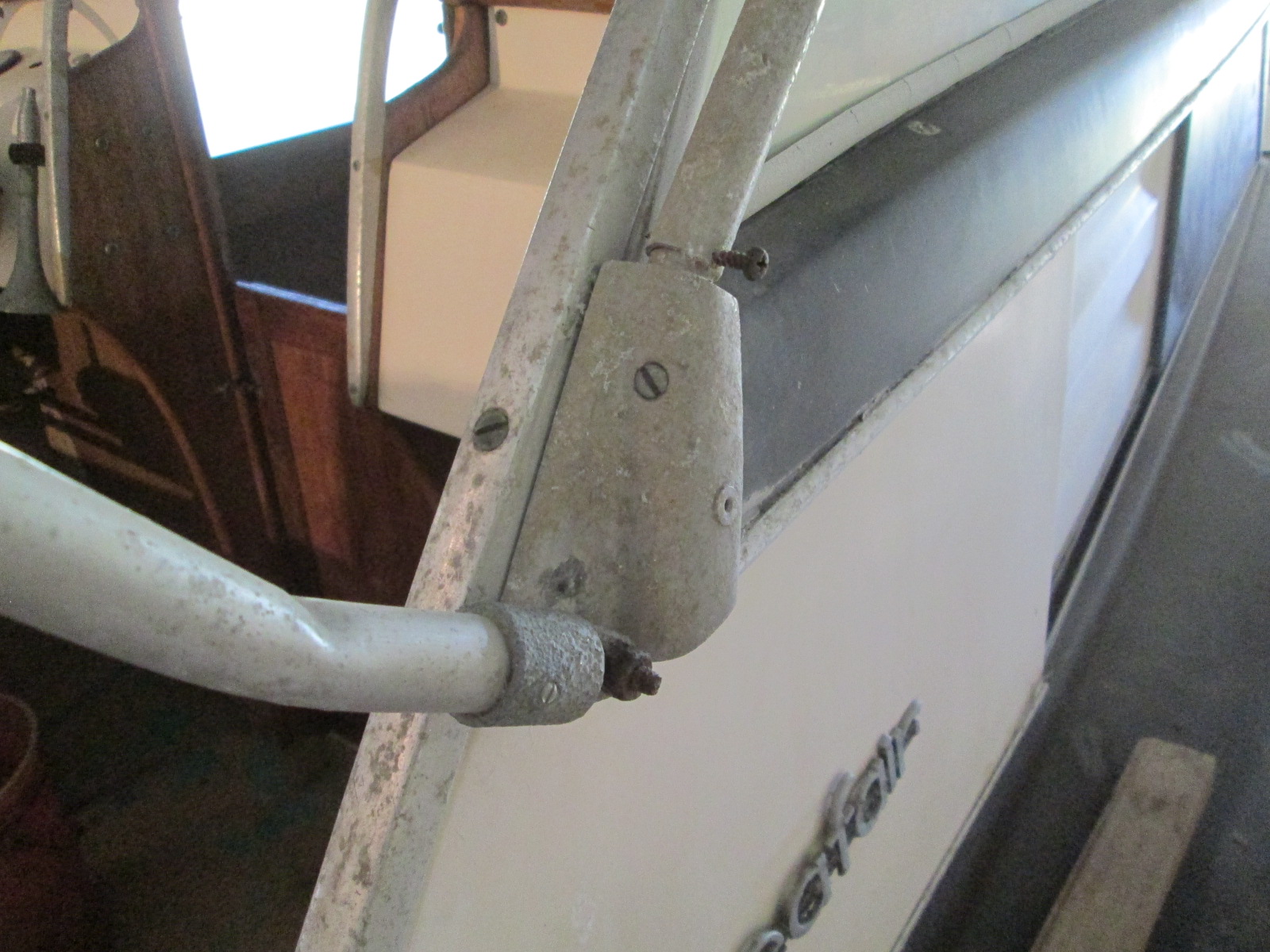

Zoom in here and you can see the how the forward tube is attached to frame using machine screws tapped into the 3 post castings. I know I have pictures of the frame assembly broke down and on the bench. I will dig them up and post later.

Natty Lee is a 1961. The top was made in Rogers Minnesota by Canvas Craft. Not sure how old it is. It fits OK but I have to redo some of the snaps on the boat for a better fit.

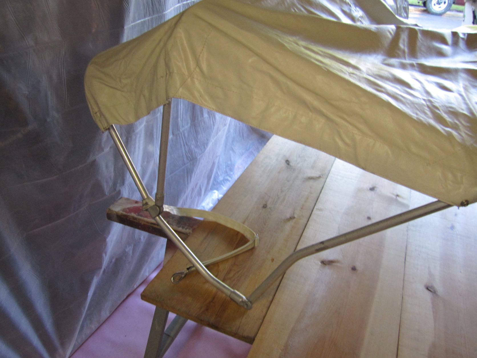

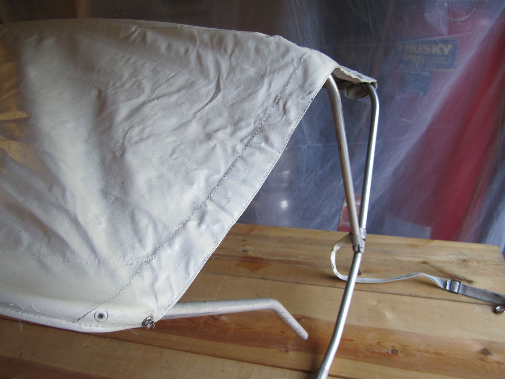

Dug up these shots of the convertible top frame on the bench.
I’ve done a fair share of bending pipe and tube and replicating this would be a challenge. But some folks like challenges so good luck. Remember you have only one chance to bend that tube correctly.
Notice the early 59 hinge casting does not have the stud tube support.

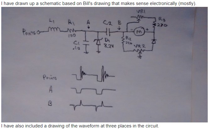

And Bills reverse engineering on the Airguide black box.

Thanks Terry, that looks fairly simple to replicate. All the end castings and joints are still available in stainless, would probably mount to the hinge castings just like factory. Speaking of, your hinge castings are strange...you've got a few bits and bobs on yours that were only on the extremely early Seafairs, like your roof grab handles (Delmar leftovers?).
Do you know what size OD your frame tubing is made from? And If I ask extra nicely, would you be able to measure the tubes this winter for distances to bends, degree of bends, etc? If you'd like a fee I'm open to that.

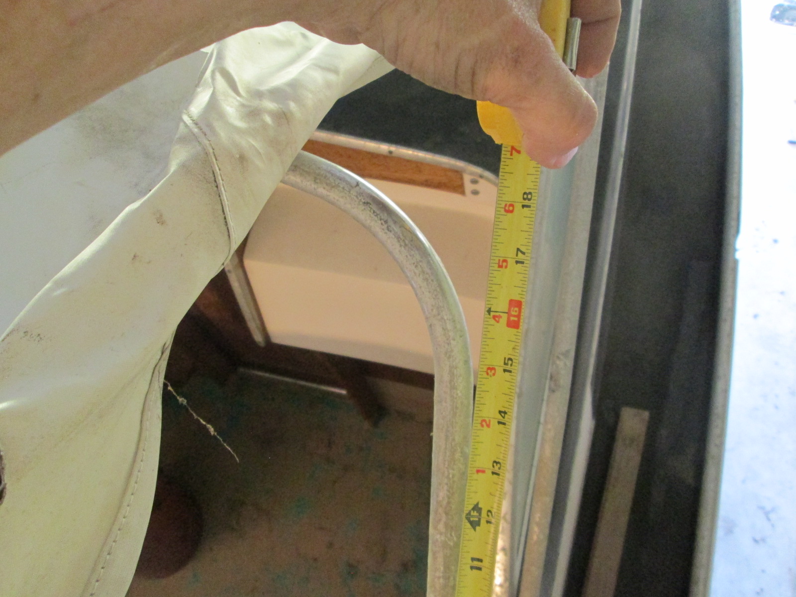

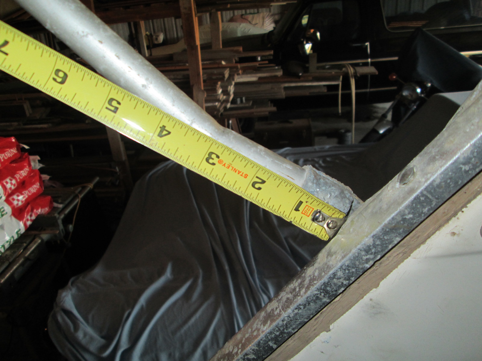

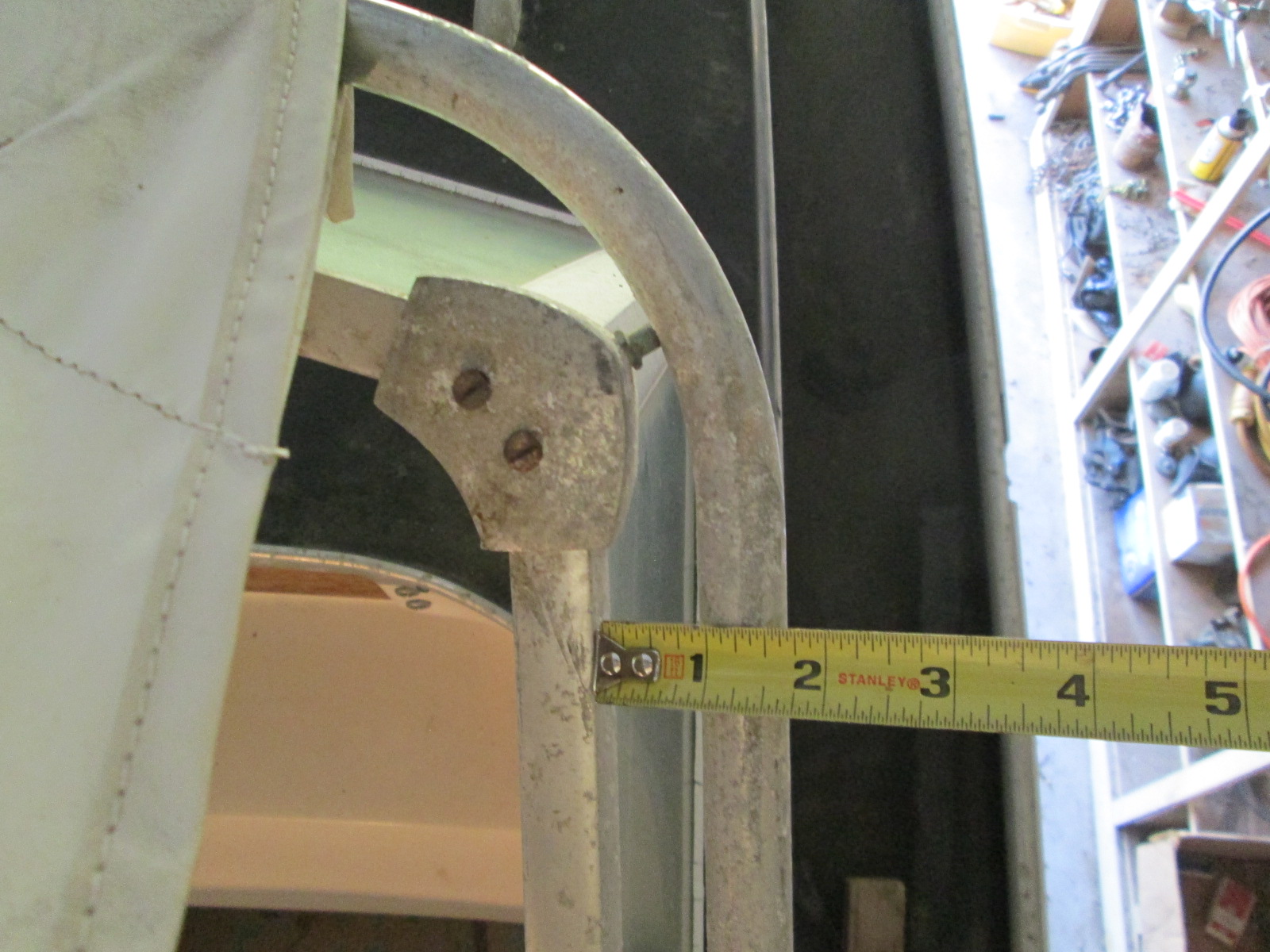

1959 Glasspar Seafair convertible top 5 years 1 week ago #145490

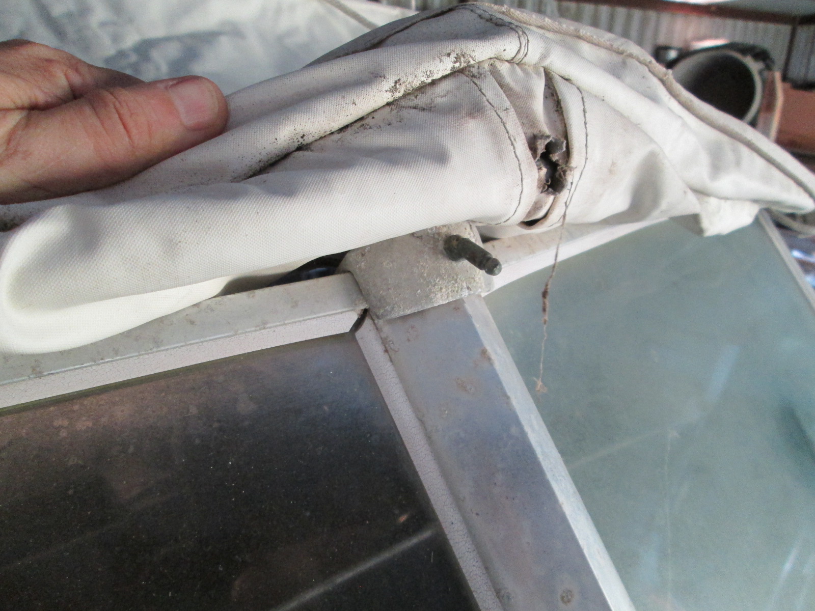

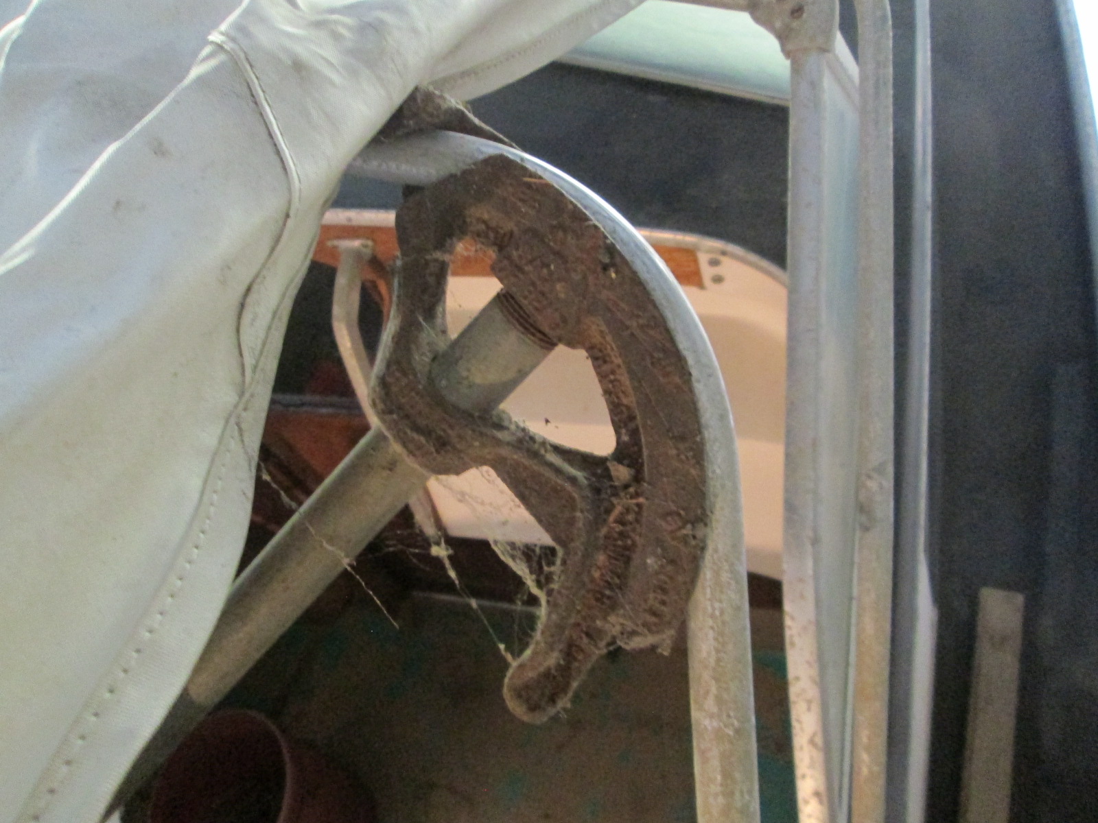

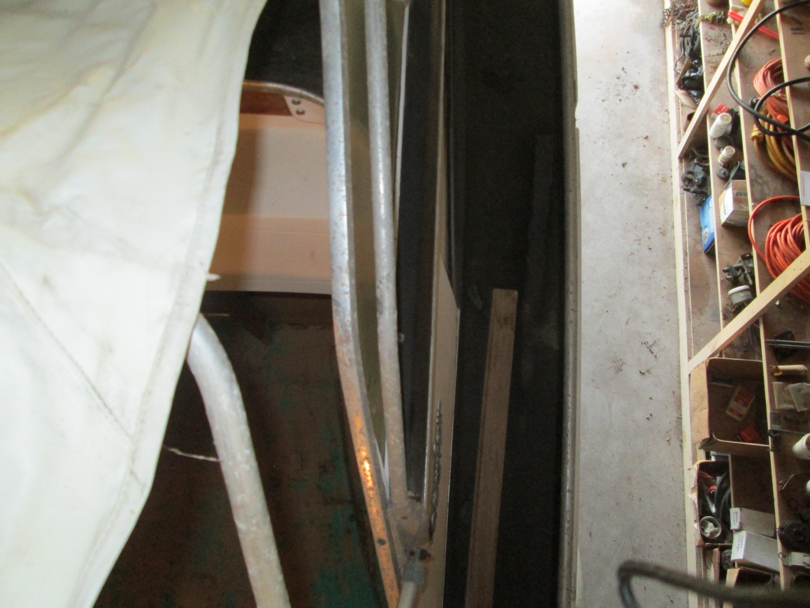

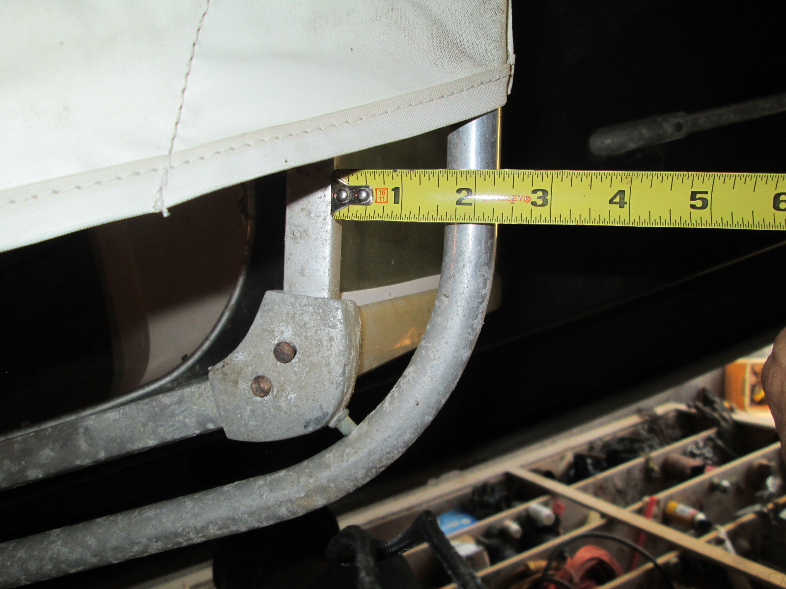

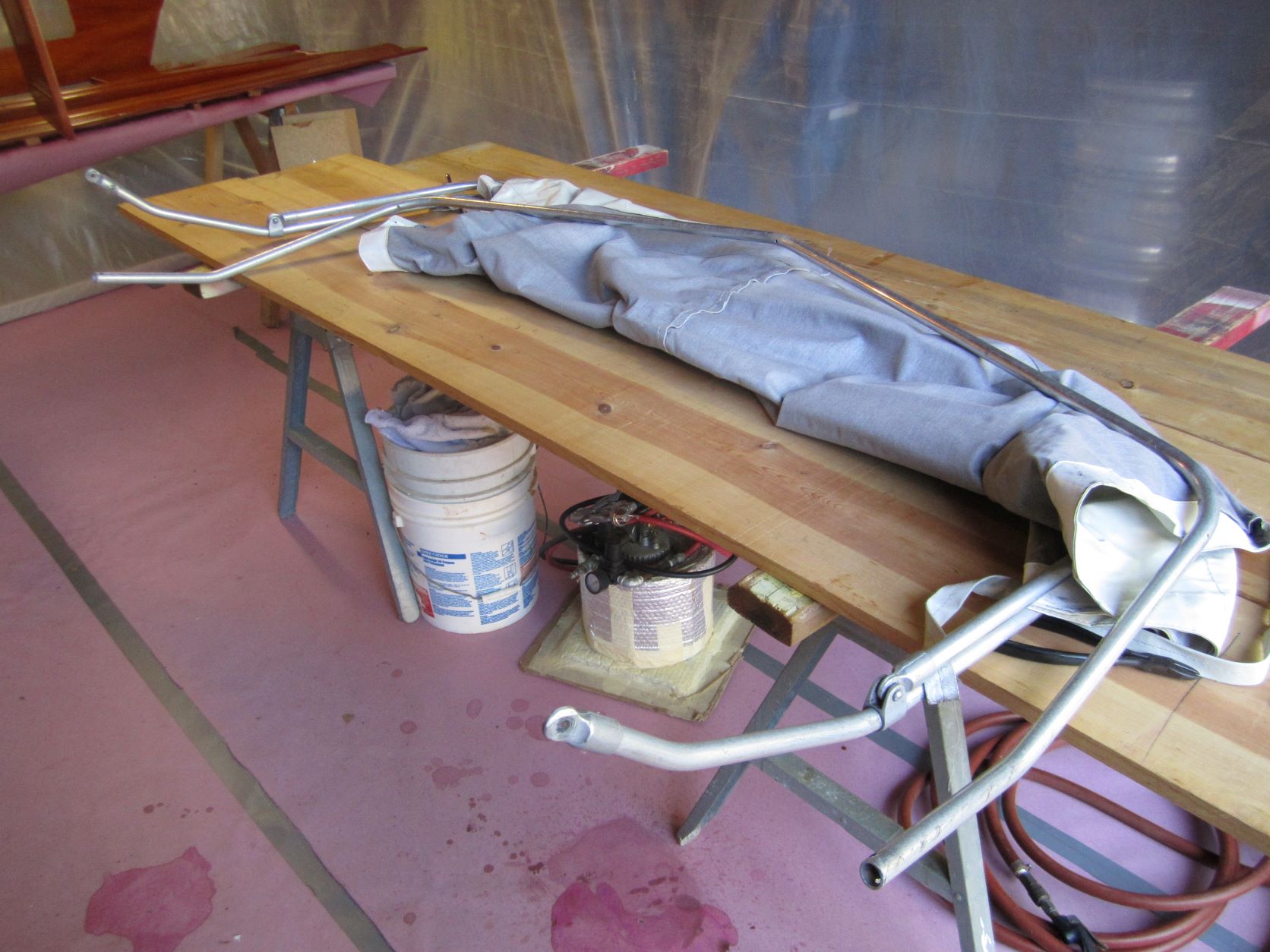

Rather than try to make drawings, I thought I would start with pictures and see that goes. All the tubing is 3/4" OD, which looks like it is available. The bow at the base of the windshield must be bent to follow the curve of the windshield with a stand off of 1" on the sides and 1 1/2 on the front. There are three connectors that look like unused rivets to connect the tubing to the windshield. My center one is broken.

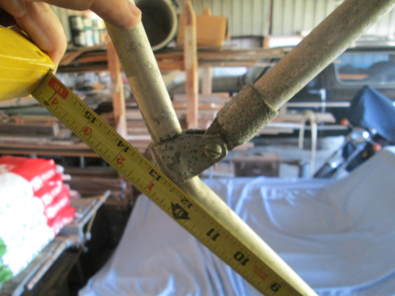

The rear bow has a 15 degree kick at 3" and another at 12". From there it goes up 14" to the start of the bend across the stern and the bend ends at about 18".
The middle bow starts its bend at 14 1/2" and ends at 18 1/2". The hardest bend will be the top of the rear and middle bow. They are not straight, they gently bow up 2 1/2" in the center. However, since this is covered by the top material, not much will show. The good news is that all of the other bends can be made with a 1/2 EMT electrical tubing bender. The radius follows it almost perfectly (see pic). If you know a commercial electrician, he could knock it out in no time. Let me know what I forgot.

1959 Glasspar Seafair convertible top 5 years 1 week ago #145492
  • eperot
  • eperot's Avatar Topic Author
  • Senior Boarder
  • Senior Boarder
  • Posts: 186
  • Thank you received: 19
Wow, thanks Scott! you really knocked it out of the park with these measurements and degrees. I really don't think it would be all that difficult to recreate the top frame with this information. Patience, for sure, but not too bad.
My center locating pin is also broken...actually not broken but missing altogether. I looked around for a while online and found some things that look pretty close but no cigar.
Terry, your top being screwed on rather than slid over these three pins must be just another example of the oddities of your extremely early production run.
The only thing I can foresee needing at some point in the future would be maybe a traced outline of the fabric itself noting the location of the tube pockets, but that can certainly wait for another day. Thanks again, so much.
