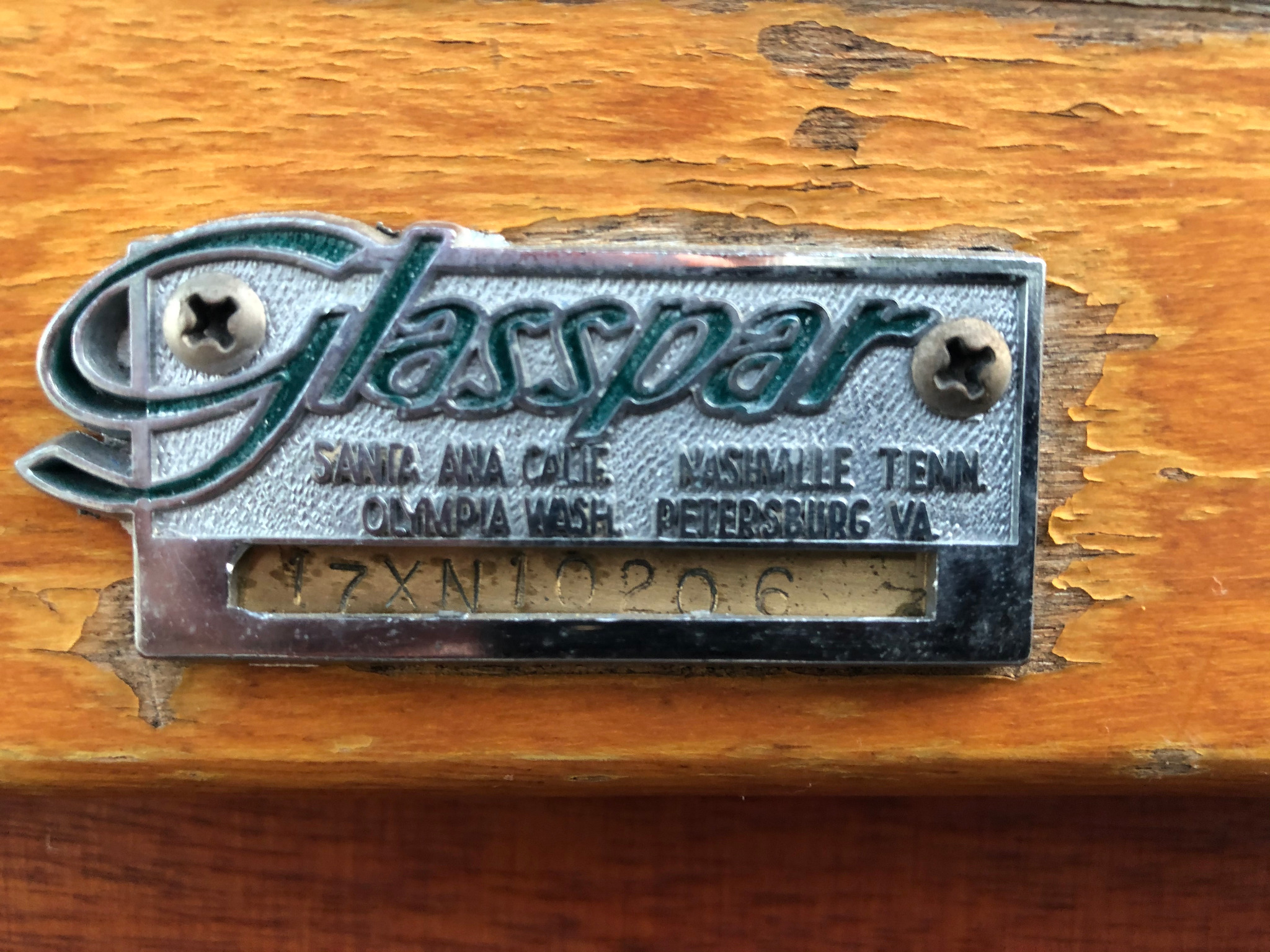

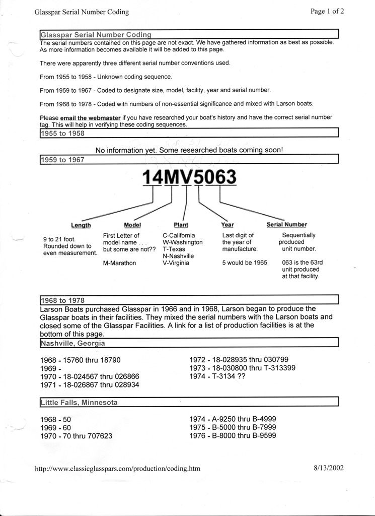

Seafair Sedan gas tank? 5 years 2 months ago #145092
I assume she was built in Nashville and is a 1961. I will share some more soon! Is there a breakdown somewhere of production numbers from the various plants. I know Santa Ana was the "mother-ship" I'd be interested to know if there is an assessment of the quality from the various plants, and how long they operated. And I'm curious did the term "Seafair" come from the Seattle event held every year?

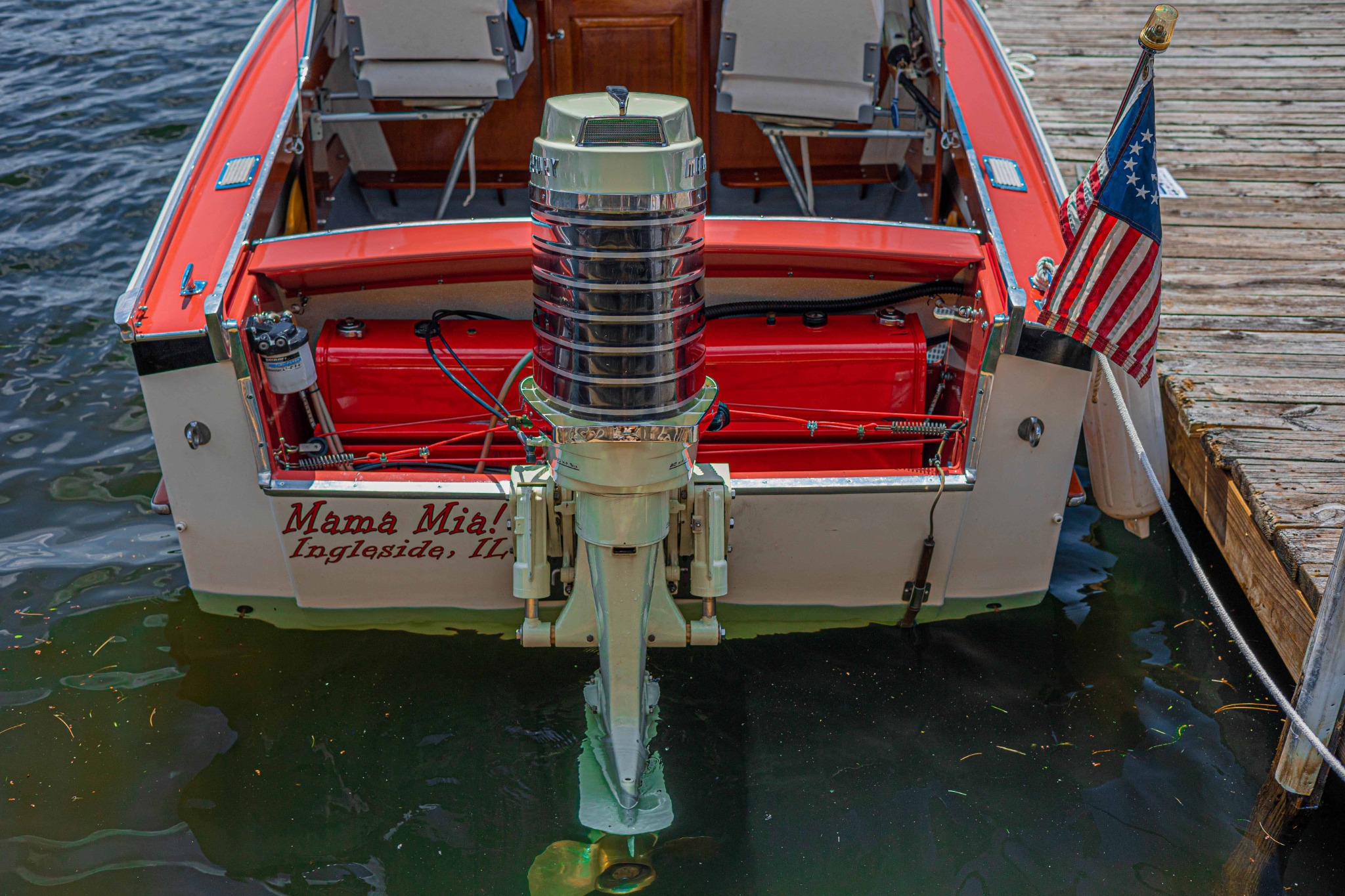

I believe Terry runs the bigger vertical slender tanks with top fill… so maybe Terry can chime in with thoughts and pictures. Too bad you don’t live closer as I have the narrow, but taller and wide 18 gallon Merc tank that has the built in gauge on top and also the fill cap and hose fitting on top. It can be fastened in place as if a built in and may fit along the back splash well… Terry would know. Maybe you can find one closer to you. Mine is very nice and I have no use for it now that my current boat is short shaft with shallow floor that would make it sit way too high for my shallow boat. Good luck finding your solution.

Mama Mia! has Tempo 12-gal vertical tanks and they fit perfectly into the early style motor well. Your 61 has the later self-baling style well which allows tanks to be stowed below the well.
The trick option on the later Seafairs were saddle tanks.
Awesome all original Sunliner.
The tanks are rare and I believe were also manufactured by Tempo. And they fit the Seafair hull perfectly.
And you correctly deciphered the Glasspar code.
