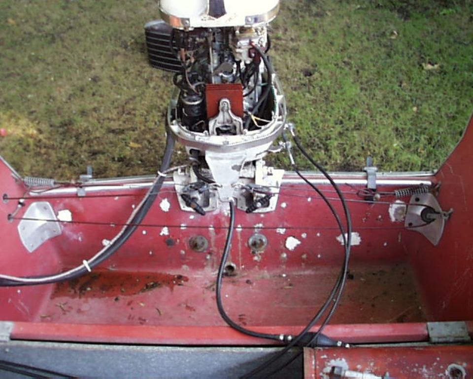

email him and you should get a reply later that day. A tip I was given on this site or elsewhere, see attached. Tape the cable once wound on the steering drum pulley while you're getting it mounted and running the cables to the stern. Tape comes off when all is secured and tension on springs.
