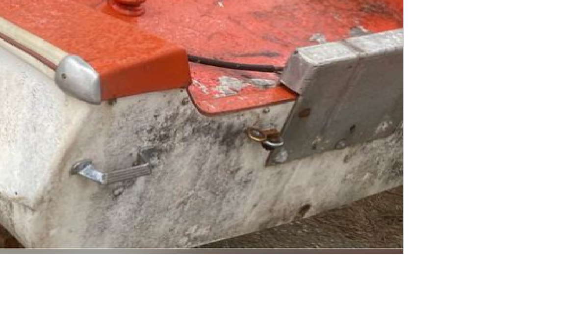

Thank you! Would you say that any boat past 20 years would most likely need the transom replaced? Also I have no purchased the boat yet, but this picture was included. Do you think this condition already suggests rotting of the transom?

There more than likely won’t be any stringers in your boat. Crosby used balsa as a core sandwiched between two built up layers of fiberglass. If it were mine, I would gel coat it. Longer lasting and able to be more easily repaired/patched from mishaps. Also helps to diminish that overshine so apparent with acrylic finishes. If restoring to original, and want that original look, gel coat is the way to go. If you do it yourself, it isn’t easy. If you have it done, it isn’t inexpensive. The transom? Test drill and look for moisture and/or rot. Looks like the transom has been modified. Remove the added extension and poke around.

I would guarantee that a sandwich transom that old with holes drilled in it for attachments will be rotten.

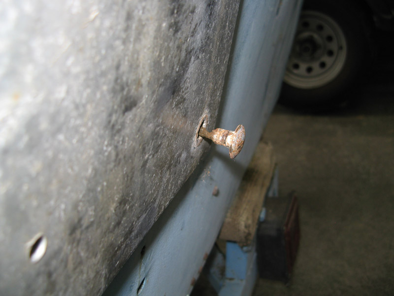

Crosby Capris are nice boats, but I just wanted to jump in here because I see this possibly heading down a path you may not like. Don't assume it will just be transom replacement. Unless you know the previous owner did work on it, or you have properly inspected the boat to positively know there are no underlying issues, you should expect that this would be a big project. If this boat does have a balsa core, you're in for a lot more work. Usually they're wet/rotted and a lot of people who have replaced the balsa core in their boat say, "never again" - it's nasty work. Also, and I am no expert on Crosby Capris, but I believe there is wood sandwiched in the deck on the bow. With all the hardware typically attached, you can probably expect water intrusion there too. Several years ago I looked at a Crosby Capri listed here locally for free. I passed on it because of all the work that I knew would be involved.
For the transom, simply removing one of the bolts holding on that aluminum plate and inspecting the hole may be an indicator. If they didn't use stainless bolts (one looks pretty rusty in that picture), then you may remove a bolt looking like this which will tell you everything:
