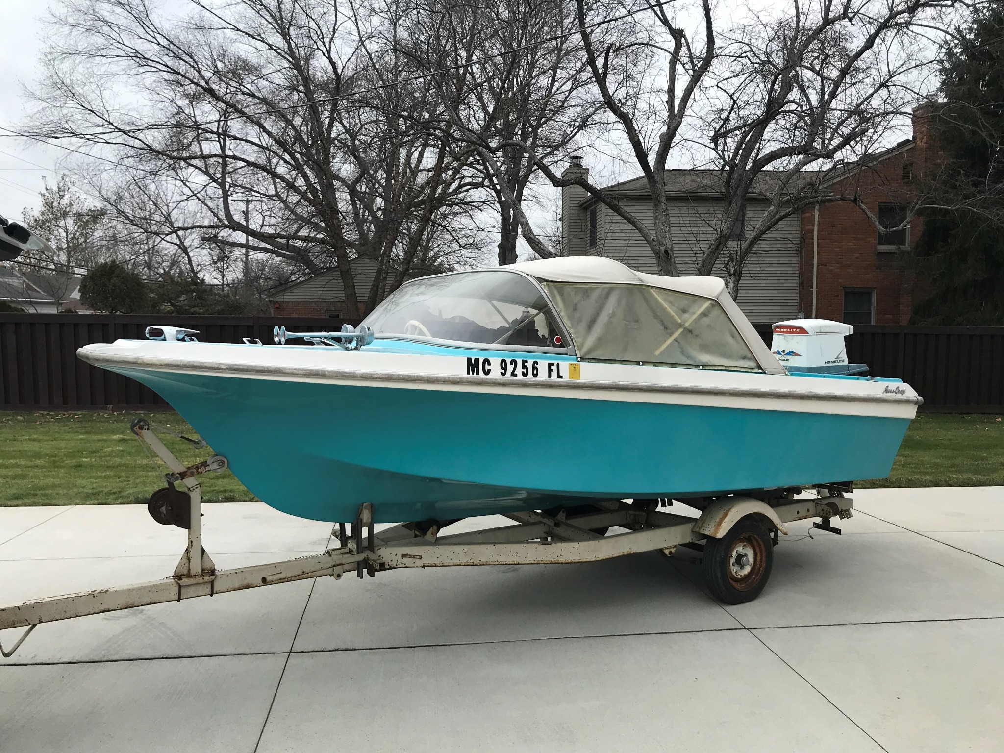

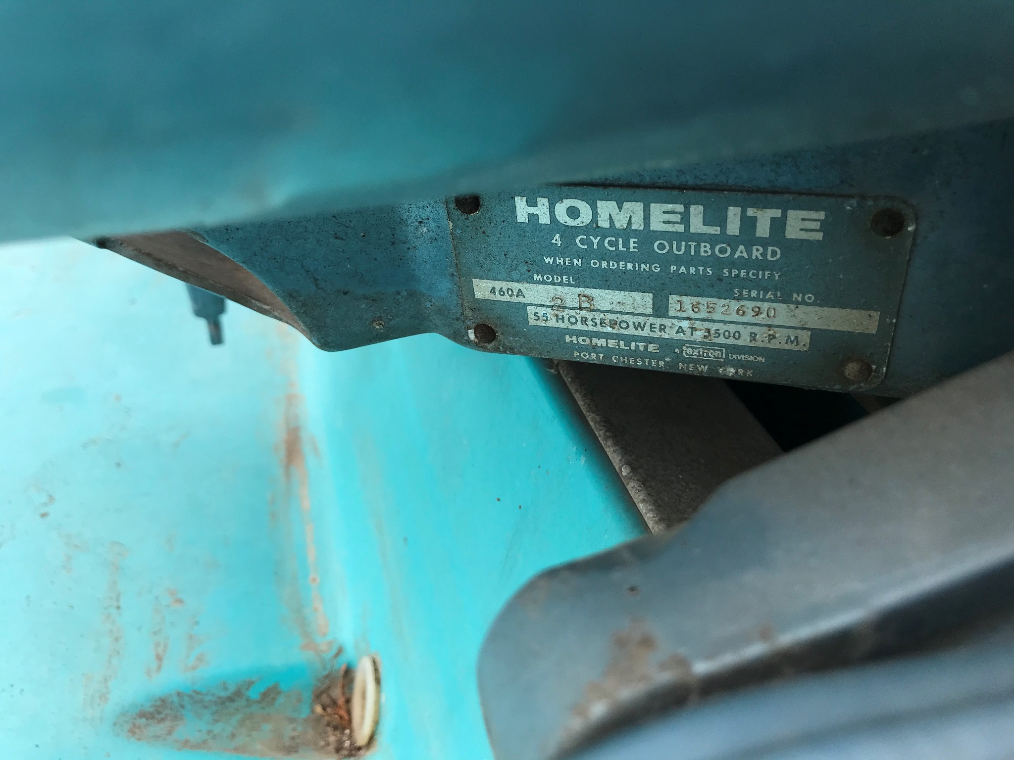

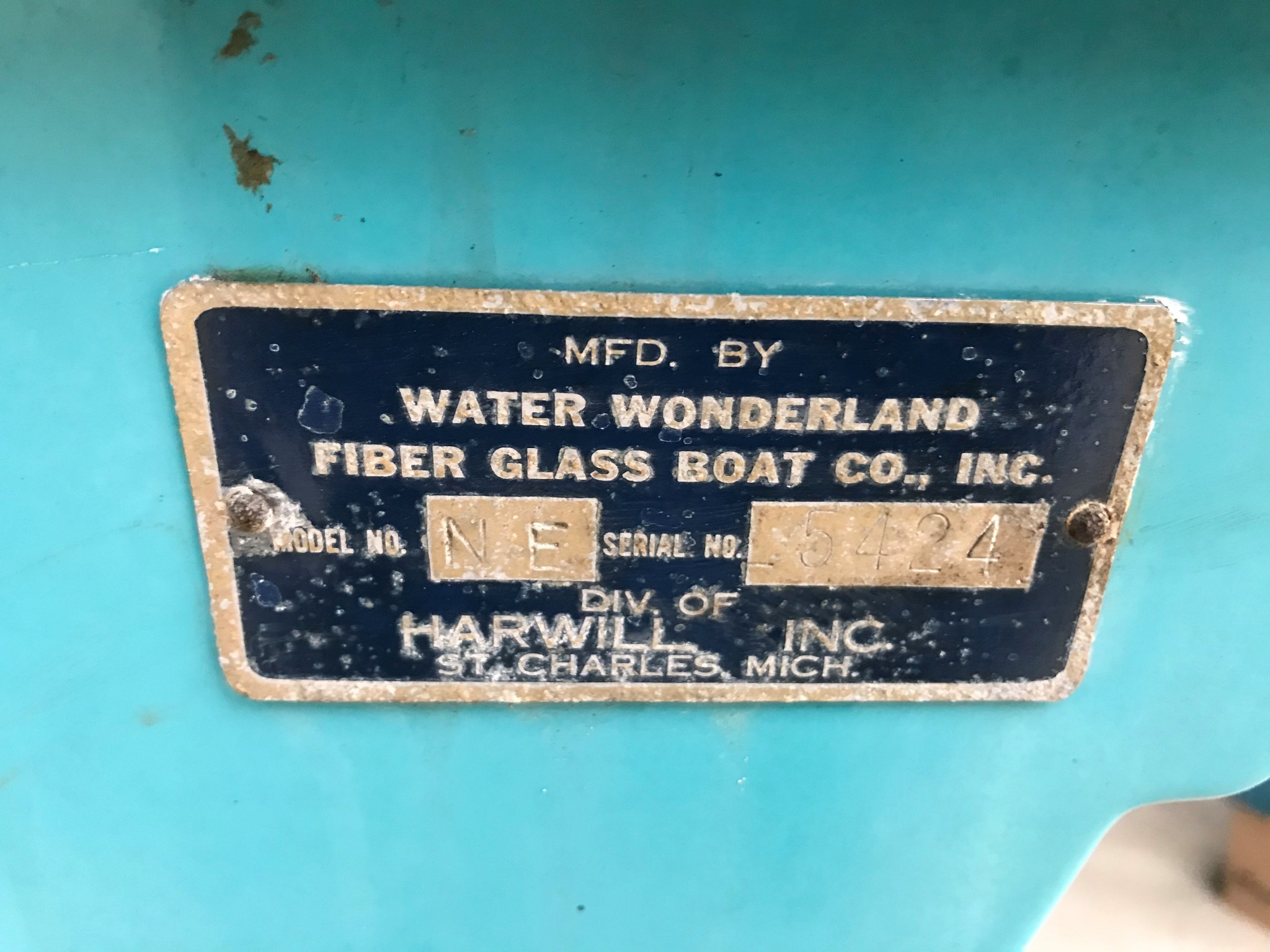

Hi All, I just bought a 1964? AeroCraft Newport with a Homelite 55 4 cycle engine on it. I am struggling to get information on the boat, but it's in nice shape and only needs some cosmetic updates. If the State of Michigan ever opens back up, I will register it.
My big issues come from trying to get the engine running. If anyone has any advice, I would love to have it. One of my first issues is trying to get an oil filter for it. (Homelite Filter # 90167-1). Somewhere, (not sure where), I found a cross reference to a Wix Filter 24104, but that filter is a fuel filter. I do not think that will work. This engine was later called a Bearcat 55.

Yep, those are the interchange numbers for that Homelite Oil Filter... you can add NAPA PN: 4104 to your list.
My notes say that with this style oil filter to "tighten with a Large Channel Locks to be sure it's tight and won't vibrate loose. These filters do not crush a gasket like car oil filters do. They overlap an O-ring and must be tight against the aluminum oil pressure relief housing."
Hope that helps.
