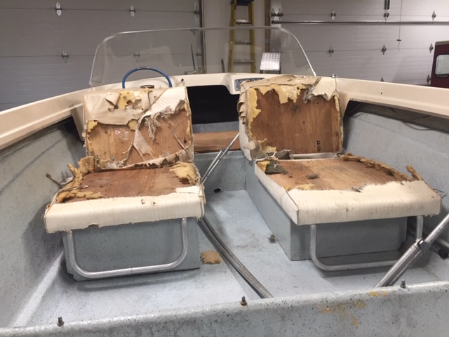

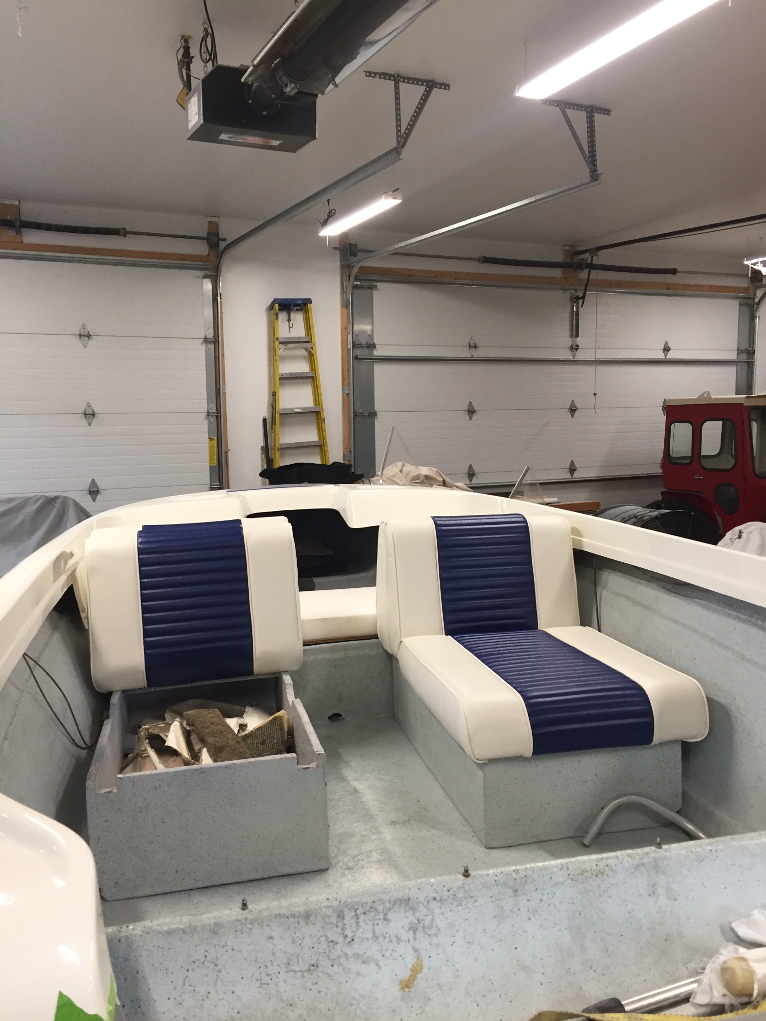

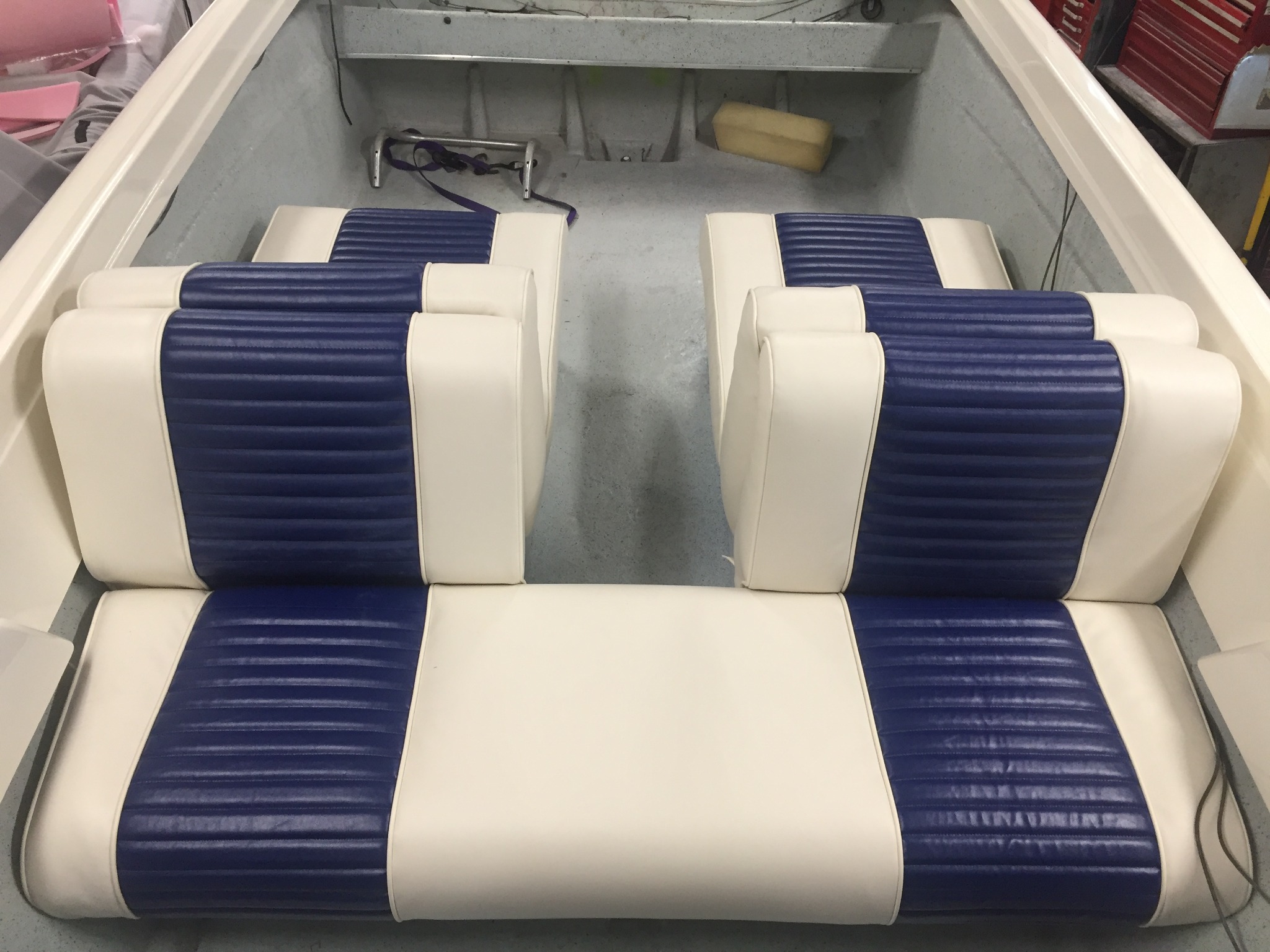

I rebuilt the back to back seats in my '60 Bowman that were destroyed by a racoon prior to my purchasing the boat. Anyway, I had the frames and plywood backs as a starting point but had to make the cushion patterns from scratch. I searched the internet for photo's of vintage boat seats I liked and also purchased a second hand commercial walking foot sewing machine for the project. There are many good tutorials how to sew online. If you search for "Cechaflo" on you tube, I learned a LOT from him. Also look at Sailrite.com, They sell material and have many tutorial video's as well. I purchase materials (seat foam and vinyl from both Sailrite and Albrightssupply.com. As far as patterns for your seats you can make your own frames and seatbacks from marine plywood to the size that exactly fits your boat. They're pretty simple, just time consuming but you will enjoy the end result and have the pride knowing you did it yourself.
