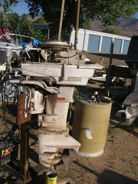

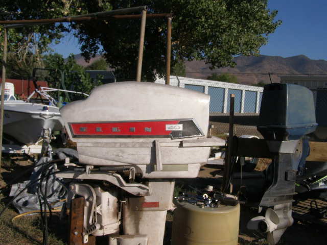

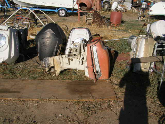

OK you wanted some pix. The first one is the motor I'm working on with out the hood and with the hood. The other is sitting for now.
Mike aka pathfinderz1
