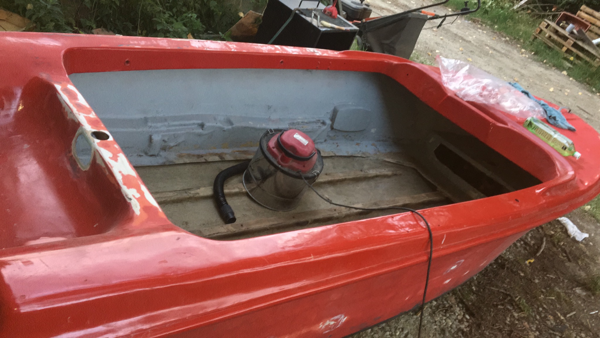

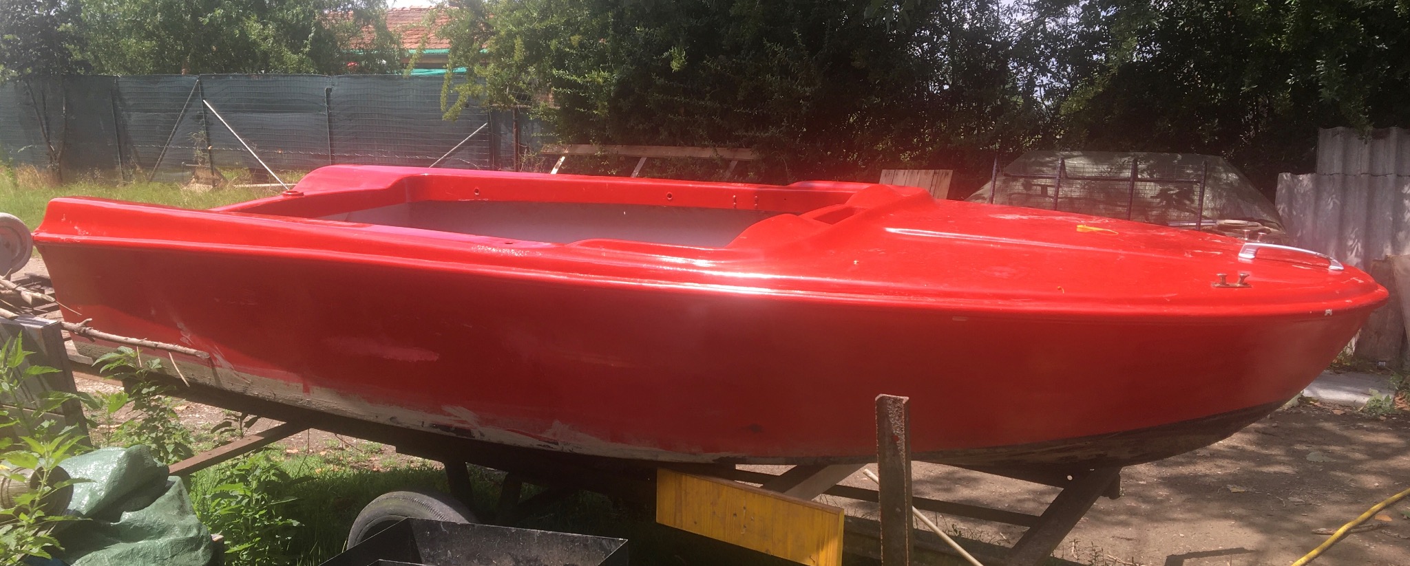

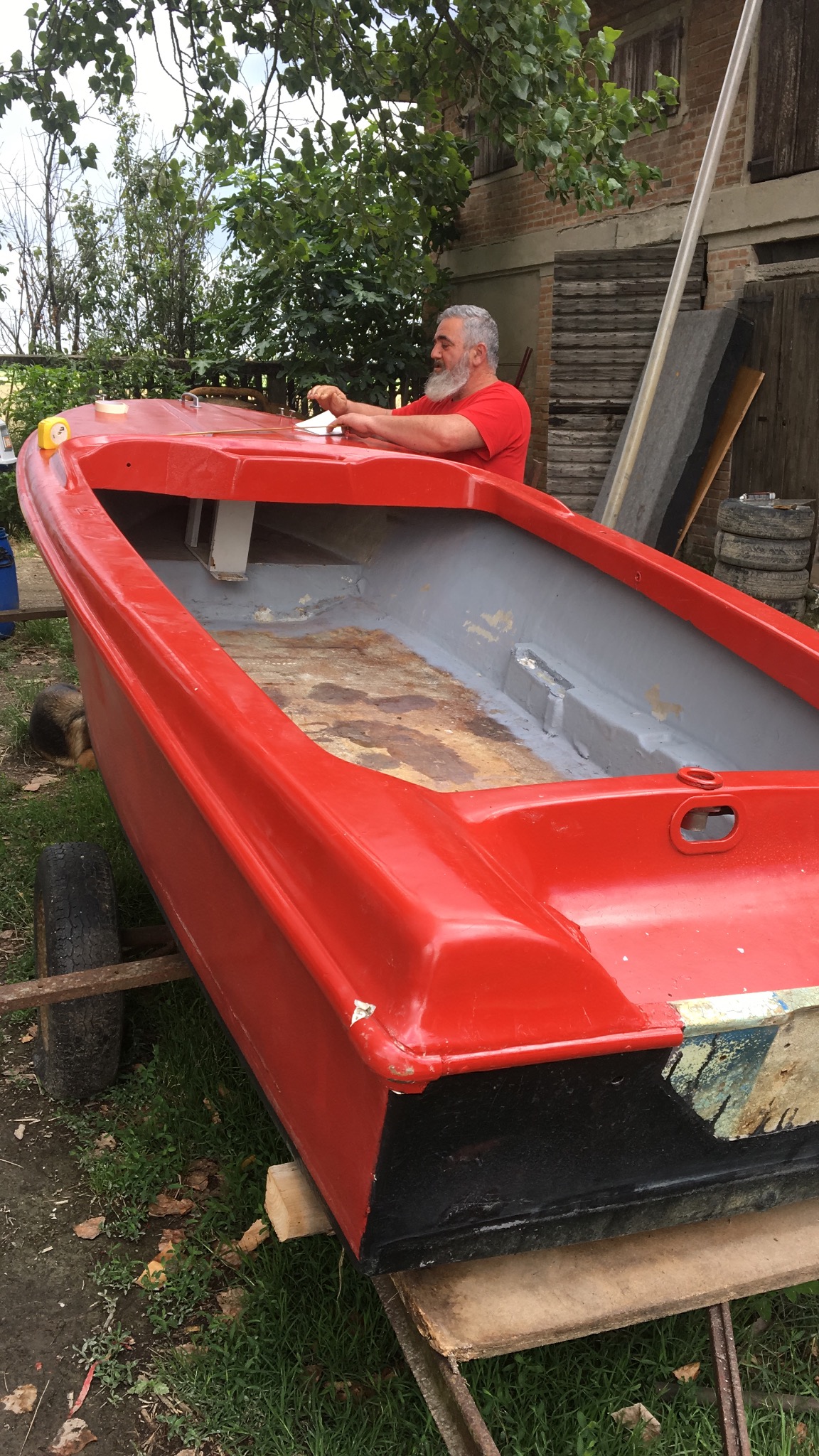

I recently bought this little fiberglass boat, with the intent to fully restore it to go fish and maybe play a bit with it in the mediterranean sea.
I already sanded a good 70% of the rough brush applied red paint, to discover what seems the original light blue color.

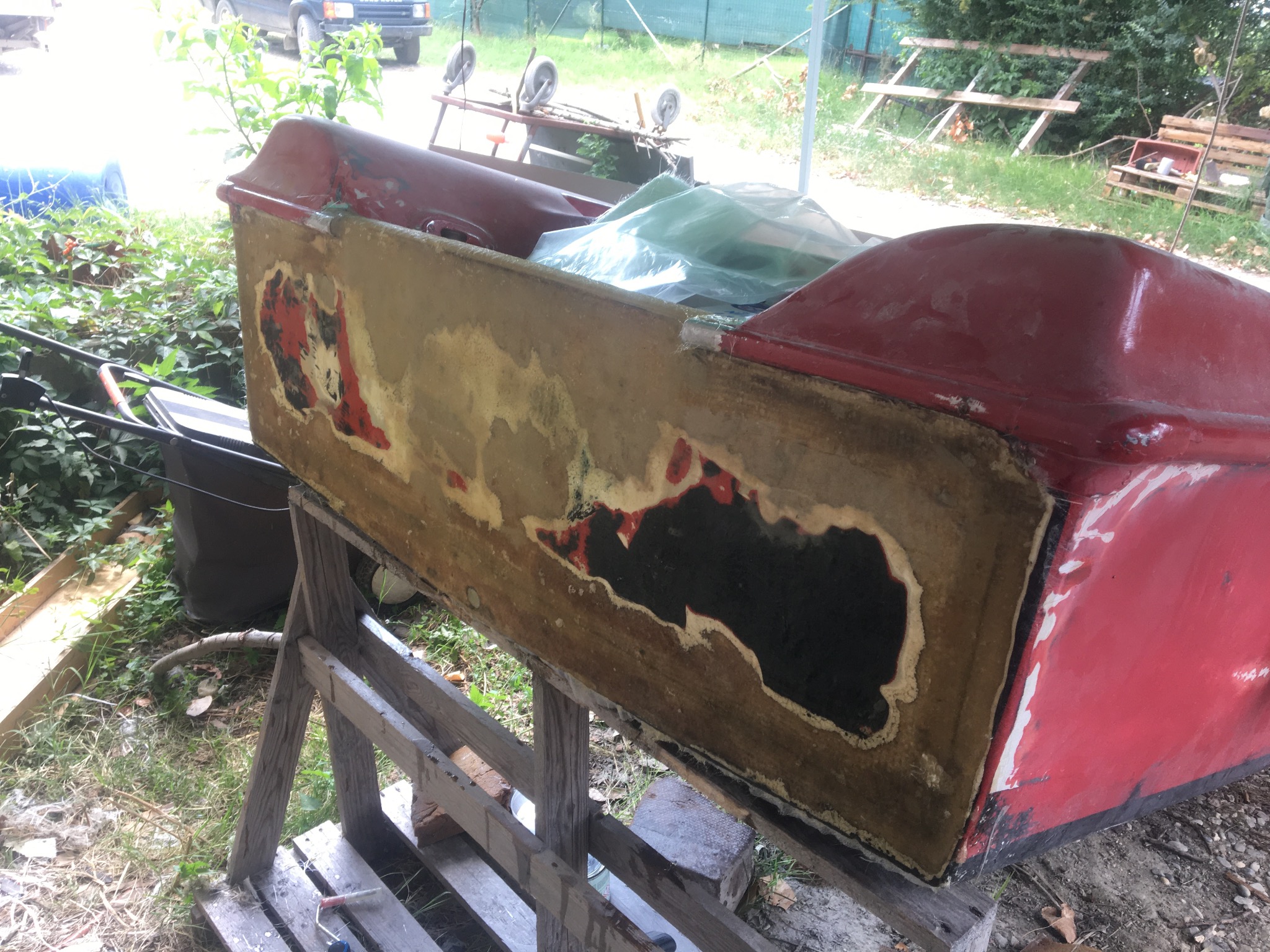

Replaced the transom, i’m now playing with filler to smooth out some damaged areas and as soon as i’m finished with that i’m gonna paint it.
My question to you fiberglassics experts is:
Have you ever seen this model boat or do you have any suggestions on what make could it be?
It’s a 12 foot all fiberglass, had a very rotten Plywood transom, and some kind of unsinkable like feature in the form of a lot of spray foam in the transom corners and under the front of the bow, that has been replaced with some new foam as what was in there was brown and looked exactly like 40-50 years old spray expanding foam.
It has a dash molded into the fiberglass with what seems to be the outline of where the windshield would go but no signs that one has ever been installed.
Under it, what Looks like the previous location for a rope and pulley steering wheel system but it’s on the port (left) side (if that is of any importance, all the boats i’ve seen have it on the starboard side so i guess could be something)
There are no holes or steering shaft support on the starboard side.
I’d say its a 4 person boat and to my untrained eyes looks to have been made in the 60’s.
What do you guys think?

Thank you guys for your feedback. I have found an identical boat for sale about 200 km from me but the seller didn’t know much about his either.
Do you have any idea on an approximated year/decade it coud have been made in?
The restoration is taking a LOT of time, mainly straightening out a bunch of previous half-assed repairs.
The whole centerline of the hull has been glassed over the paint and then repainted.
as soon as i started sanding the area, it started to delaminate and i had to strip it most of the way down to the bare hull...
but the transom is finished and hopefully it won’t take all winter to recover the hull and paint it.
Anyone recognize this boat model/manufacturer? 6 years 1 month ago #143221
So it does seem to have some Owens lines to her but I don[t know. I would say late 50's very early 60's but i'm not sure, sorry. She will keep you busy and be great when you're done!
