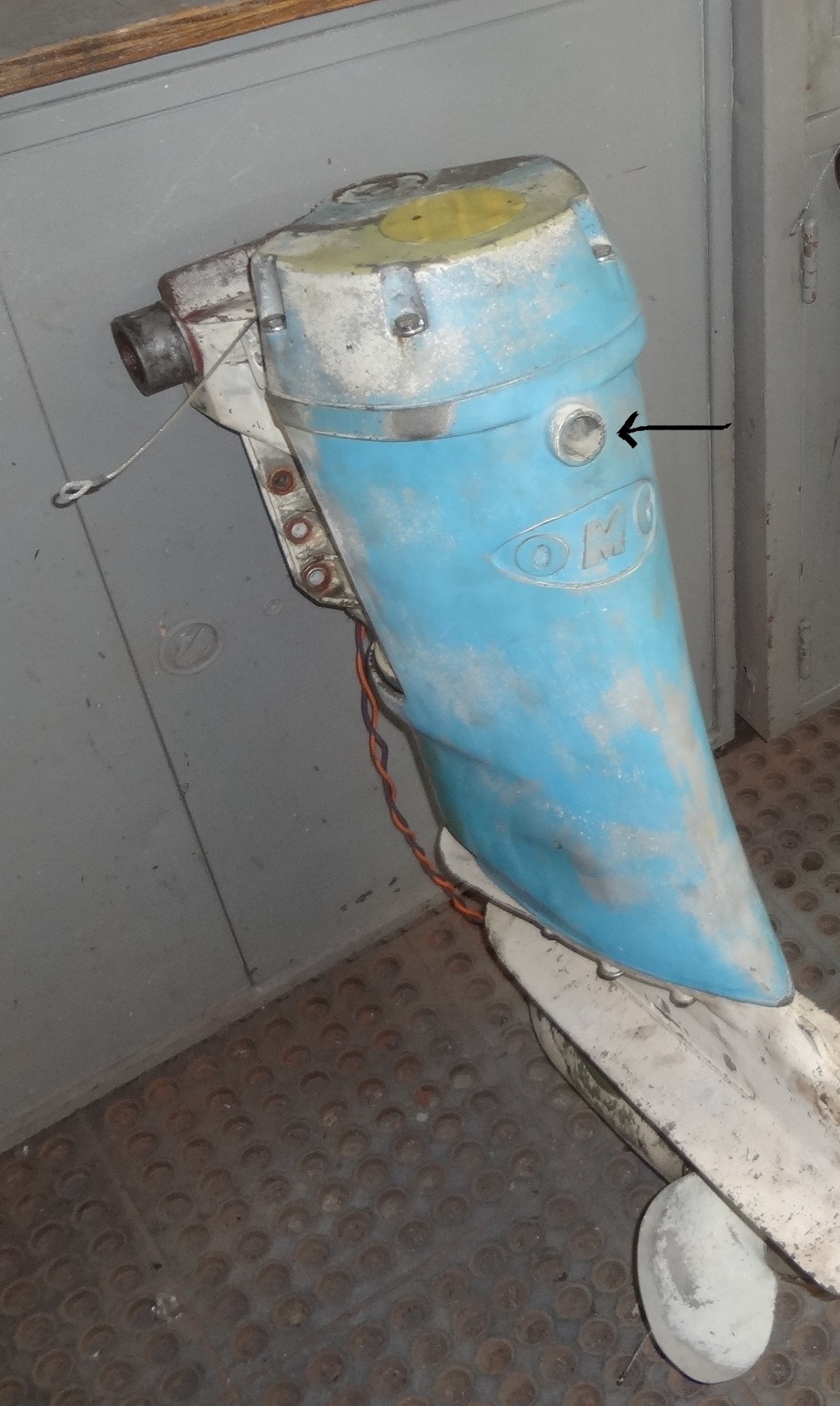

What I know about OMC stringer outdrives will fit in a thimble. Can anybody tell me what this 1" hole is for on the rear of an OMC stern drive? It must do something but it's a mystery to me. Thanks

Exhaust relief port.
OMC Mystery Hole 6 years 2 months ago #143026
  • Nautilus
  • Posts: 1580
  • Karma: 87
  • Thank you received: 58
Excellent! Thanks! Since I've routed the exhaust through the transom, I have another use for that hole.

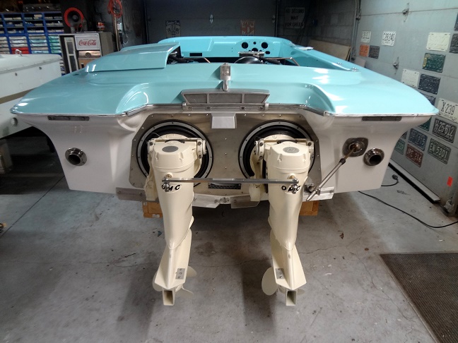

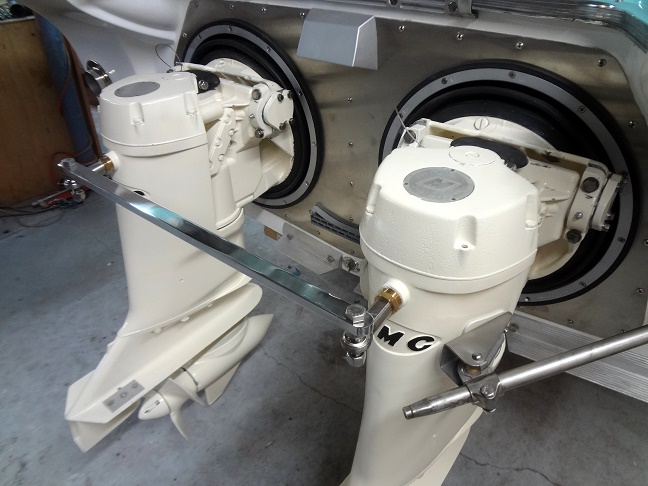

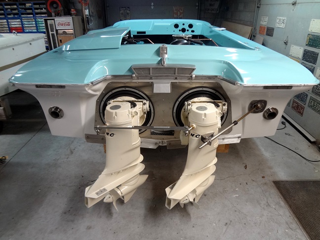

The OMC Dual Deluxe resto-mod has twin OMC 120's with the exhaust routed through the transom. I converted the steering to cable using an OMC ball joint set-up. The exhaust relief holes were the perfect size to tap out for 3/4" pipe. I used brass 3/4" x 1/4" bushings which I drilled out to 1/2" in order to mount stainless Heim joints which now connect the two outdrives with a 1/2" x 1" x 24" piece of aluminum bar stock, polished of course. Looks good, works fine.

OMC Mystery Hole 6 years 2 months ago #143038
  • Dr.Go!
  • Dr.Go!'s Avatar
  • Posts: 1719
  • Karma: 19
  • Thank you received: 125
Looks excellent! What a sweet combo you are cooking up. Nice engineering job!

OMC Mystery Hole 6 years 2 months ago #143040
  • Nautilus
  • Posts: 1580
  • Karma: 87
Engineering is a kind word. Rube Goldberg would be proud of me.
Mentor to the unenlightened!
"Success makes...
OMC Mystery Hole 6 years 2 months ago #143044
Yep outstanding!!!!!! Looks even better in person. ;)
OMC Mystery Hole 5 years 10 months ago #143577
I had not seen this post! Really perfect. The boat will be beautiful!
