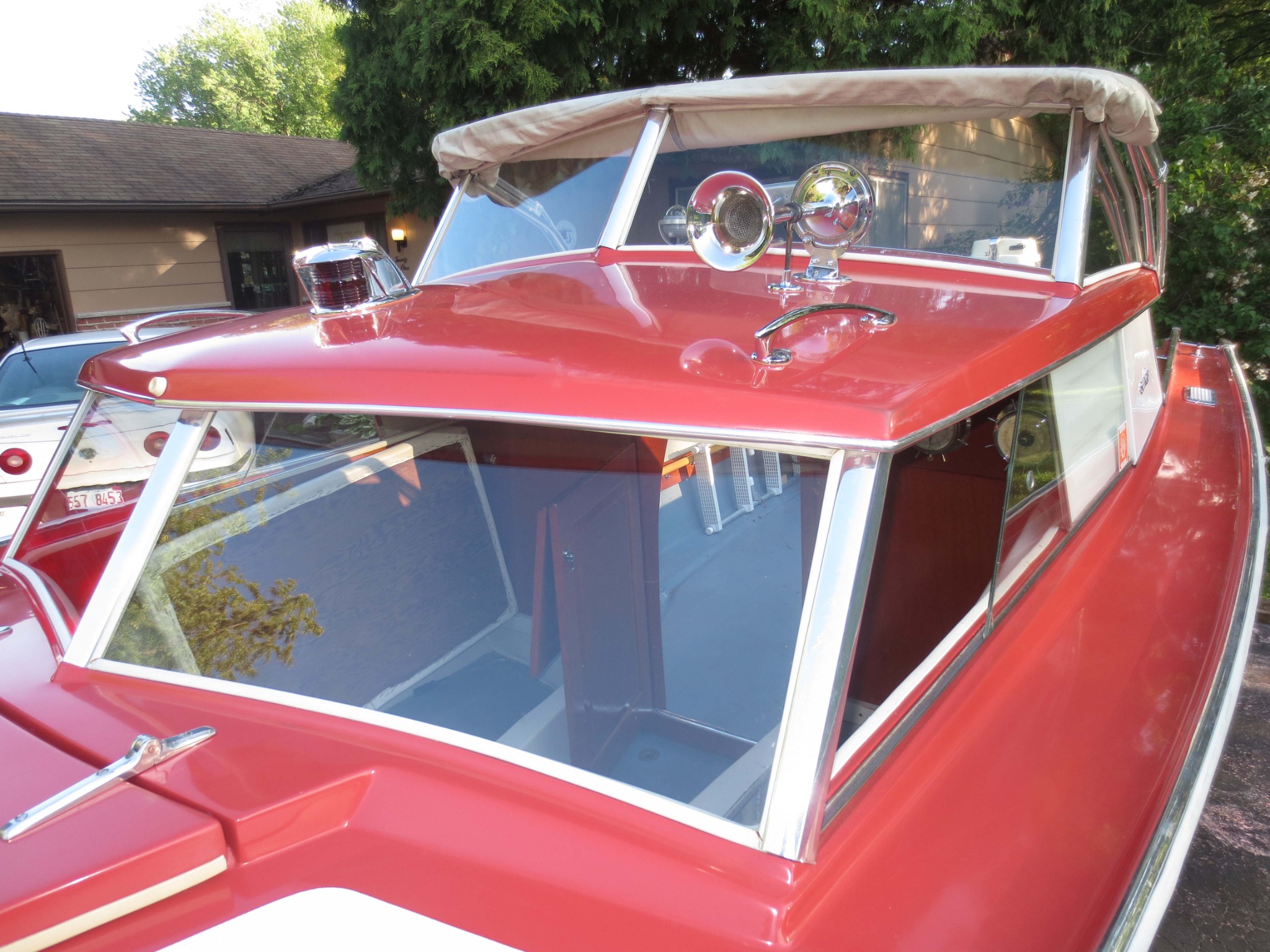

you have a picture of this horn
Testing/wiring a 1965 Sparton horn - not working 6 years 2 months ago #143018
cap-n billybob wrote: you have a picture of this horn
Yep. Here you go. I am getting about 0.9 Ohms across the two wires, so I'm thinking that's good. It's riveted so I don't want to have to open it because I assume I need to drill out the rivets. I think the star-like screw is the pitch control.
