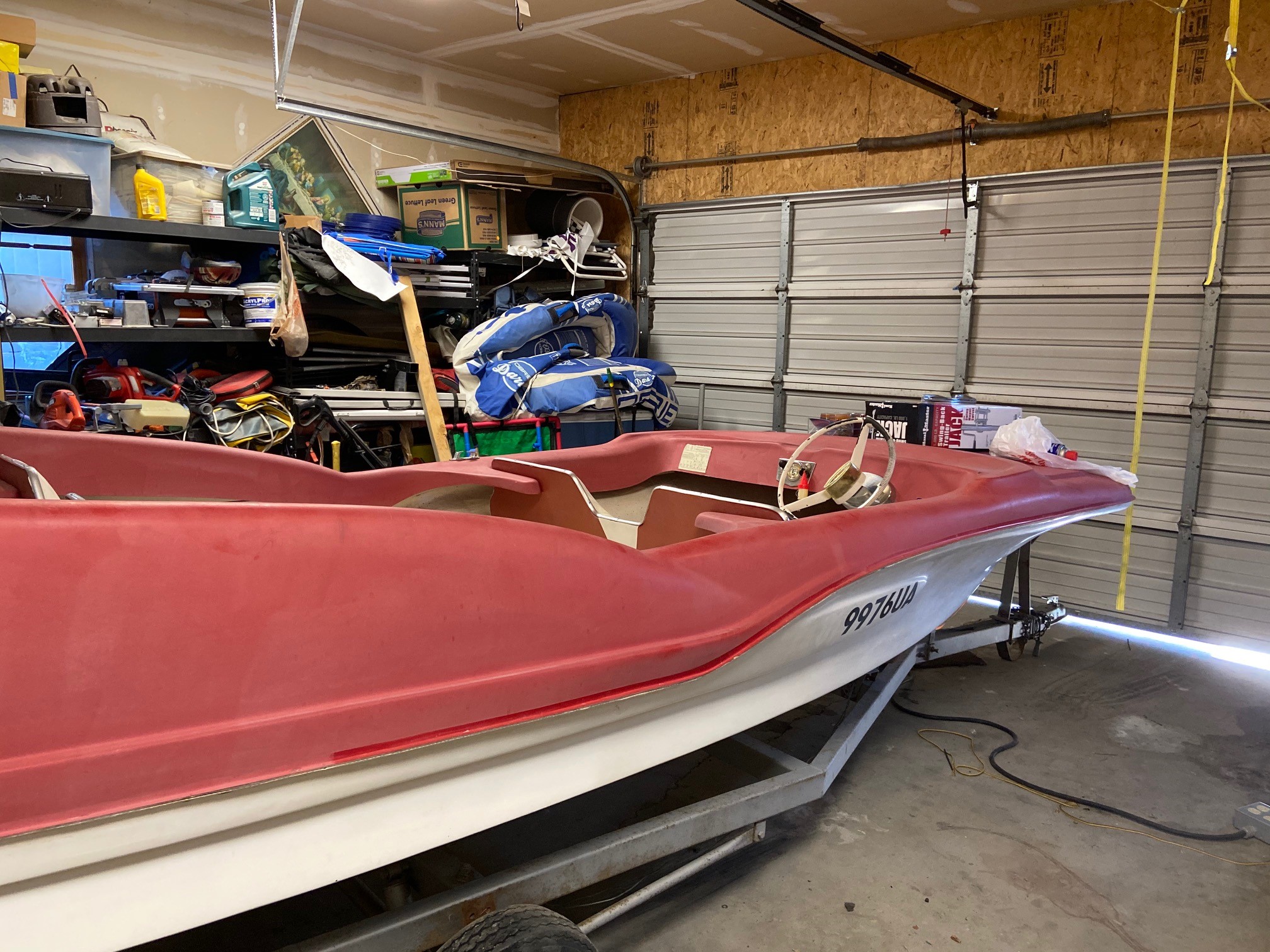

I am restoring a 1959 Redfish Shark. I am trying to locate the proper rubrail (I have the original retaining clips). I ordered what looked like the appropriate size (0001G LG) from WEFCO, based on their profiles, and it was way too big. Any advice on what the correct size is for this boat? I would appreciate any help.

Have the exact boat missing the exact rub rail. If you have any success at all please share and I'll do the same if I find something. I don't even know for sure what it looked like I just have a bag of clips that came with the boat
