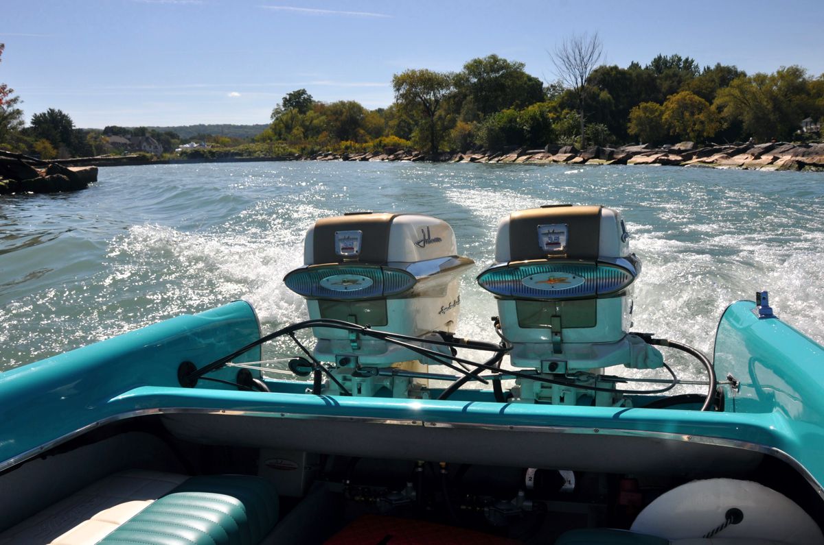

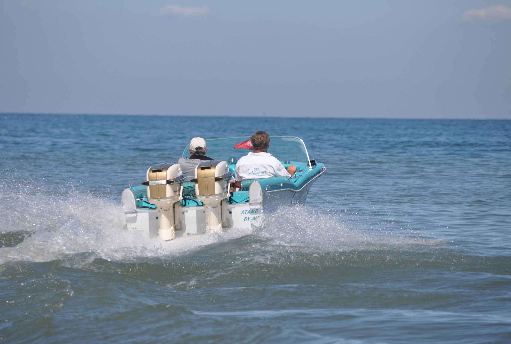

I don't think weight will be a problem, I've got about 300 lbs on mine. Just want to be sure your transom is solid.
Cheers
Bill
New Motor on 1959 Glastron Firelite 4 years 10 months ago #142975
Absolutely beautiful! Many thanks. If I ever screw up the courage to trust the dealer and invest the $, I'll post a follow-up. I've been trying to get on the Glastron forum but no luck.
