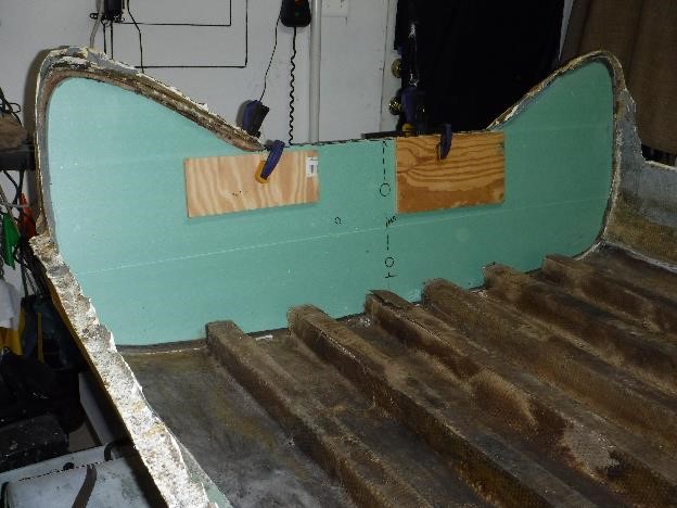

hi,
try starting with a roll of cheap brown craft paper or gift wrap. start tacking it in place across the bottom with small pieces of tape and push the rest up into the seam where the transom joins the hull. then run a pencil around the perimeter. that may be enough or you can transfer that to something more substantial. I like insulation foam as its easy to use for other things like tracing the pattern to your 1708 or chop mat. see pic below and watch video if you like. this one had some big horns as well! hope that helps-
around the 3 min mark the transom pattern starts
www.dropbox.com/s/6kmvby4jew1ktp3/L%20%26%20S%20Part%20I.mp4?dl=0

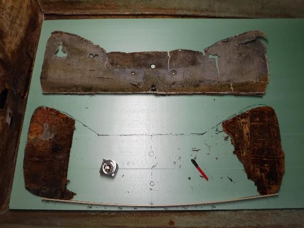

  • Thank you received: 19
more recently, I did something similar on this one working the top of the boat on. had to do one solid piece and one 2 piece to get it up behind the engine well. then glassed the seam
on video between the 2 and 3 minute marks
