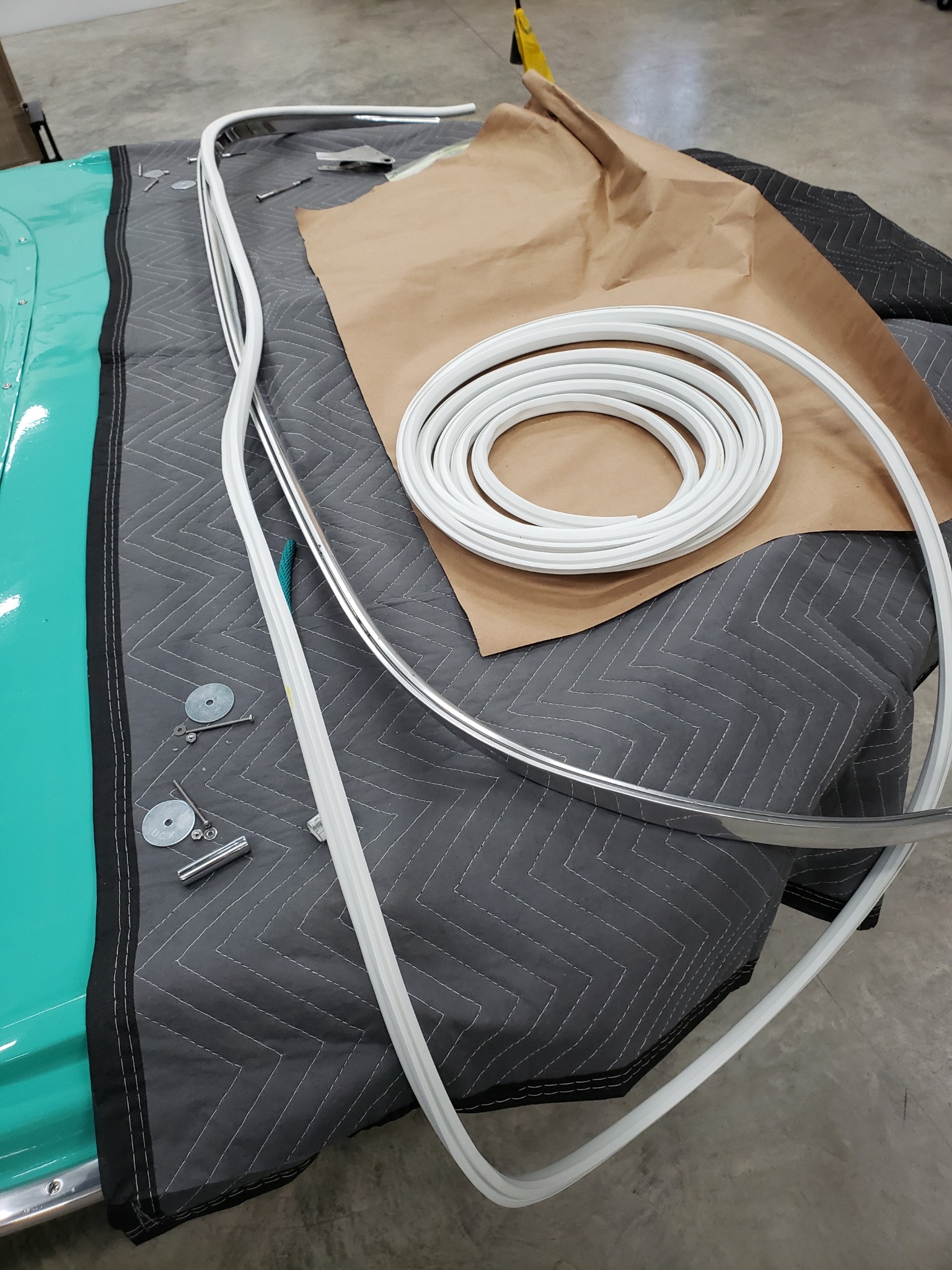

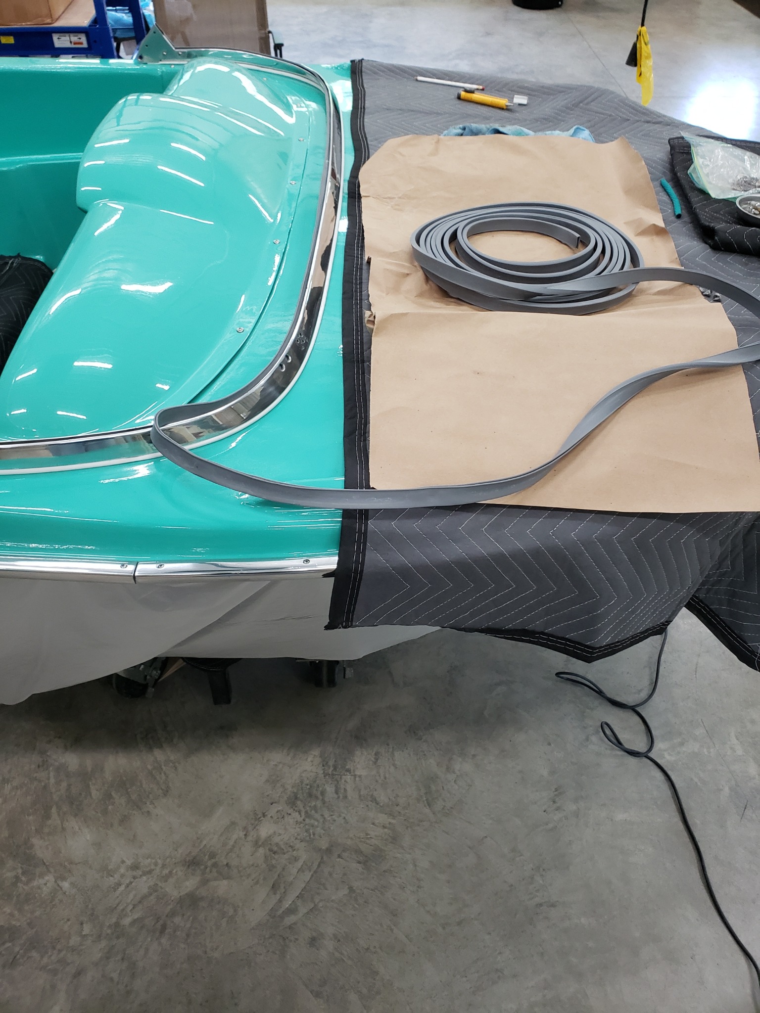

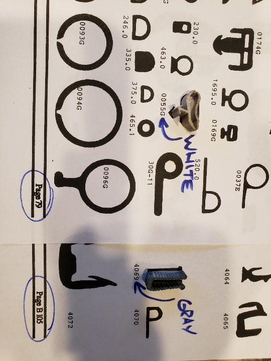

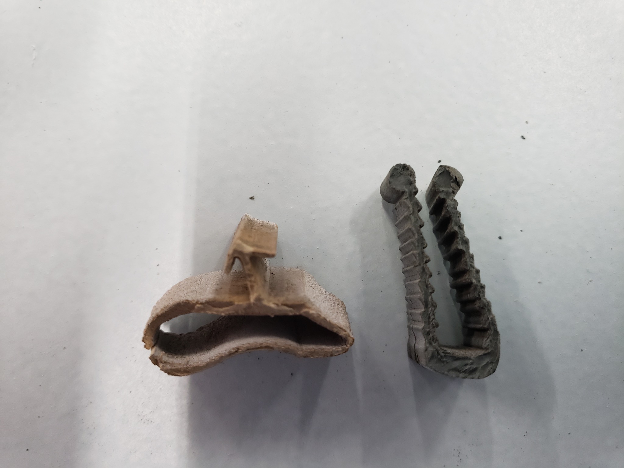

do you have a picture of the cross section profile? Google Taylor white windshield gasket. Most boat supply stores carry it. It you need the insert type or specialty profile go to Wefco. They have pages of profiles that if printed are pretty much to scale. Here are 4 reference pics. This was for my Lake n Sea. white tube was between boat and windshield with arrow inserting into frame channel. Gray went in the internal track to hold windshield. Note that it took 6 weeks for the white as they only run white once a month or so. Hope that helps-
