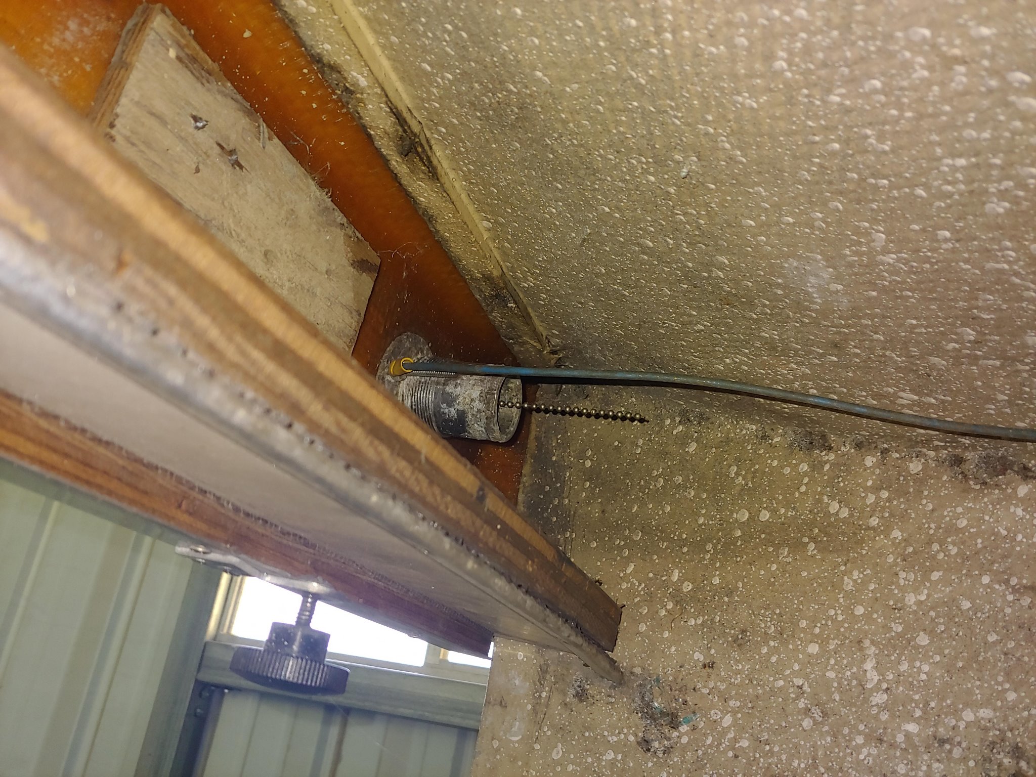

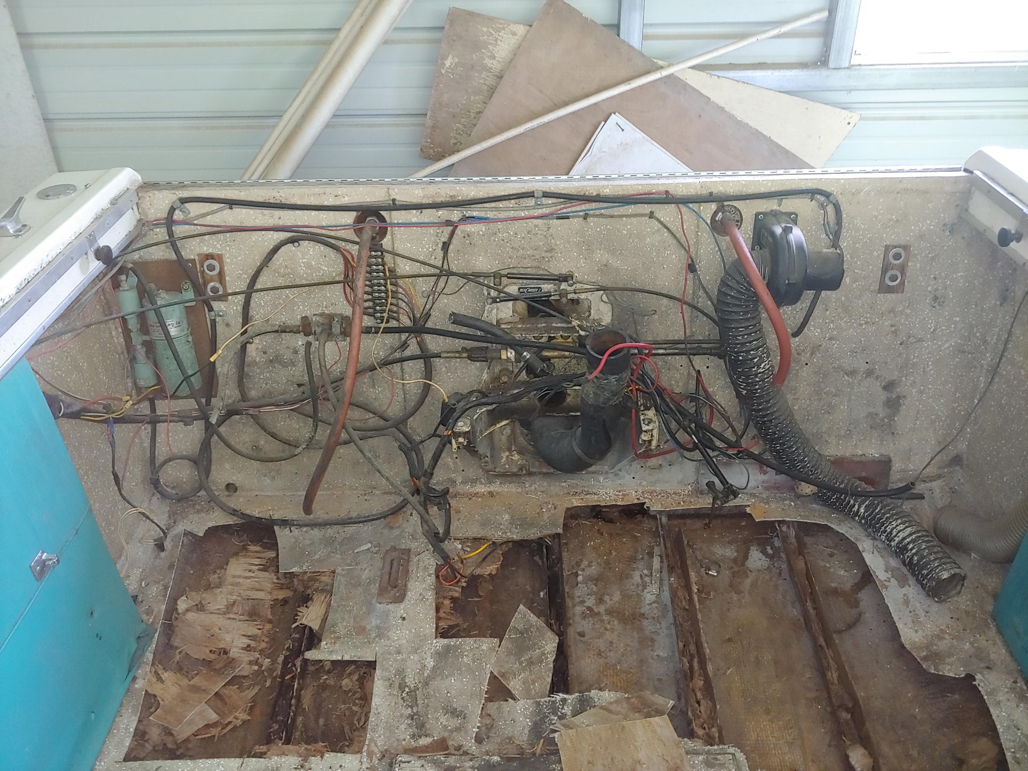

hi all!, wanting to restore family boat, 1963 slickcraft, had a weak floor, though no problem can handle that, removed everything, decided to cut a section out, and actually no wood left. anyway, stuck my hand up around drain hole, transom wet, soft, drilled a couple of test holes have way up the transom and wet! So, it appears to me to remove transom, deck will need to be removed? anyone will experience please give me your thoughts! please.

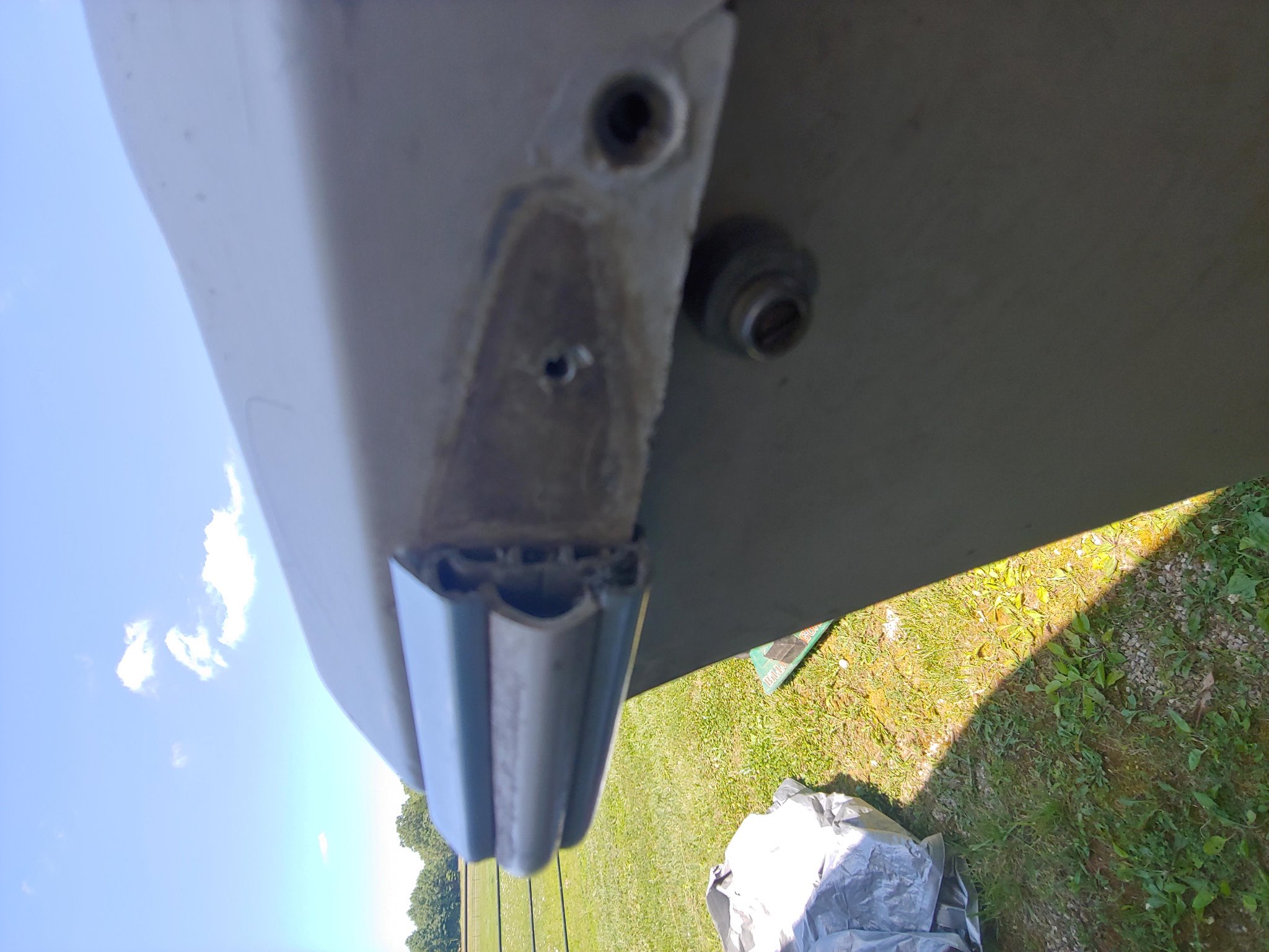

i don't mind taking the deck off, or actually if could just push forward, but is there a trick to removing the rub rail in order to get the screws that attach the deck?
help! rotten transom 6 years 3 months ago #142618
Yup. Here's what you do.
Take a large screwdriver, start from the end of the rubber insert and pry it out. Once started they usually pull out easily. If not, use a heat gun and gently just warm the rubber up and it will pull out by hand. Screws are underneath that rubber part.
Good luck.
