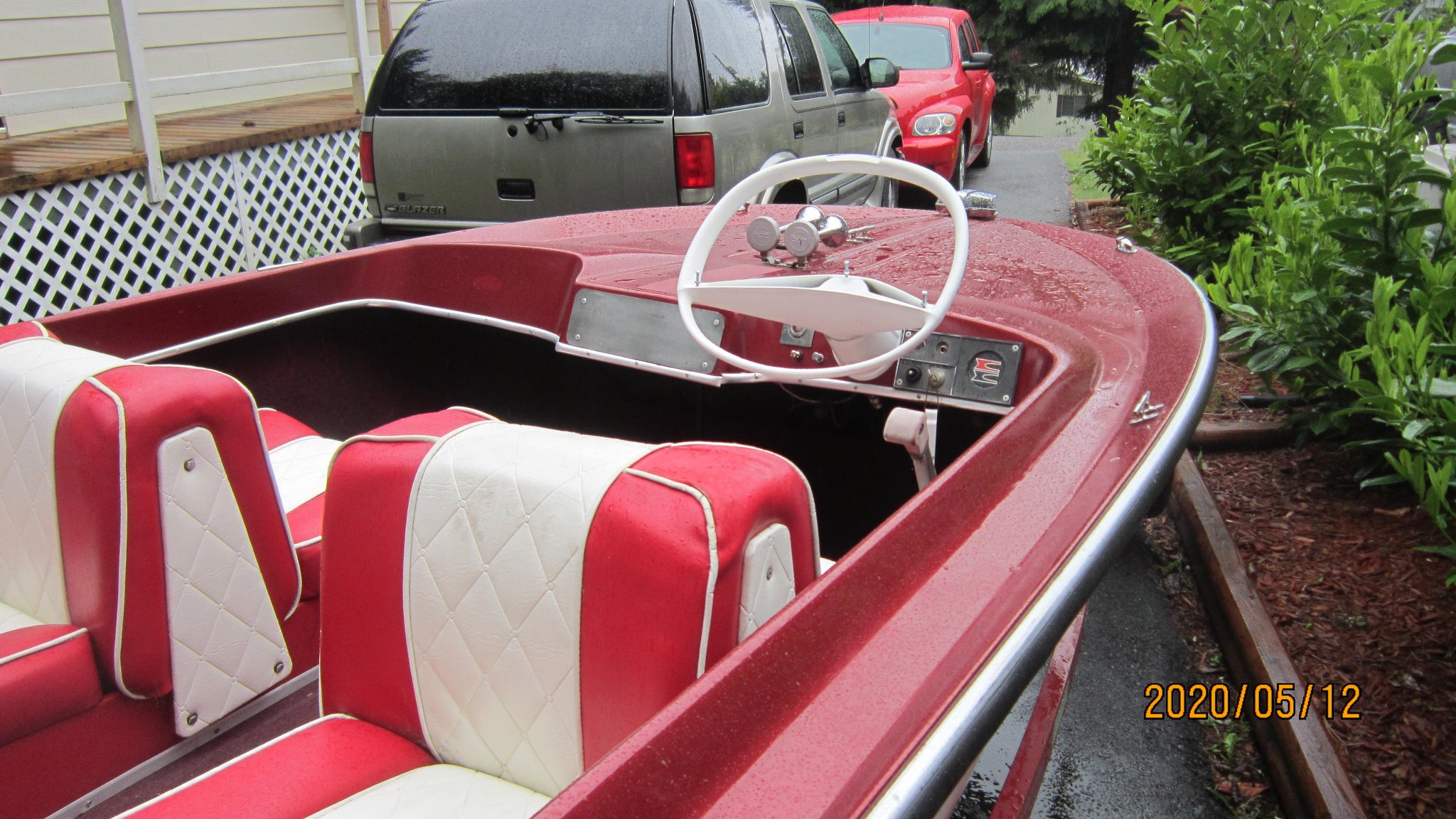

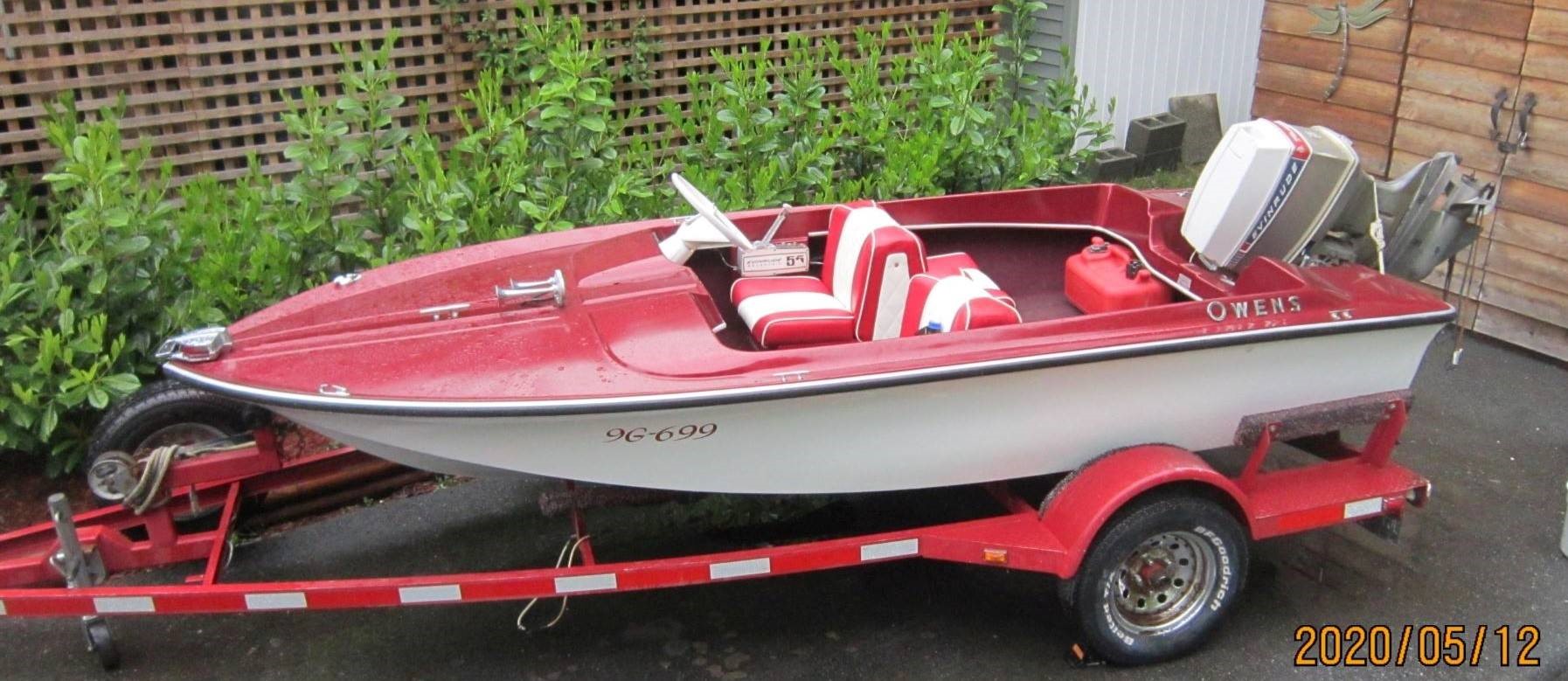

Just bought this little boat a couple of weeks ago. Am I correct in thinking it's a 61 or 62 because those were the only years that Owens made a 13ft. ?
