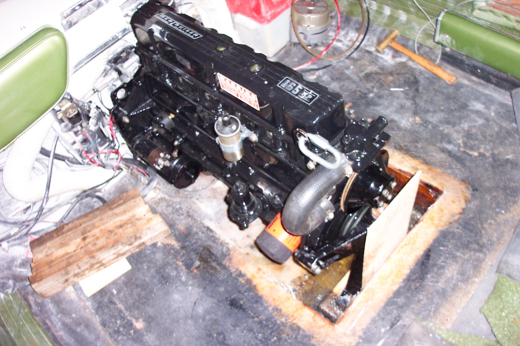

I don't think it's the prop hub, you wouldn't smell that. But an engine coupler shouldn't cause a water leak. Regardless, pulling the engine isn't that bad on your boat.
Here is mine going in after an engine swap from a 140 to a 165.

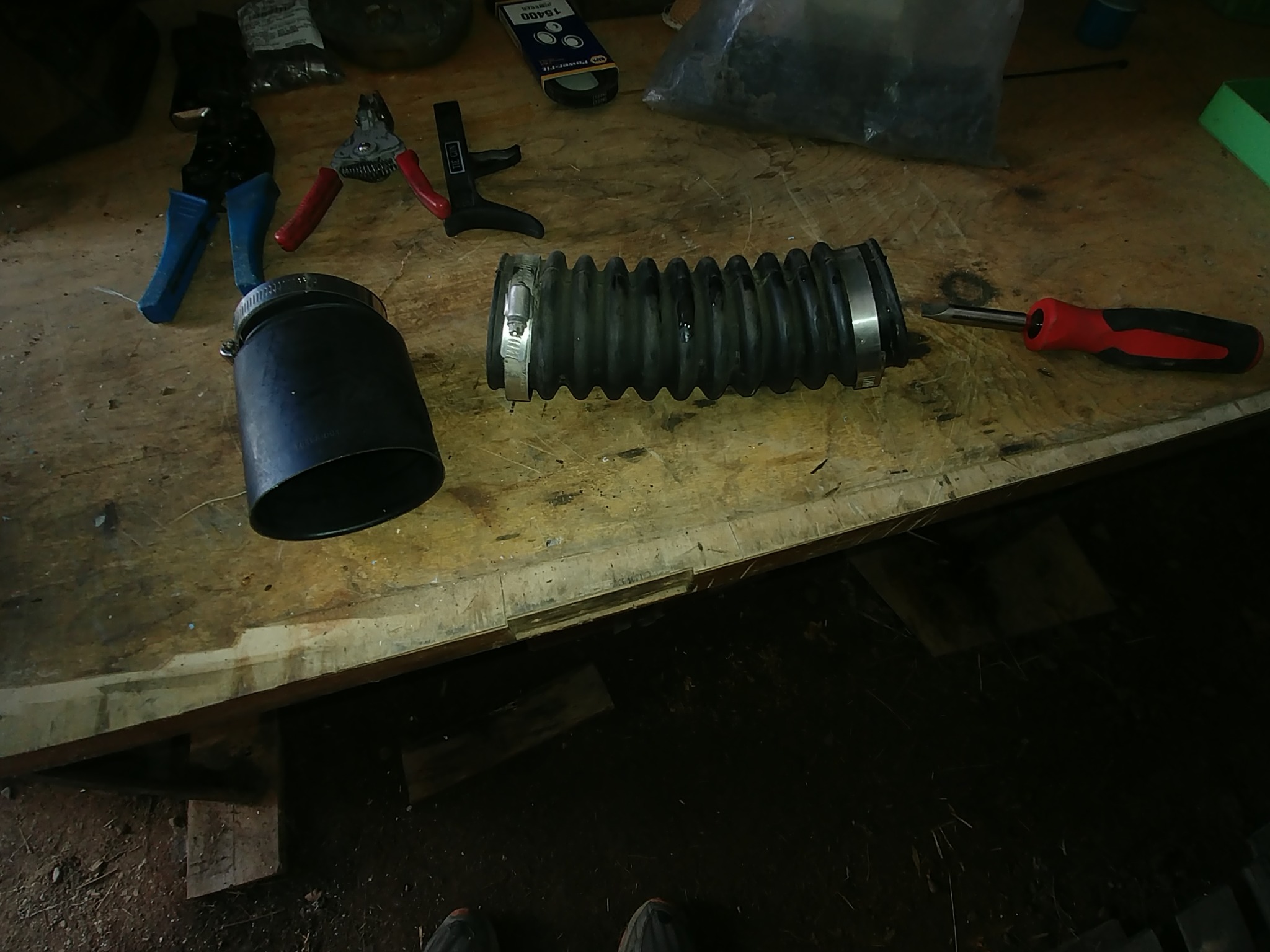

After the glass work, you'll need gel coat, I believe they called that color Citrus or at least they did in 1970. Try Spectrum Color in Florida. You may be able to send them a sample (perhaps cut from behind a rear seat back) for a custom match.
Windshield support rods are generic, made by Taylor Made. Any good dealer should have a catalog with them & bikini hardware to choose from.
I never saw the fix for your outdrive problem.
My water must have come in over the riser, the check valves are long gone. I've put lots of time on the engine with no further issues.
Early MerCruisers did not have exhaust relief holes in the transom plate above the trim cylinder pins. They came 72, 73 timeframe. My exhaust bellows was torn for years & I replaced it last year. According to my seat of the pants, I lost some performance with a good bellows installed. Regardless, when the engine is shut down all water surges uphill to the waterline, actually it surges higher then stabilizes. (in the case of mine, from 2' below the surface). With relief holes, water won't have as much of a surge because it doesn't all surge from as far down. Bottom line, I shut it down with 2 big guys in the rear seats, reducing the height of the riser & increasing the depth of the prop hub & force of the surge.
I removed the good bellows & installed an exhaust tube. So now I have some exhaust relief & the performance is back to normal.

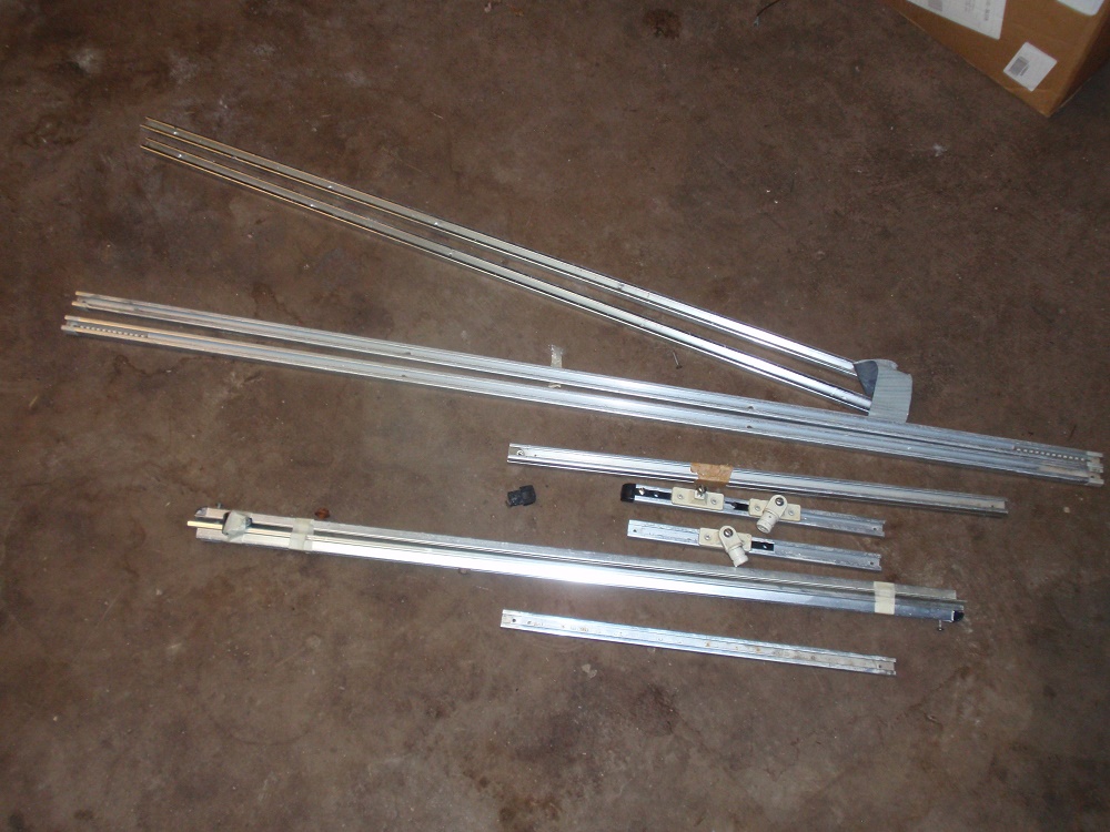

If you can post a picture of your windshield brace and the bimini track rail I might have what you need. Free....just pay postage. I'm getting rid of my "stuff".

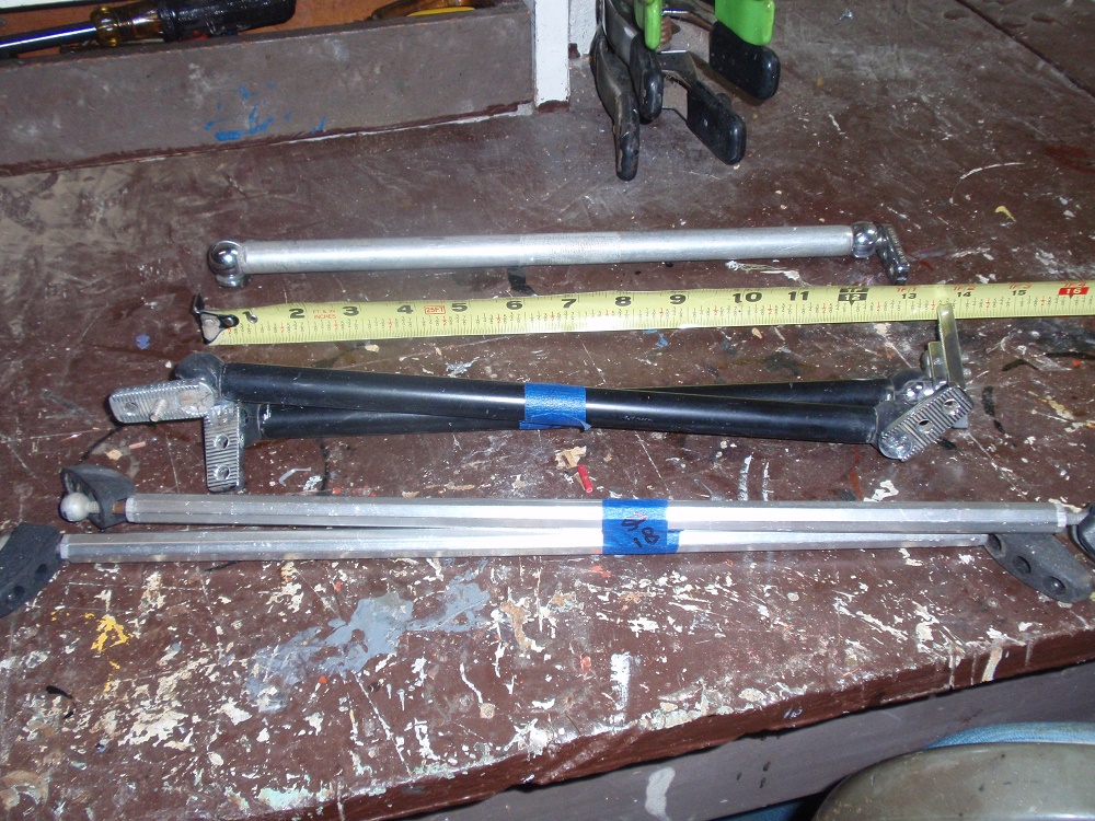

The insurance adjuster called today and she told me what I already know, it's not covered becasue it's a liability only policy. Now I can get on with it. What I need to figure out is how the windshield was fastened to the deck. There is a track on the bottom of the windshield (looking at it upside down). There are some small brackets that somehow slide in that track and hold the hing down. But how they put it together is a mystery. The side window and the front window are hinged and the hinge is just the end of the side window sliding in a track on the end of the front window. Anyway I'll get it figured out. The support rod is 10 1/2 longs not counting the balls on the end. With the balls its' 11 1/2" or there about. The attach photo is the section in question. The support rod is on the right. The one on the other side (the starboard side) is missing. For some reason it won't let me attach the photo.

I had a similar winshield on one of my boats. It had flange bolts that slid into the track on the bottom of the winshield. The bolts went thru the gunnels and deck with washers and nuts underneath.
Very Short Boating Season 6 years 2 months ago #142862
Those windshields are separate pieces. The slide together at the joints. Most of them have flat head bolts that slide in a groove on the bottom on the bottom frame, the bolts then attach to the gunnels and bolted underside.
I'll see if I have a matching pair of the braces and send a picture and the bimini slide rail, What is the length of the rail?

I don't need the bimini slide rails. Mine are fine. I have a couple of the slides as well that work fine. They don't match the originals but what the heck. They work.

The only 10 1/2" I have are the black ones.
The longest slides are 53"...but ya don't need those :) :)
