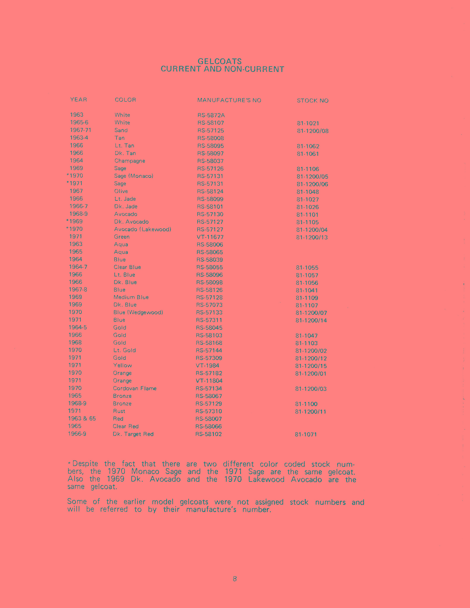

I can't help you with a paint code to match the Gold gelcoat from 1964 but I can offer the brochure page for your Futura and the gelcoat manufacturers part number. You will probably have to remove some of the blue and white paint to expose the original gelcoat to get a sample to match.

You won't find original paint codes since the finish was gelcoat and not paint. Try removing some of the paint, there might be good gelcoat underneath.
The original gelcoat number for 1964 Gold was RS-58045, My parts book doesn't list white for 1964, but the 1965 white was RS-58107.
Those numbers might mean something to a custom gelcoat maker like Spectrum, but that is still not paint.
