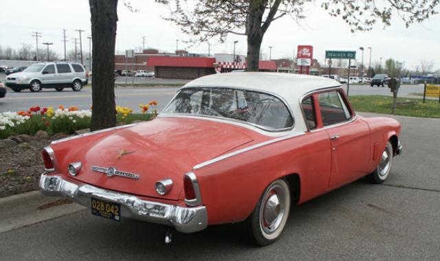

According to our friend Eddie Grijalva, in his book “Glasspar Boat Builder: Circa 1952-1962”, he wrote it was a 1965 Studebaker Champion.
An obvious typo so it had to have been a 55 Champion.

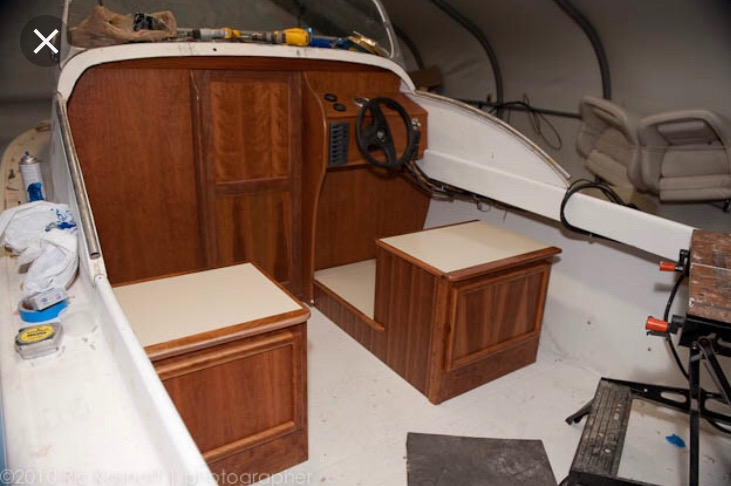

I have three del Mars and not only do none of them have seats, but in years of research, I've NEVER seen what the original seats looked like. I suspect that they were fold down seats like their big brother, the Club Mariner. In the brochure above, it looks like there are no front seats. Also, was there ever any back seats? I've never seen any photos of back seats. I'm dealing with these issues now on my restoration and I'm building folding seat frames from scratch. I'm using 1" square steel because I can't weld aluminum and I will never pay someone $125 an hour to do so (my dentist doesn't make that much!) Since the del Mars didn't have splash wells, the back seat would probably be a foot or so forward of the transom to leave space for a fuel tank. This would limit an already very small deck space.

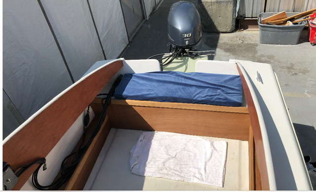

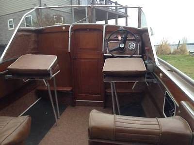

Thanks for the info! Yeah, I have seen a few options, that seemed to fit the time period, but wasn’t sure which might be “original”. I’ve noticed a hinged board with holes in it on a number of pics - not sure what that is.

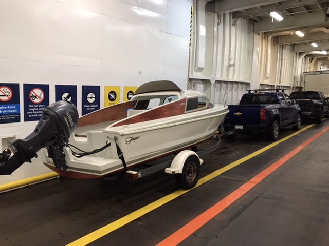

The guy that did the restoration on my boat added a pod on the back that the motors are on and then put in a bench seat at the back.
I’ve attached pics of the couple of seating options I like and the back of my boat.

I also added a bow fuel tank which leaves only a small tank for the kicker.
