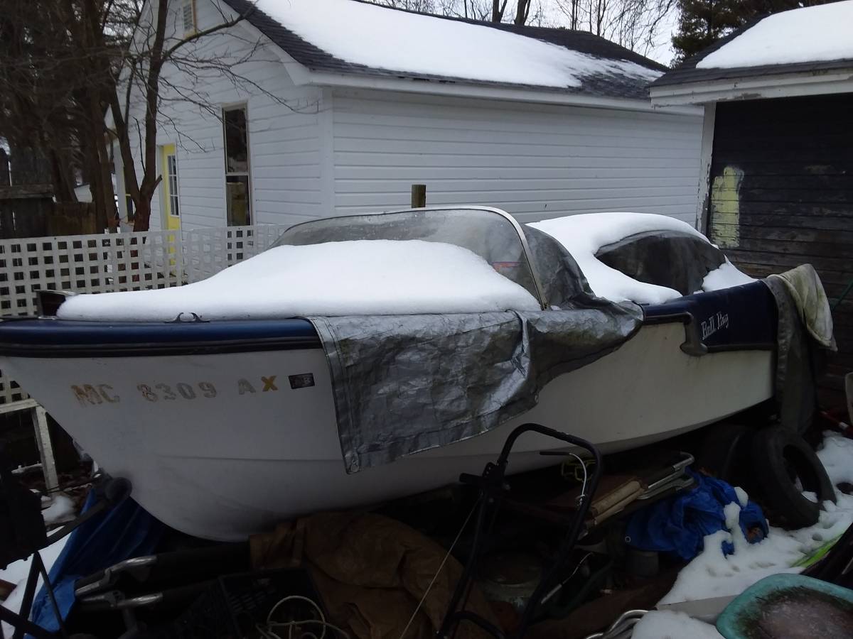

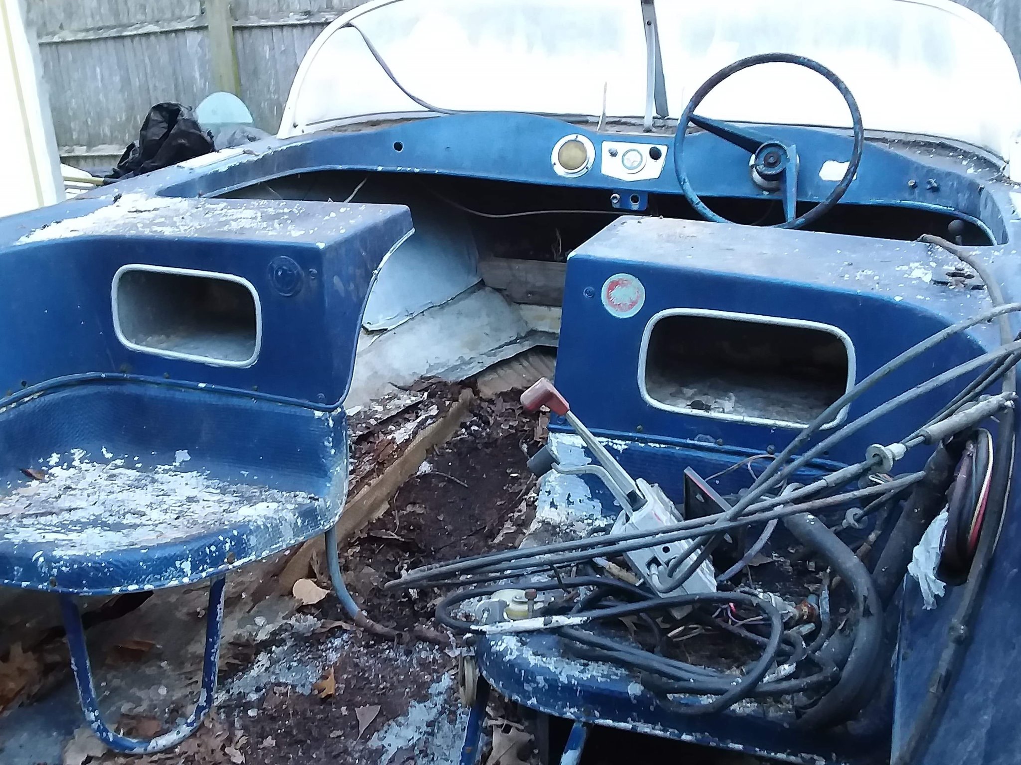

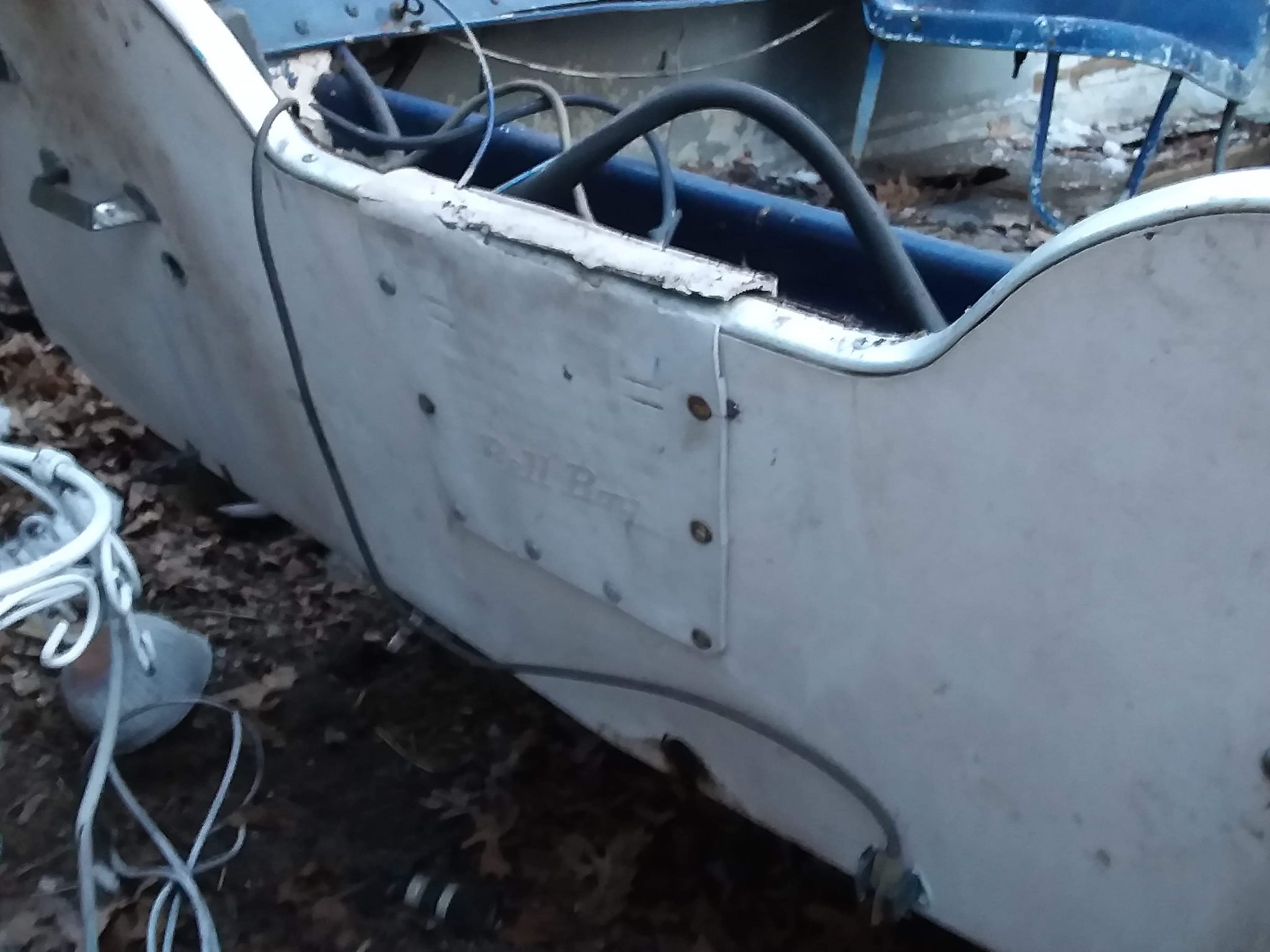

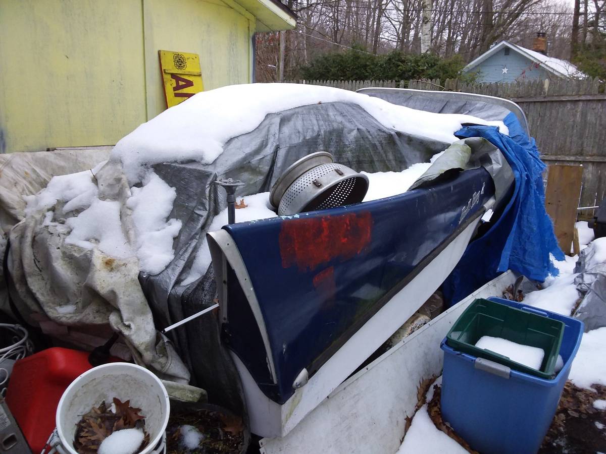

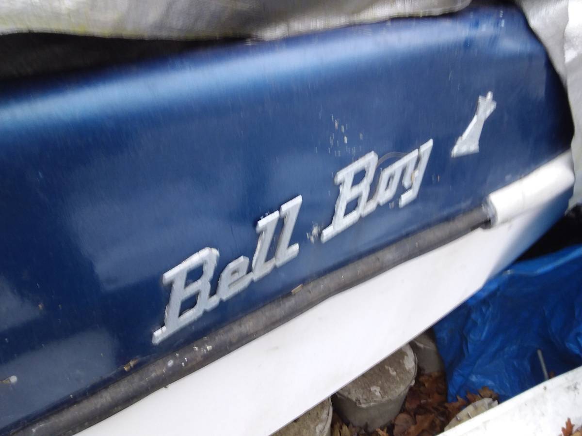

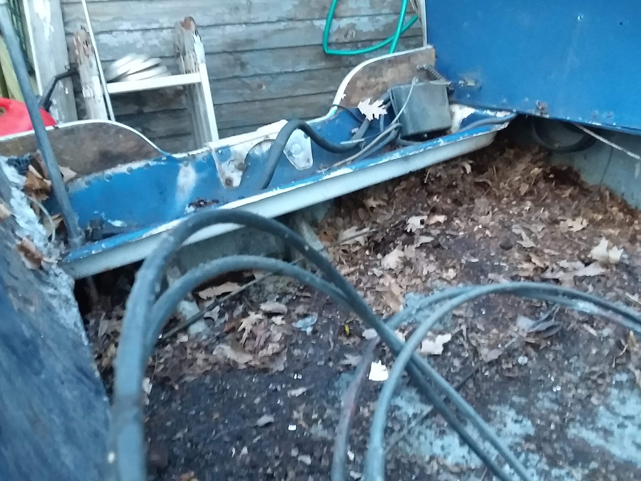

So far I have only bought Aluminum boats and have always like wood boats and some old Fiberglass boats.. I seen a older post on Bell Boy Banshee boats.. Well I've ran across a 1958 ( owner says 1957 ) but from what I've read here and seen on Bell Boy brochures the Banshee was only made in 58-59 .. and this seems to be the 58 version.
Well its what I would call rough.. but has all the emblems and tailfin aluminum pieces, steering ,dash interments, windshield,rear seats, and vintage Evinrude Big Twin outboard... but missing the front seats and the plywood floor needs total replacement.. the owner says the transom and stringers are all solid..
I'm not sure how the front seat and backs were attached.. I can't see very well on photos of others on the internet how they were attached.. any help here would be great !! this thing has a lot of dirt leaves and clutter in it that make it look bad but the owner says its solid with no exposed stringers under the fiberglass..
Heres a few pics as it sits now... any thoughts or comments on this one are appreciated..

as long as everything seems to be there that is a good starter depends on how much work you want to put into it. mine looked like that it sat for 20 years popular boat too so alot of information on it. these guys know their boats

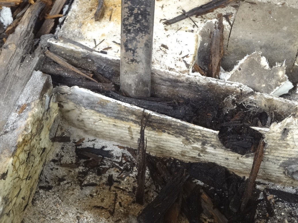

The floor is gone...it's not there! I have never seen a boat with a rotten floor that didn't also have rotten stringers. Fiberglass covers the stringers but it also holds in water. Running a drill down into the top of the stringers will tell the story. The drill will pull out dust or wet mush. That also goes for any/all other framing beneath the floor. Take an ice pick to the transom low on the inside: soft or hard? Chances are that all the wood will need to be stripped-out all the way to the keel.
This would be a BIG project...hundreds of hours and a few thousand dollars: stringers, framework, floor, fiberglassing, carpet, bodywork, painting, rechroming, engine, wiring, controls, trailer, etc. To me, this would be a "haul it away for free" boat.
This was what was left of a stringer wrapped in fiberglass. The top portion of fiberglass was cut away to expose the rotten wood inside.

Thanks Guys for both of your inputs !! This boat isn't mine.. I had thought of possibly buying it but after seeing it uncovered.. and how much work it was actually going to take, I decided to pass on it as I have more projects then I need at this time to take on a long term project to make this right.. I've seen others do miracles with boats looking worse but its more then I want to take on.. but if anyone is interested in it I can give the owners info to you..
