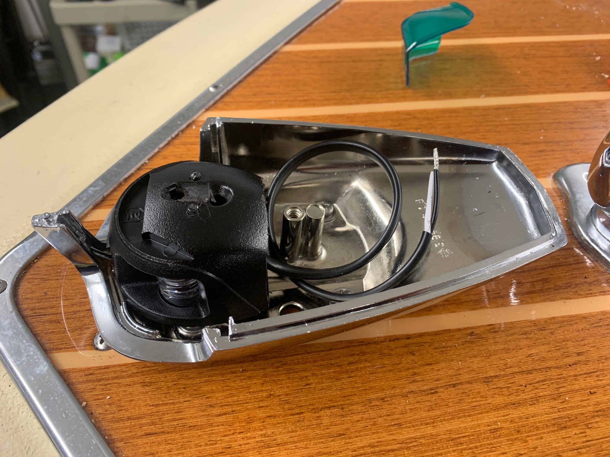

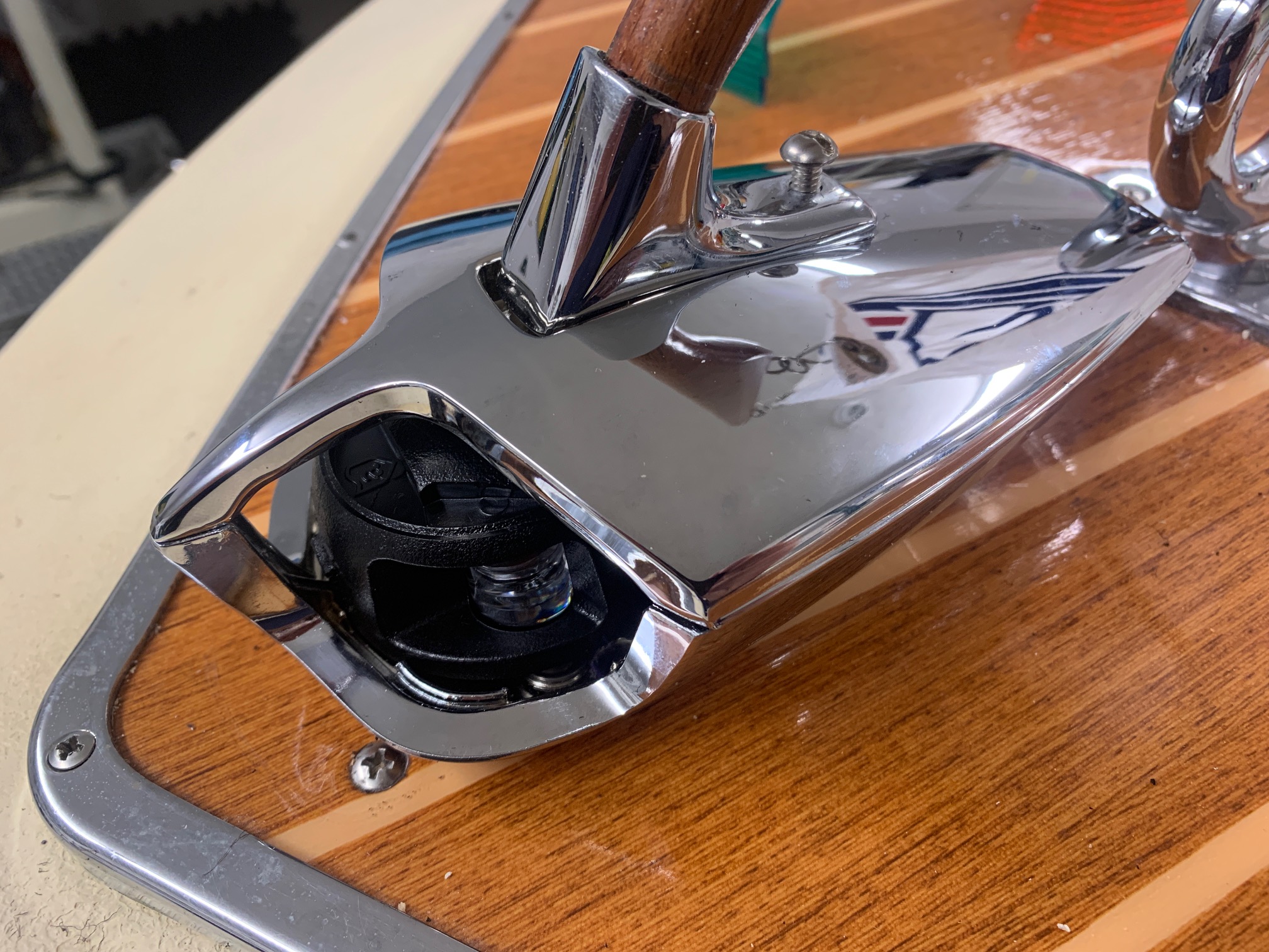

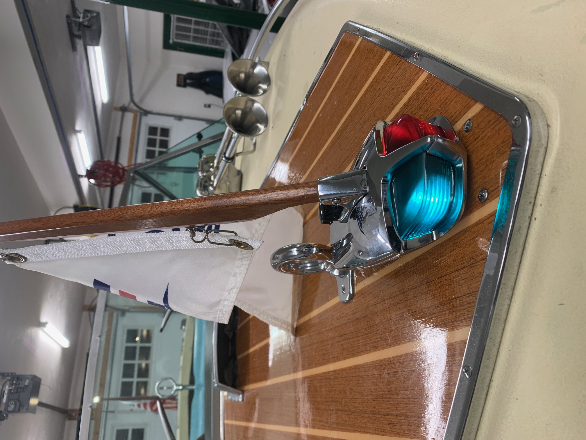

Found a reproduction original type bow light for the Resorter. Well made unit, but the bulb socket was held in using a wad of black rope caulk, like the 3m window/body sealer rope caulk. Disappointing, but at least the body and lenses were well made so I decided to do an LED conversion using an Attwood unit. Some planning, test fitting and time w/ a Dremel and modeling saws.
Came out quite well, the lights are bright and the pattern is compliant. I attached the Attwood base to the light body using 5200 and the LED unit attaches to the base w/ the original screw so there is no major disassembly to replace.
Here are some pics:

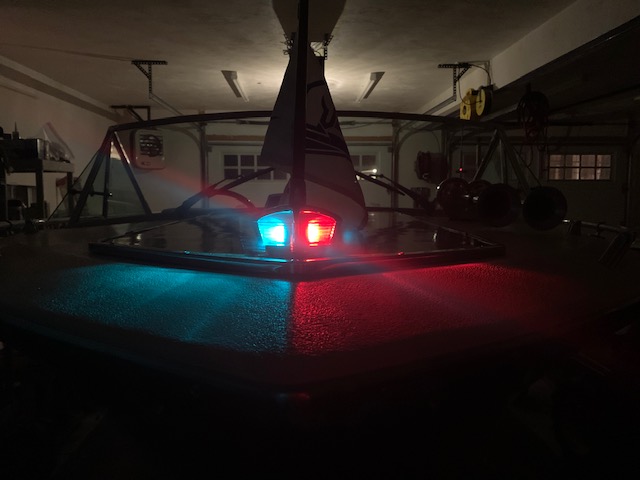

Obligatory night shot! (iPhone makes the green look blue)
