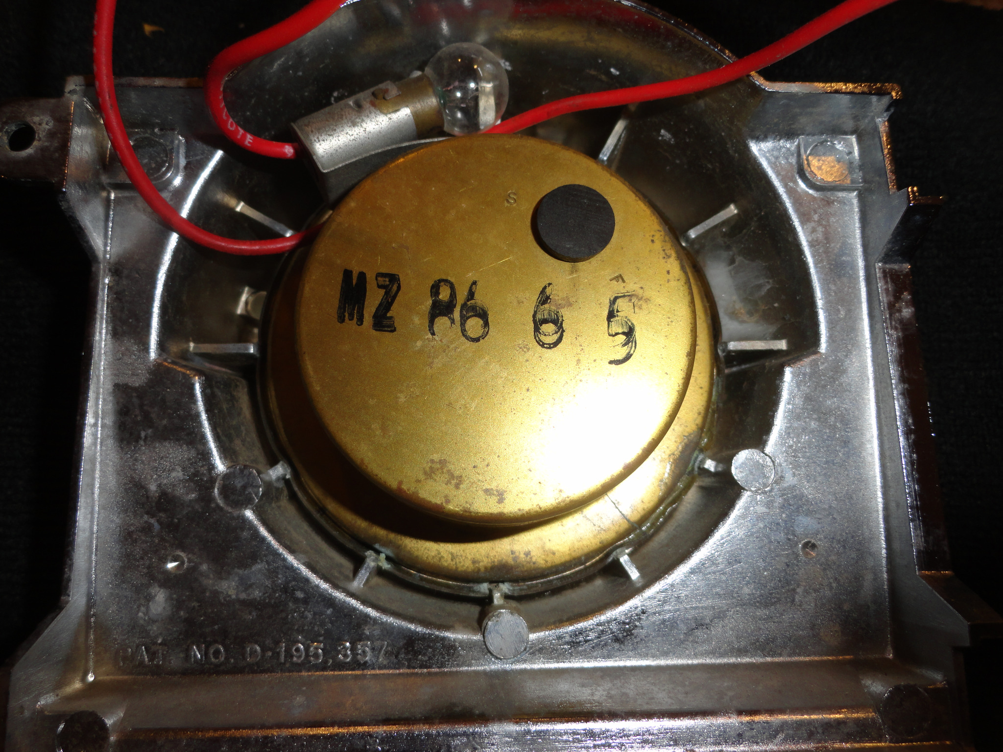

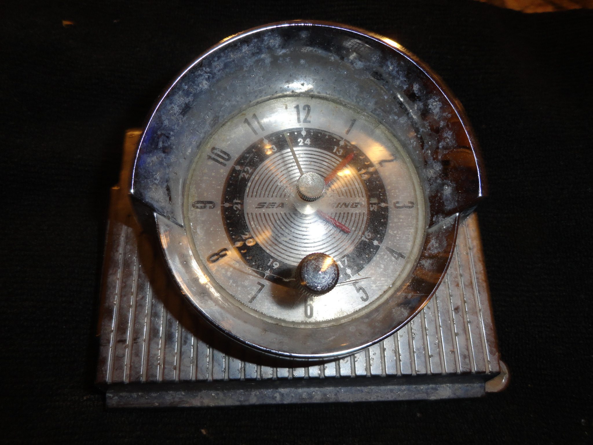

Hello every one. I have several Sea King gauges that are mounted in chrome bezel with end caps. I want to get chrome re-done. However, I cannot figure out how to safely remove the gauge. They appear to locked in. Any ideas
sea king gauges from 1960's 6 years 10 months ago #141455
Haven't worked on those particular gauges, but it appears to me the they're soldered and crimped at the tabs. It may be difficult to unsolder. I would try a tiny Dremel cut wheel at the solder joint and uncrimp, should then come out.
Good luck, and I hope your eyesight is better than mine! Cheers
