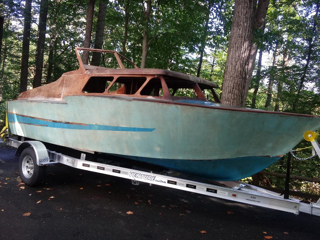

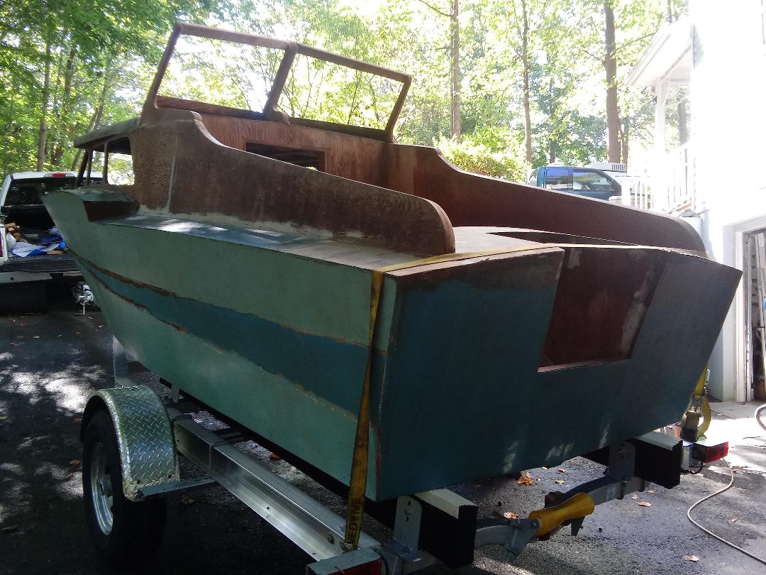

I am under way on a classic build and wanted to know others experience with Advantech. www.huberwood.com/advantech/products/advantech-sheathing - It came highly recommended so I bought 3 sheets 3/4 inch and it seems to be good stuff. I was leery about OSB but was assured it is better than marine ply and people have actually tested pieces of it submerged in water for years with no rot or delamination or significant change in weight. I plan on one piece for the floor and the rest to make a rear bench seat, front floor, front V-berth platform, steering helm box, etc... I will be spraying Spray-Lining and Coatings polyurea liner over everything with a very mild texture. Also for flotation - 2 part closed cell 200 board foot foam spray kit from Tiger 2 inches thick along all the sides sprayed over with the same liner polyurea and covered with sheething leaving a gap of 2 inches from the floor so if any water intrudes it will drain out eventually
