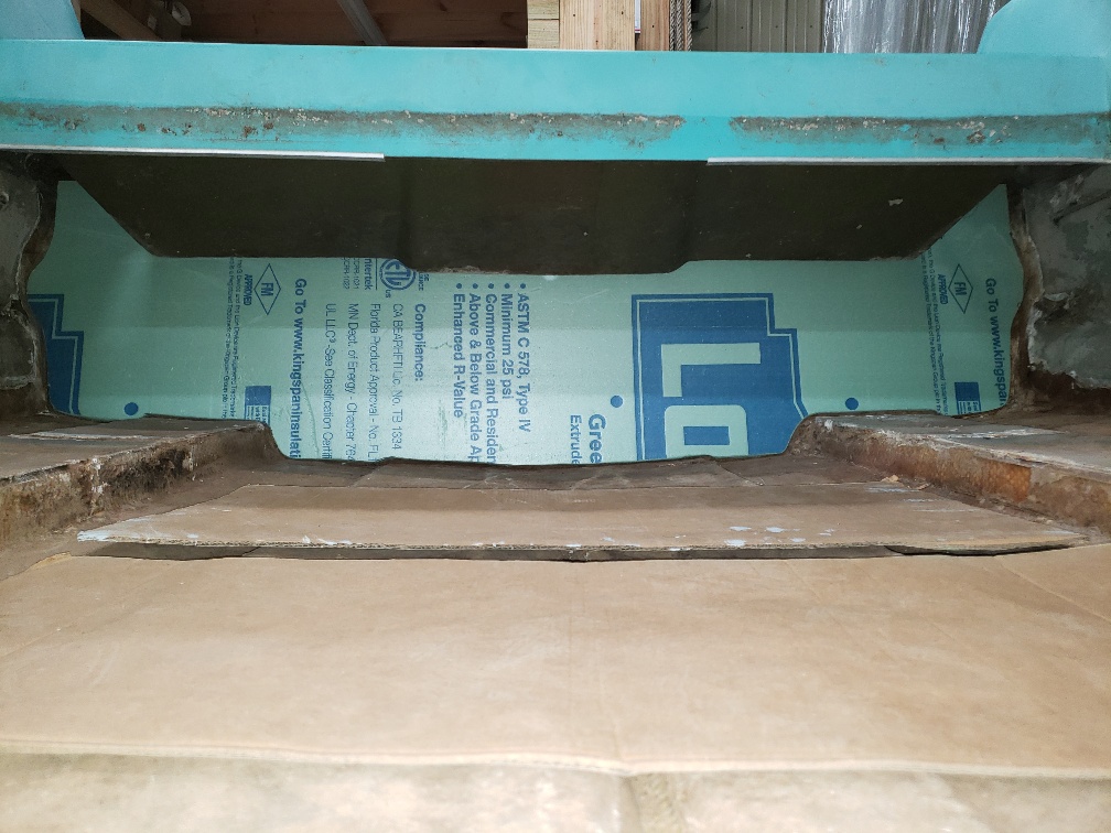

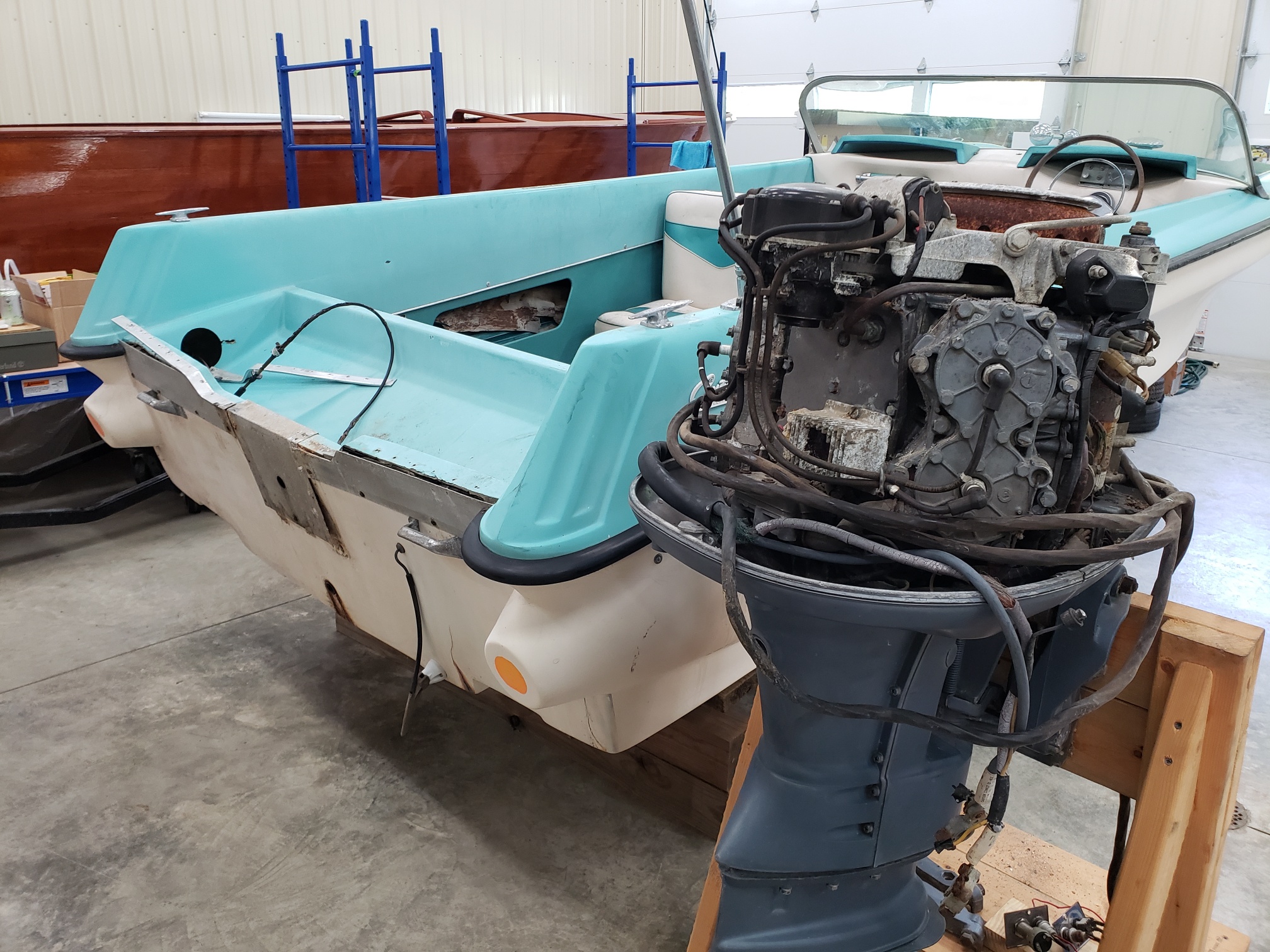

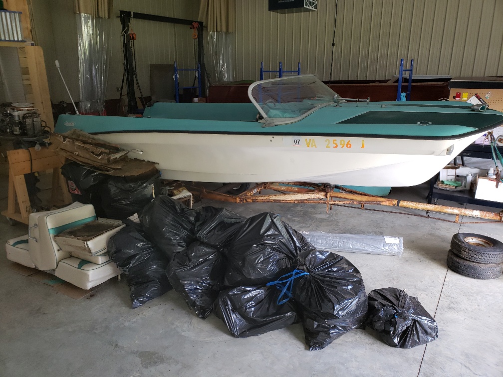

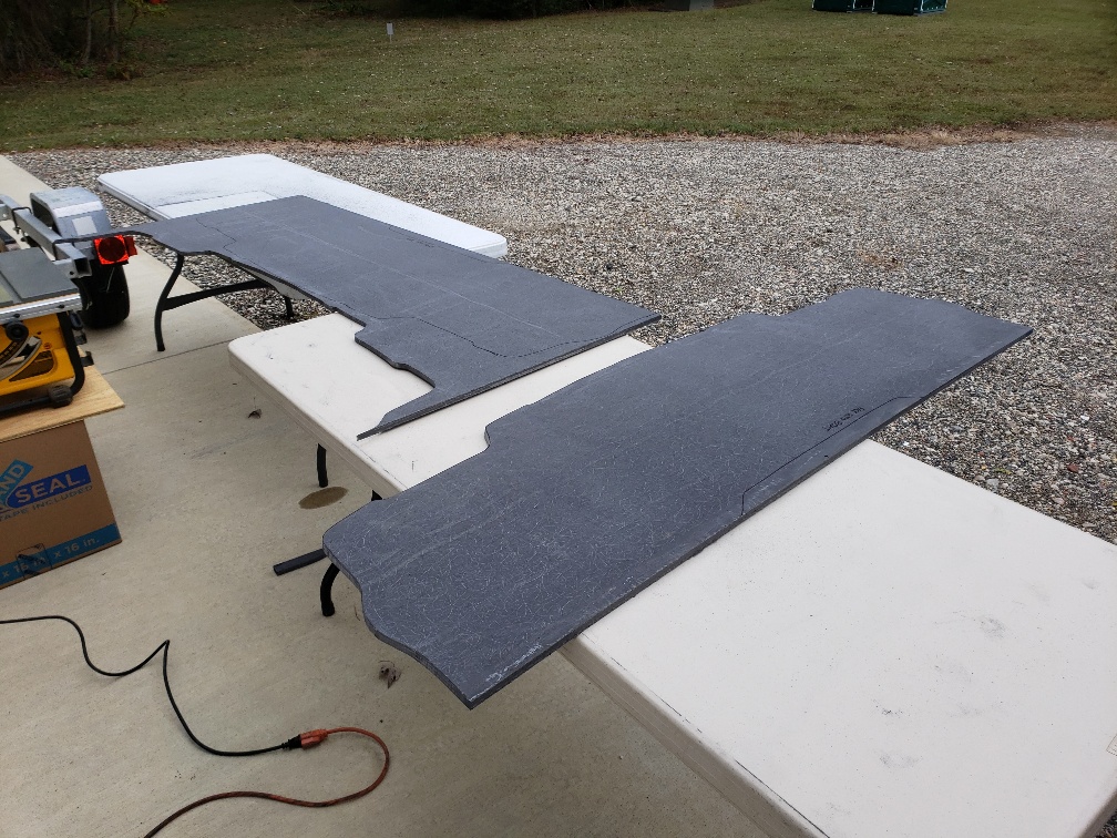

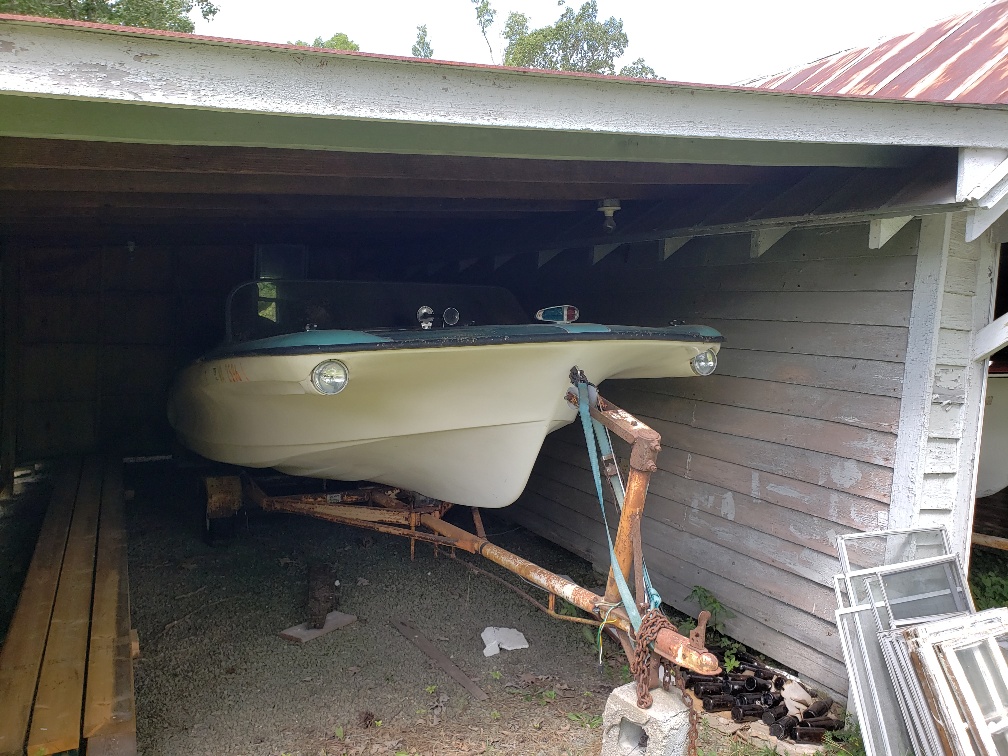

So I bit .....trying the Coosa for a 1964 Custom Craft Sunray. I spoke to my local supplier and they set me (our local ACBS Chapter) up as resto shop to allow some favorable price points and they have free delivery. Nice for the Coosa and they roll fiberglass cloth, not folded and stuffed in a box as I have received from others. (side note, I had used Seacast on the '62 Lake n' Sea but a different situation. Videos on this site and Lake n' Sea site)
There is 1.5" between the outer transom skin and the engine splash well so using 2 - 3/4" pieces would not have worked after a few layers of 1708. We decided to get 1 sheet of Bluewater 26 in 1/2" and then build out the outer sides to fit snug.

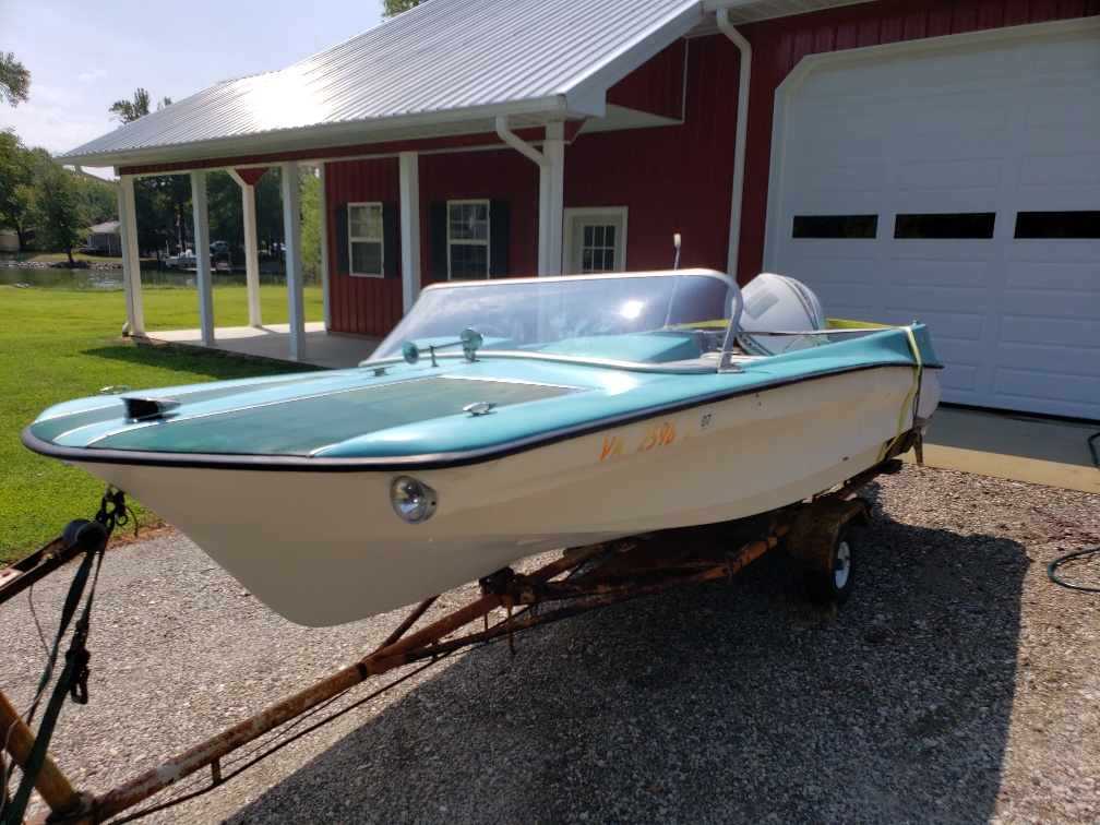

Pic 1 barn find
Pic 2 old trailer made it home

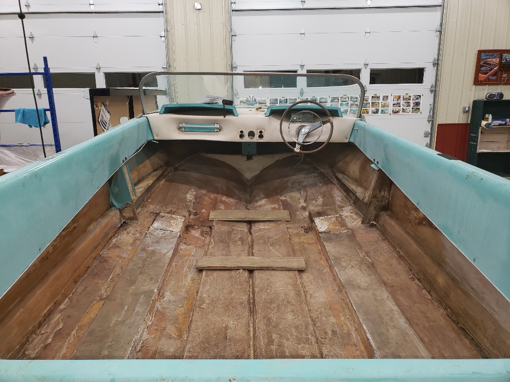

Pic 3 removing floor and wet foam
Pic 4 drying out

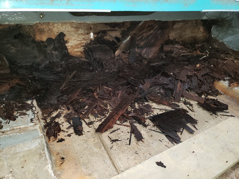

Pic 5 rotten transom removed
Pic 6 pounds of wet nasty floor, foam, transom and glass

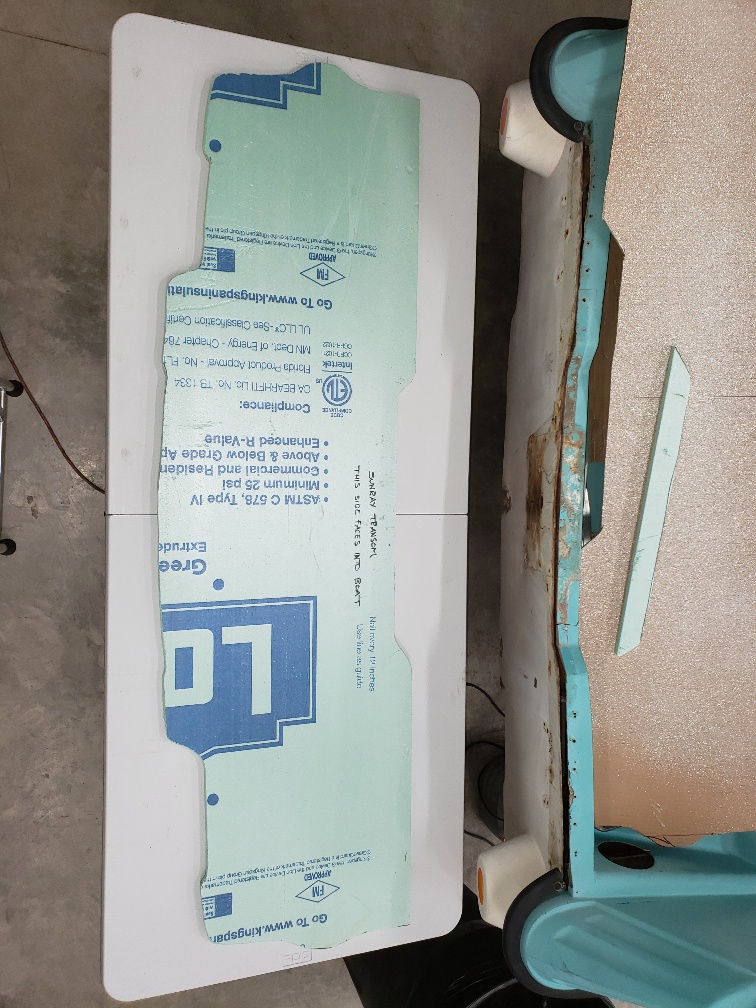

Pic 7 cardboard then more rigid foam template made
Pic 8 trial fit and figuring out how to swing 2 layers up in there

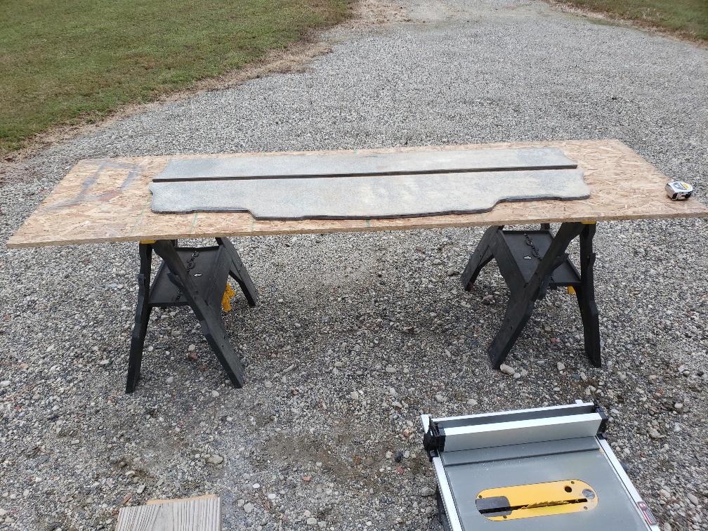

Pic 9 coosa cut
Pic 10 yes, there was a thin transom plate, and some additional trim to the left and right that covered an OPEN seam. perfect area for water to roll round the fins and drop in to soak the wood! a little extra glass and gel coat would have been easy at the time?
Probably should move this over to member projects from here. More to follow. My supplier agrees with Bruce. Vinylester would be fine for the 1708 lamination but for adhering the laminated boards to an unknown boat hull composition we'll go with epoxy. Epoxy is all encompassing over poly or vinylester, I'm told you can NOT use poly or vinyl over epoxy.
more to follow-
Eric

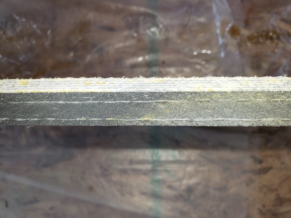

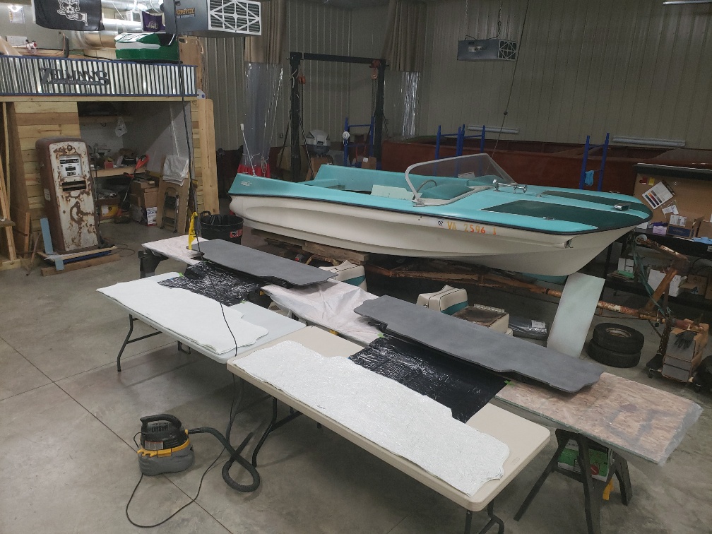

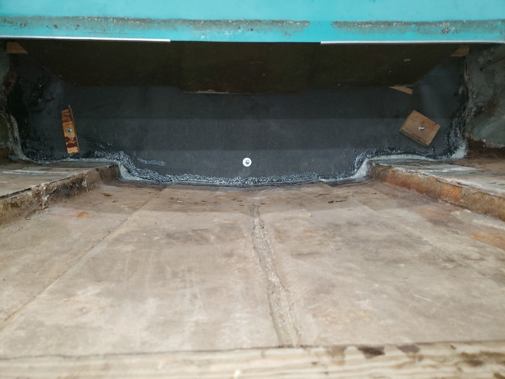

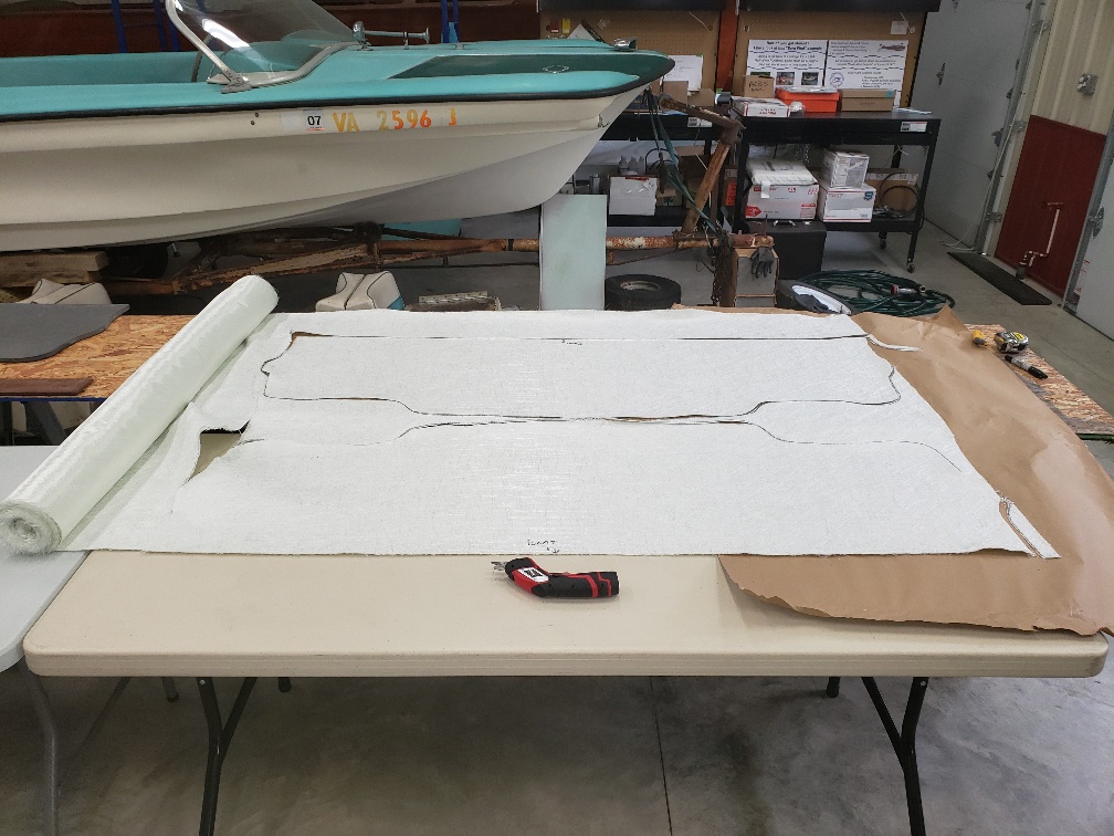

A little more progress on the Coosa transom in the '64 Sunray
Pic 19 pattern trace onto 1708 and cut
Pic 20 layers of 1708 ready to laminate with vinylester on Coosa
Pic 21 outer panel had enough swing to get up behind motor well but inner layer would have to be done in two sections
Pic 22 cross section of sliced inner section showing 1/4" of 1708 on 1/2" Coosa
Pic 23 outer single piece adhered to outer transom skin
Pic 24 bolts and boards used to pull tight along with clamps on the upper section
Epoxy was used to adhere the laminated board to the outer transom skin. This will be left to cure for a few days. Bolts that were used to pull the laminated board tight with the outer skin along the bottom were wrapped in painters taped so they could be easily knocked out once cured.
Eric
