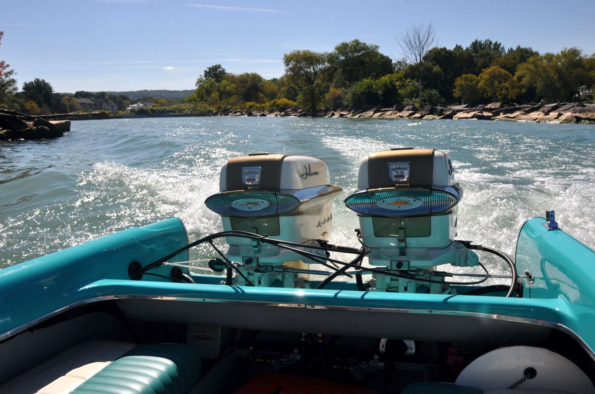

Hi Bill (it's been quite awhile),
Nice picture of your gorgeous work!
Personally, I much prefer a water pressure gauge, because if monitored, loss of water pressure precludes over-heating, giving time to "save" the engine. Slightly delayed results of a electric temperature gauge (it's sensing the outside of the cylinder head) is very often "too late" (for a piston(s)). Forums are for expressing opinions, that's mine. As to gauges/instruments, a stainless steel bezel is available, versus a black or white bezel, and seems far more "in keeping" with vintage chrome bezel gauges of the past. I will comment that I do not know where the best place on a "Big Twin" OMC to drill and tap to install a hose barb fitting to then connect the water pressure gauge tubing, as I do with most any Mercury outboard (Mercury started offering a water pressure gauge about 60 years ago).
Best,
Joe

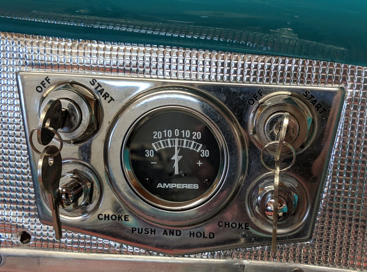

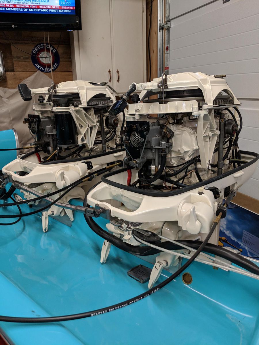

Thanks. Still hoping more help comes to Barnekalbill regarding his questions for that great looking twin rig. I apologize for getting off subject. Another question regarding your twins: can they both hook to the same battery and do they both provide charge to the battery without damaging each other’s charging system? As a kid in the 60s I thought I remember adults talking about only connecting the charging systems of only one of 2 Merc 65hp twins from 1965 so that it wouldn’t burn something up. I remember them always starting one motor first and saying they did that so it would start sending charge to the battery before the second motor was started. Just curious. Twin rigs alway catch my eye no matter big or small.
The following user(s) said Thank You: barnickelbill
Dr.Go!
58 Johnson 7 years 3 days ago #141173
  • ed-mc
  • Posts: 1472
  • Karma: 235
  • Thank you received: 130
I'm not familiar with dual-Merc charging issues, but the older ones are unregulated, 10 amps max. So if you had 2 charging systems connected to one battery, would it eventually boil the battery dry? I dunno, some folks have problems with that in a single-engine application! I'd say having 2 unregulated current-generating devices in parallel is just asking for trouble!
The old JohnRude BigTwins, if they have a charging system at all, would have generators. You probably wouldn't want 2 generators, with their respective voltage regulators, in parallel on one battery. Not sure if they would fight each other but I dunno if I'd take the chance of burning up those expensive DC regulators!
One generator charging a single battery for dual motors would be Plenty Good. Or, if you could stand the extra weight and both engines have generators, use separate batteries.
With a single-battery setup, you wouldn't want to start both at the same time, though, due to current draw.
58 Johnson 7 years 3 days ago #141175
Yes, both motors connect to the same battery, only one motor has the generator & voltage regulator. If they both had them, they would fight each other, I believe smoke would be involved. I do start the motor with the generator first, but doubt it makes much difference, as the generator doesn't charge very quickly like today's alternators. You can't really start both at the same time, as you have to turn the key and push the choke button at the same time, I would run out of fingers.
Thanks for the help
Cheers
Bill

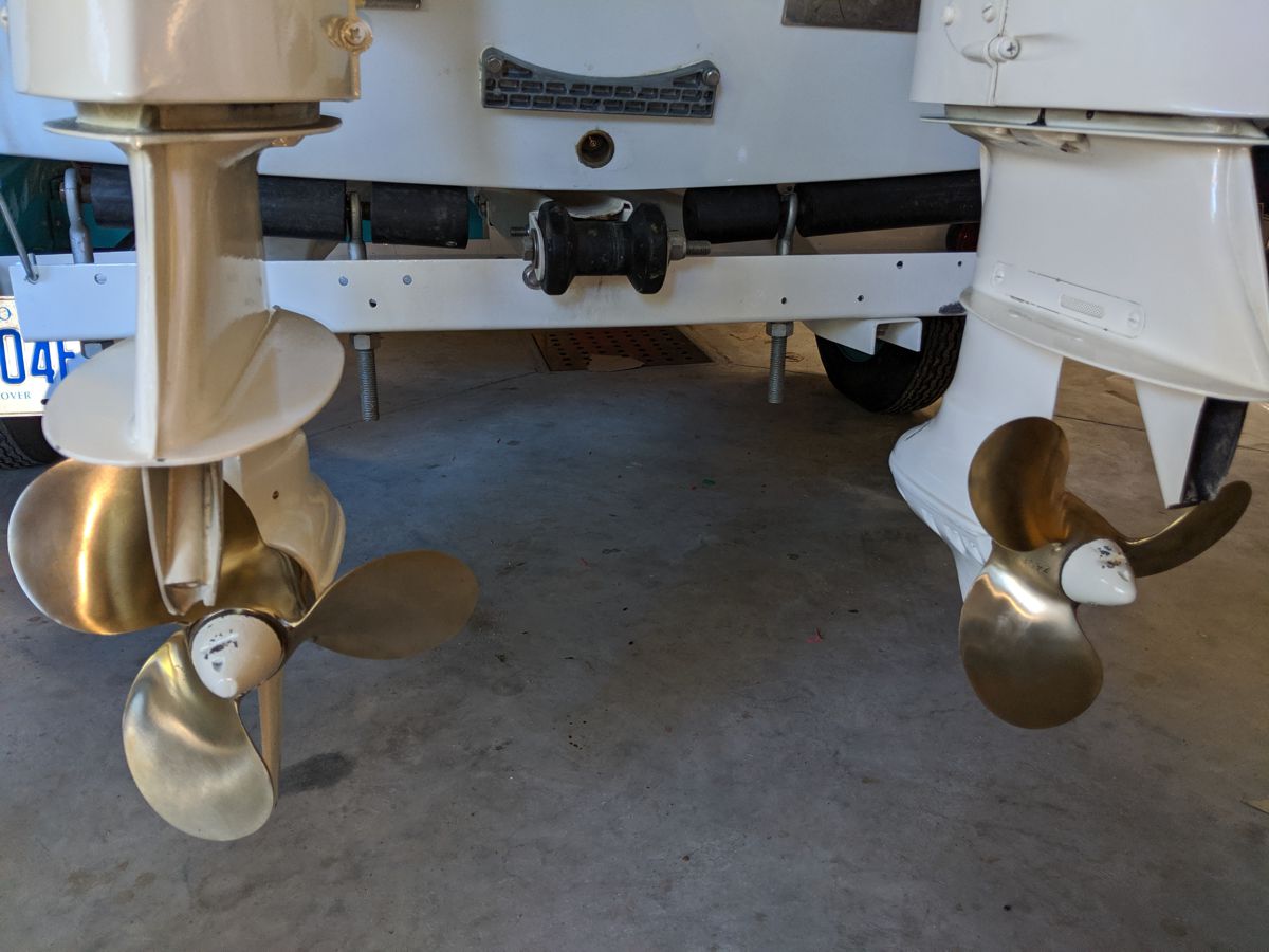

Thanks guys, the motors are getting even purtier. A buddy stopped by, said he had something for me. Opened the box to find two re manufactured bronze props that he knew I was looking for. A little buffing, and paint the retainers black and we're good to go!
Friends like that are hard to find!
Cheers, I'm still smiling
Bill

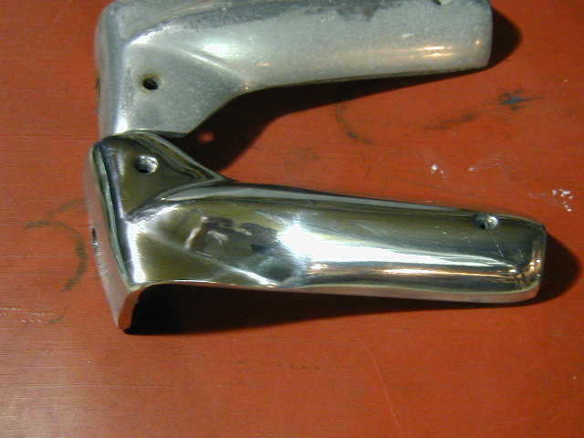

Great friend! That looks so good. I need to read up or find a good video to learn how to polish up a prop like that. I have one shiny and 3 dull.
Dr.Go!
58 Johnson 7 years 1 day ago #141195
I can post some pics if you like when I get around to polishing them. Polishing is pretty easy, but the worse they are, the more time it takes.
Cheers
Bill
