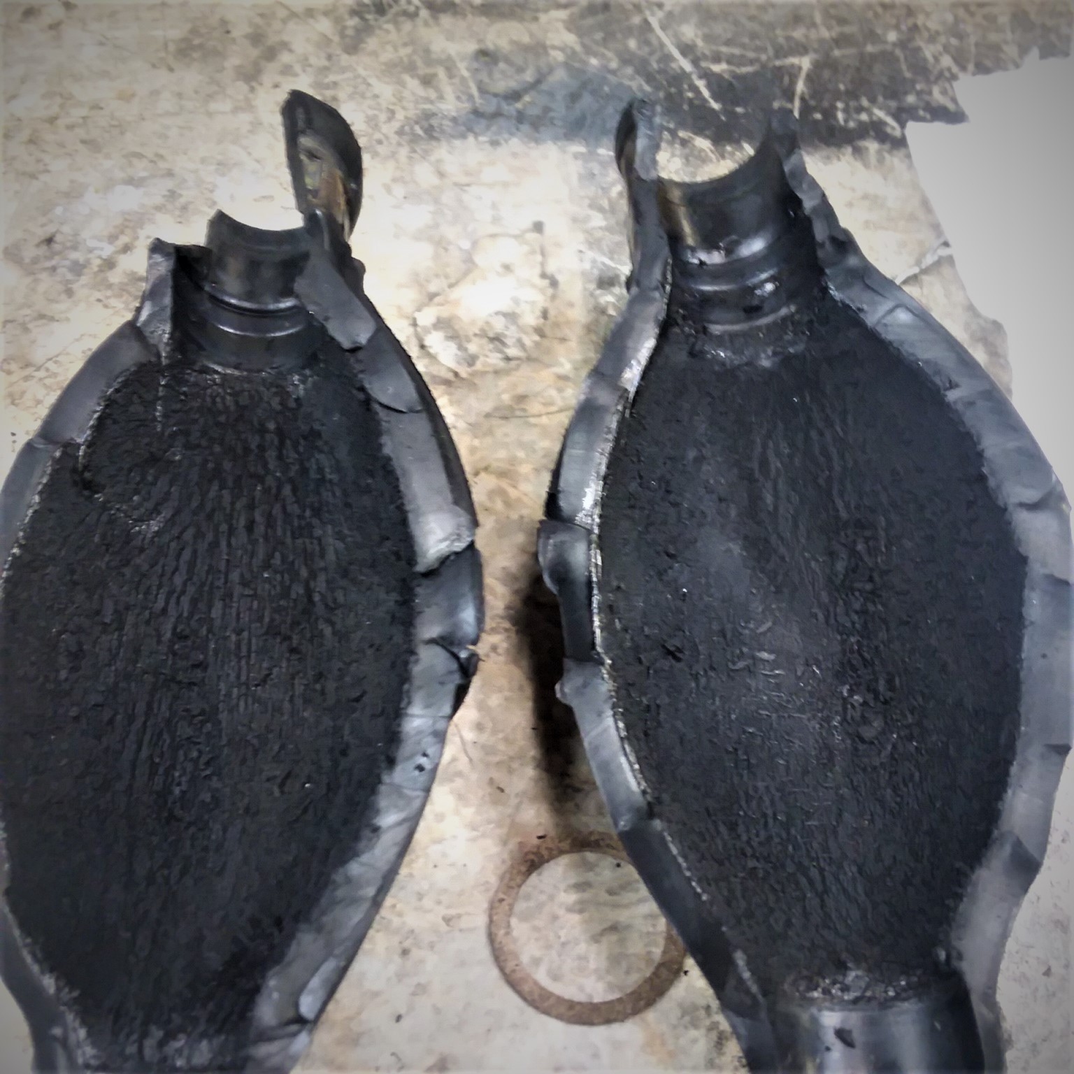

I see this periodically, even though the owner is adamant he has not used ethanol,...Since he has owned the boat.
It is just another thing to consider replacing if you "think" your fuel system has had ethanol in it in the past.
Besides fuel hoses, fuel pump valves and diaphragms, carburetor floats, float needles and seats, seals, o-rings, etc ,etc, etc,...Check out what the evil stuff does to the prime bulb.
As you squeeze the bulb particles similar in appearance to black pepper break free and head for your filters & carburetors.
Just something else to add to your list of things to replace when purifying your fuel system.
doc

Dr_Frankenmerc wrote: I see this periodically, even though the owner is adamant he has not used ethanol,...Since he has owned the boat.
doc
Good catch. As I was going through my boat and removing the 35 gal Auxillary tank in it (?!?!?!? Planning on taking your Catalina to Hawaii????) I found a brand new fuel line setup still in plastic. But your pic is also why I always run one of those clear plastic fuel filter jobbies about 6" upstream of the motor.

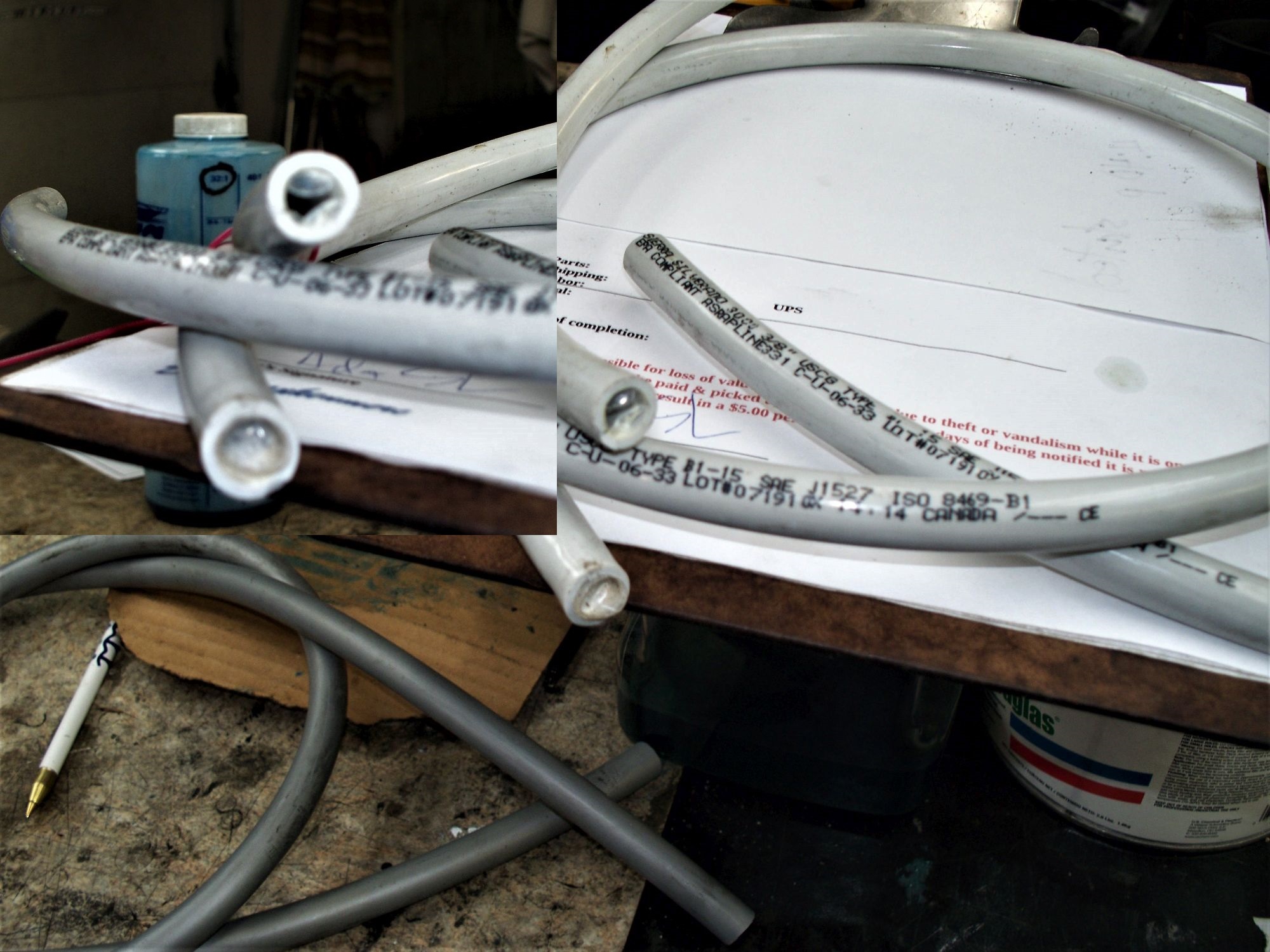

Well,...SOME of the changes to fuel hose hasn't resulted in a better product.
doc
More ethanol carnage to be aware of 7 years 1 month ago #140692
I've run into that problem. Seems the inner lining of the hose separates from the outside and collapses blocking flow.
There is a clear blue colored fuel line I used before but like Ike said...can't remember where I got it, probably from an auto store. The clear plastic line sold in box stores bulk works but I don't know what the safety standards are for it and it stiffens up after a year or so.

Look at the label on the hose. It says USCG type A1-15 . That's the new (really new) EPA hose. The blue liner was meant to reduce permeation of evaporative emissions to the new (actually since 2012) EPA standard. Prior to that the hose jut said USCG type A1. The difference is the rate of permeation. What that all means is that some gasoline vapors actually migrate through the wall of the hose into the atmosphere. The old Coast Guard standard was only intended to keep the amount way below the lower explosive limit which was 300 mg per 24 hr. EPA reduced that to 15 mg per 24 hr. Most hose manufacturers just added an inner lining which made the hose a lot stiffer and blocked vapors from permeating through the walls.
I don't know if you can still find the older hose labeled USCG Type A1. ( there is also USCG Type B1 but that is a different issue) . The A1 is the alcohol resistant hose that was introduced in the late 1980's.
As far as the clear plastic hose, it should never be used on an inboard. It doesn't meet any specs for fire resistance. A1 hose has to withstand a fire for 2 1/2 minutes. (B1 does not) And the clear stuff doesn't meet any of the other standards for EPA or SAE marine hose. I can however be used on outboards because the USCG standards don't apply to outboards. But the ABYC standards do. Oddly enough the OEM hose and bulbs that come with your outboards are not regulated by the Coast Guard. They are now regulated by EPA for emissions, but they do not have to meet USCG standards for fire resistance. Reality, most of them met at least the B1 standard which is the same as A1 except for the fire resistance and were treated for UV resistance.
Probably more than you ever wanted to know about marine hose. Oh yeah, all those other numbers have meaning too. If you want to know?
