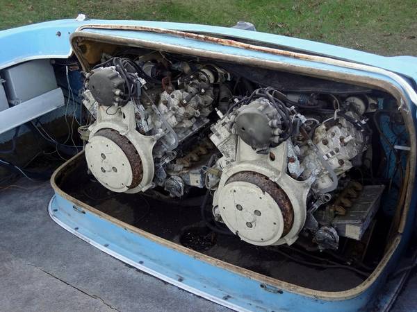

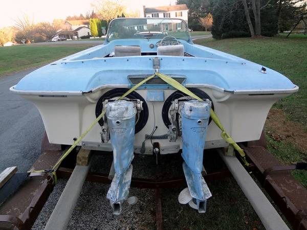

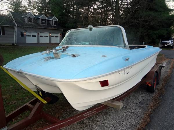

I know all about them. I own two (1 is for sale), sold a third and am currently restoring a 4th. The engines are 88 HP, 2-cycle OMC outboard engines turned on their sides. Originally, oil was fed from a separate tank to mix with the gas. Don't ever trust that system...no oil, no engine! Get rid of it and use premixed gas. The windshield is classic. It opens with an electric motor mounted under the dash. The glass is actually the rear window of a Studebaker. Don't attempt to run the engines with the fuel tanks as received. Remove them and take them to a radiator shop and have them cooked-out.
I have all the parts available that you will ever need, including spare engines. As far as I've been able to tell, there are no Dual Deluxes up and running anywhere. Got any photos?

The glass is actually the rear window of a Studebaker........What year and model of car?........are they reproduced at all?

I believe it's an early 1960s Studebaker Lark windshield but if you need a windshield, I have an extra one.

hey thanks for replying....its not that I NEED one lol.....mine has a scratch where wiper went on it and was wondering what these were off of.....thanks for letting me know!.......I like xtra parts, what does a used one go for and where are you located?
