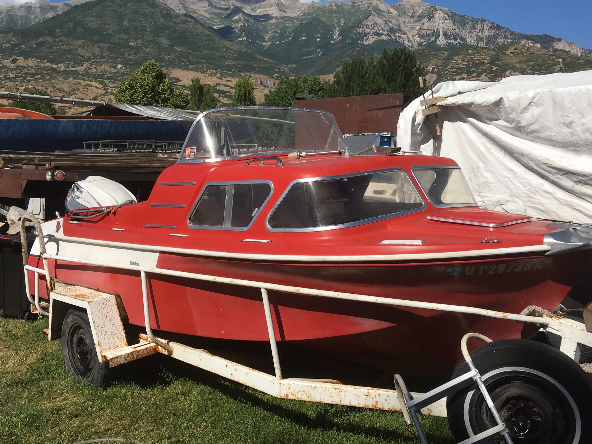

Hi all. After fighting with a crazy "carb problem" on my little sports car (turned out to be a failing coil) I'm finally ready to turn my attention to my long-neglected Catalina. Boat is in decent shape, just needs some TLC/Elbow Grease, but the 'rude seems to have a jammed shifting mechanism. Runs great, just won't shift into F&R.

More later. Gotta strike while the iron is hot. Goal for the day: Troubleshoot the controls ('60 Speedifour. Non-electric)

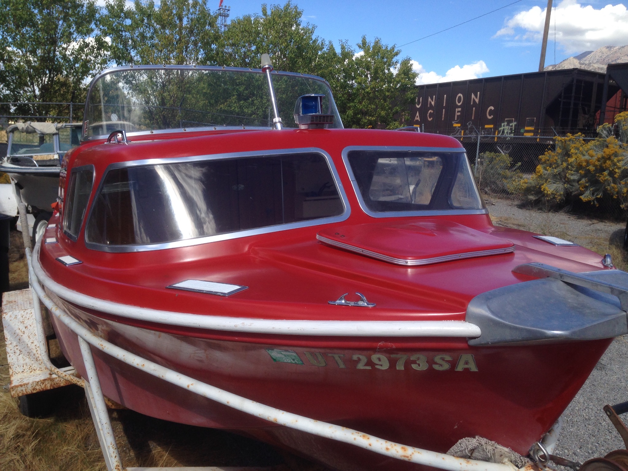

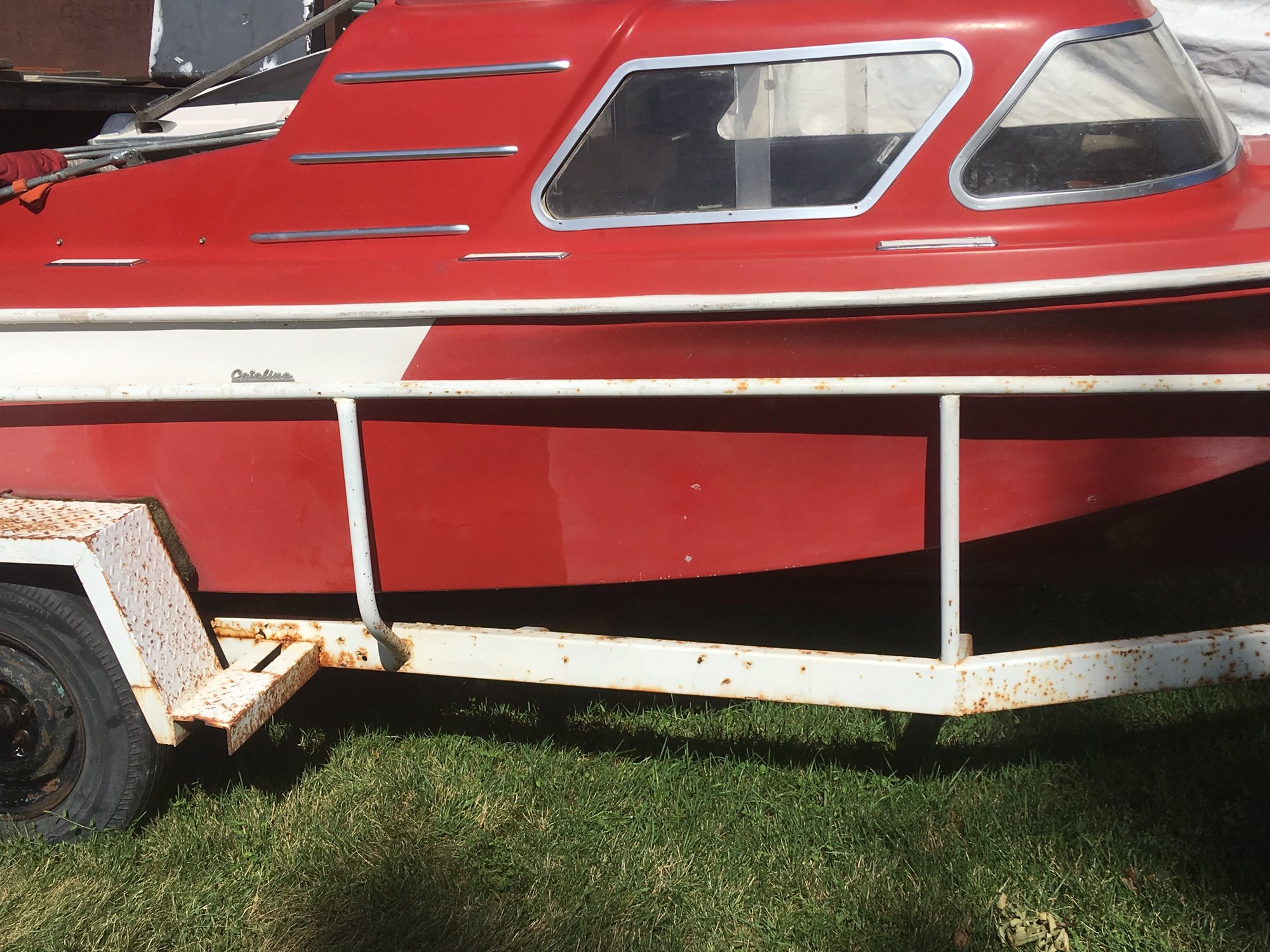

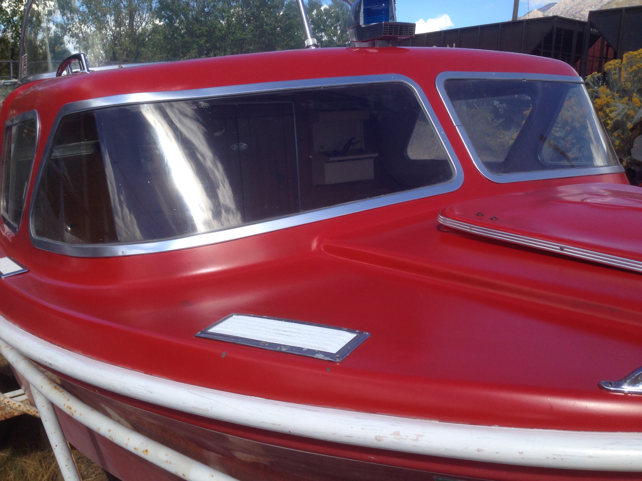

A couple more for the road.
"Long Time Lurker, First Tie Poster" 7 years 2 months ago #140579
They said it couldn’t be done, they said it shouldn’t be done. They said we’d kill the whales, they said we’d eat the dolphins, but two years on, my Vaseline treatment worked a treat on the Catalina. (The two above were right after I finished with the petroleum jelly)

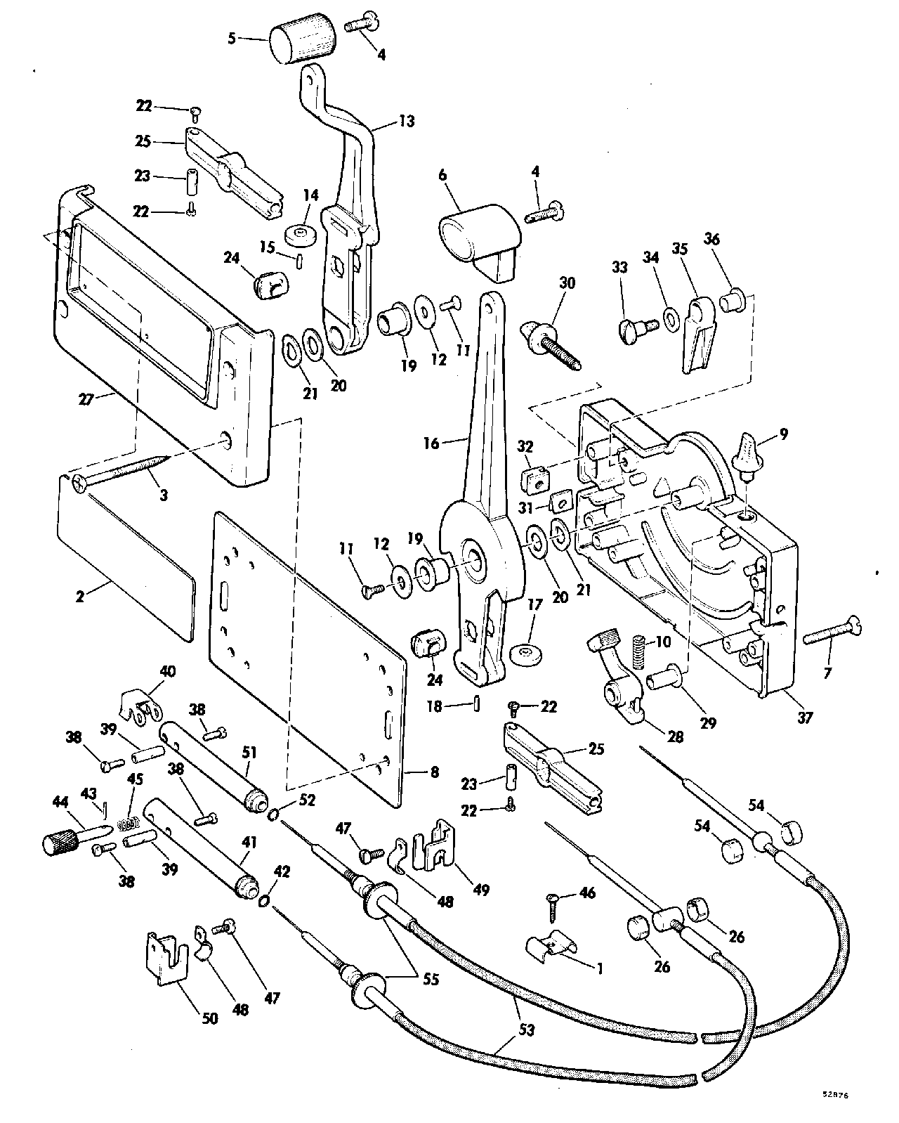

Thanks, Sabre. That gives a good place to start. All I know us I took it to a place that said they worked on vintage engines, and the said the bottom end needed to be rebuilt. On further reflection, I realized they just didn't want to work on it. I watched a couple of Dangar Boat videos on newer ,rudes last night and have a pretty clear picture of what needs to happen. I'll check it out today.
One the Simplex: Gears? We don't need no stinking gears.

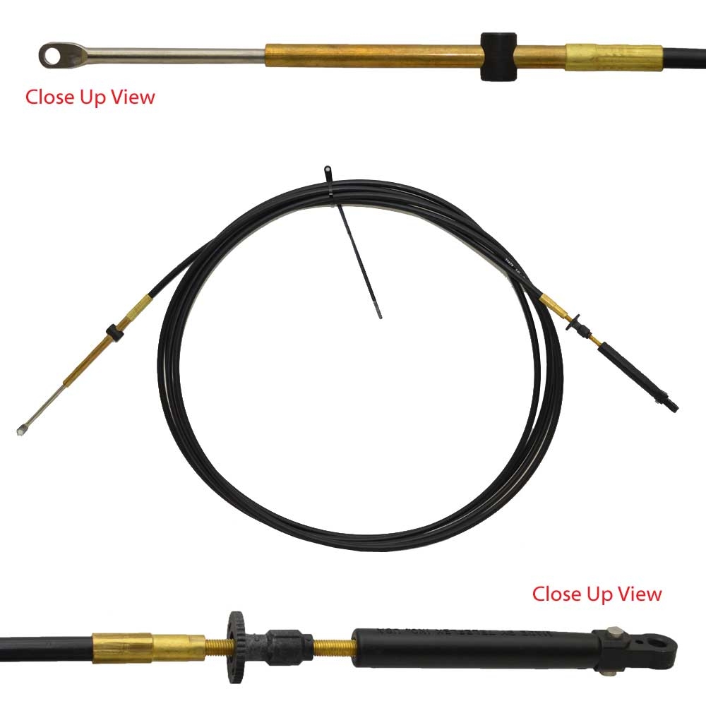

Unless you mean the little barrels that go between the spacers (Nos 26-54) that thread on the threaded rods. I probably did change the cable length on the shifter because it had pulled out (trying to get it to go into gear probably) so when I reattached it, I made sure it was all the way to the far end of the ferrule (22/23) but I from my knowlege of motorcycle cables, I figured that was what the thumb screw (55) was for. And for the bad news: Someone's had it apart before. It's missing the attachment screw (11) on the gear shift side. From the wear on the center plate(8) I assumed it was just held in place by the plate. It was also missing the shims (26) on the throttle shift side, so I fabricated a couple out of sheet copper to match the throttle side (54)
I guess I'm going to have to see if I can find a similar screw at Ace and grind it to fit. I'd guess chances of finding replacement parts (other than the cables) are next to nil.
Anyway, I hope that makes sense. Btw, other than the cable attachment itself, the only thing I changed was dousing the thumbscrews with some DeepCreep and working them back and forth a bit to free them up. Now they're "thumbscrews," not "vise grip" screws. Lol.. AFAIK, I got them back in the same position.
I just noticed something on this picture. It looks like that barrel is fixed on a brass tube. On my cables, their threaded rod and the barrel can be adjusted both ways.
