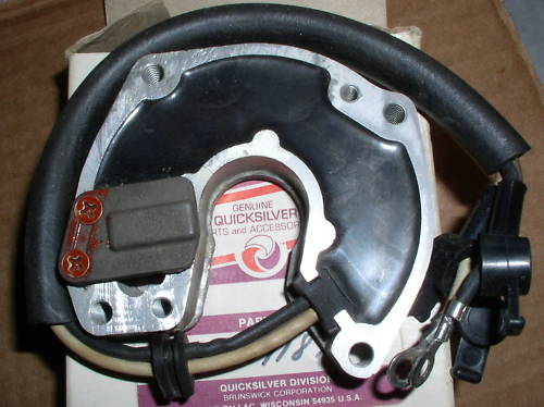

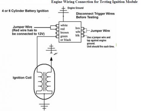

Yes there is a test that bypasses the trigger in the distributor. See the attached diagram. It shows how you disconnect the (3) trigger wires from the distributor to the switch box. Then you jumper (2) terminals on that side and ground the 3rd. If you get spark out of the coil, the trigger is bad. One thing to keep in mind on this CDI system is that the red wire on the other side of the switchbox is always hot. The white wire is energized only when the key is turned to "ON" or "START".
So check for voltage at both of those terminals with the key on. If you have power there, then that's not the issue and you can proceed with the test.
The trigger assy in the 1250 distributor, fortunately, is replaceable. It's the same trigger used in various Mercruiser applications, so there are still some kicking around. Some 650 models used the same trigger, so that's a resource as well.

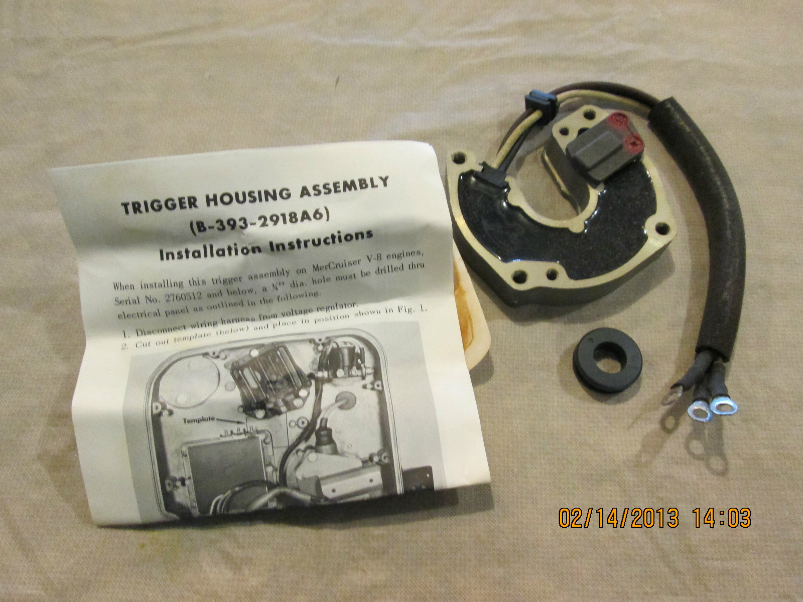

Here's a load of distributor parts on eBay for $75, including a trigger assy with bad wiring, but it looks like the internal wiring is still good and could have new lengths of wire spliced-in. If you were to do that, you'd want to be sure to solder the splice for good connection.
https:// www. ebay. com /itm/MERCURY-Kiekhaefer-1250-125HP-Outboard-DISTRIBUTOR-CAP-ROTOR-TRIGGER-393-1927A/264281094034?hash=item3d88617792:g:aqMAAOSwCtJaD2wx
HTH..........ed

Hi, Dave, you might want to check with the seller and maybe get a better pic of the internal wiring before committing. The trigger housing is indeed held in by those 4 bolts and will pull down for servicing. Be careful with the rotor assy; the shaft, rotor, and "chopper" disc are one integral unit and can't be separated without destroying them. The rotor shaft bearing is retained in the housing by the trigger. Once you pull the trigger's mounting screws, you can pull the trigger and rotor assy as one, until the rotor shaft bearing clears the housing. Then you can safely separate the rotor from the trigger.
Be very very careful when reassembling, you'll note how the rotor rides thru the pickup on the trigger. That little piece of pickup metal is quite fragile and should never be pried upon.

Distributor showed-up yesterday. I removed the trigger housing and installed it in place of the suspect one. One bolt tough to get at but got it done. Hooked up a battery, turned the key.....spark! Awesome.
Thank you ed-mc for your guidance....much appreciated. A lot closer now to getting the Power Cat on the water this year. I see I will need to replace the wiring in the future...but patched it up enough to get it on the water.

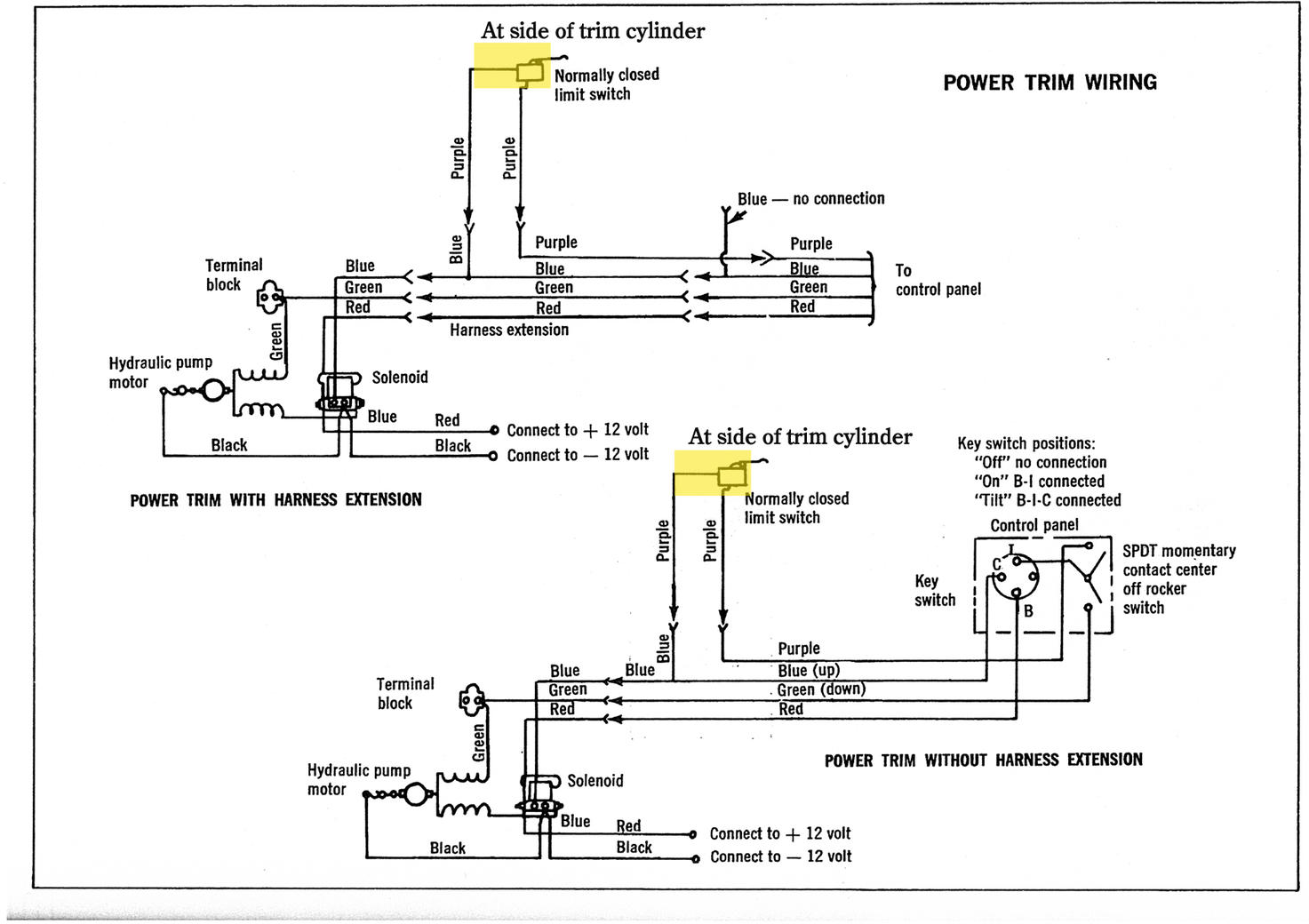

PT&T-wise, if you can get the trim motor to run, and the pump is good, the rams should go in-and-out. I've attached some service info and a wiring diagram for the single-solenoid system (most common on outboards), maybe that'll help.
