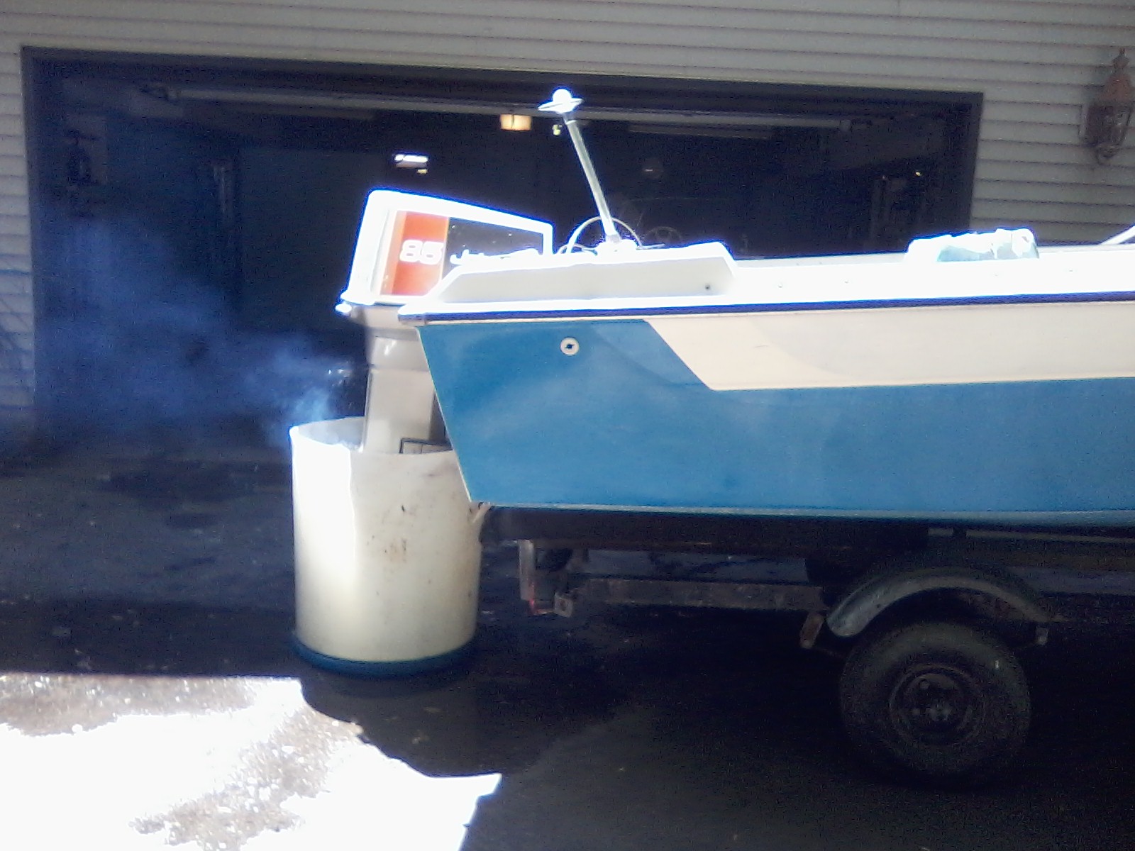

Thermostat question 7 years 2 months ago #140443
This is how happy I am.
Thermostat came Friday afternoon, 10 minutes to put it in. Finally got to run the motor today.
Smoke is from a good dose of SeaFoam.
Going for a WOT run in the evening when the weekend warriors are all home.
