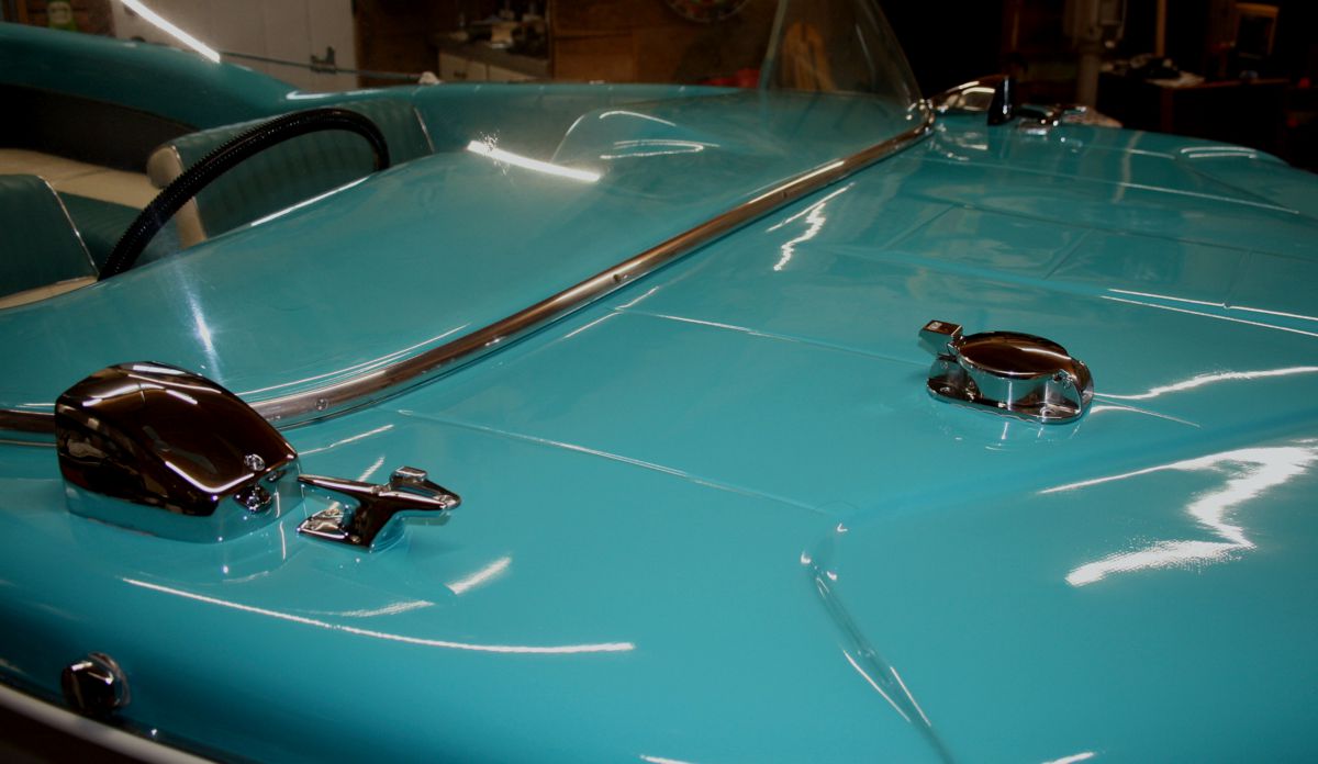

Hey Cal,
When I read this post I had the same vision.
Hello Ike,
Good info.
I questioned the owner of this Larson regarding the cowl vents.
He said they are original and required because the space below the splash well which stows batteries and gas tanks is closed off with a door.
Thanks,
Terry

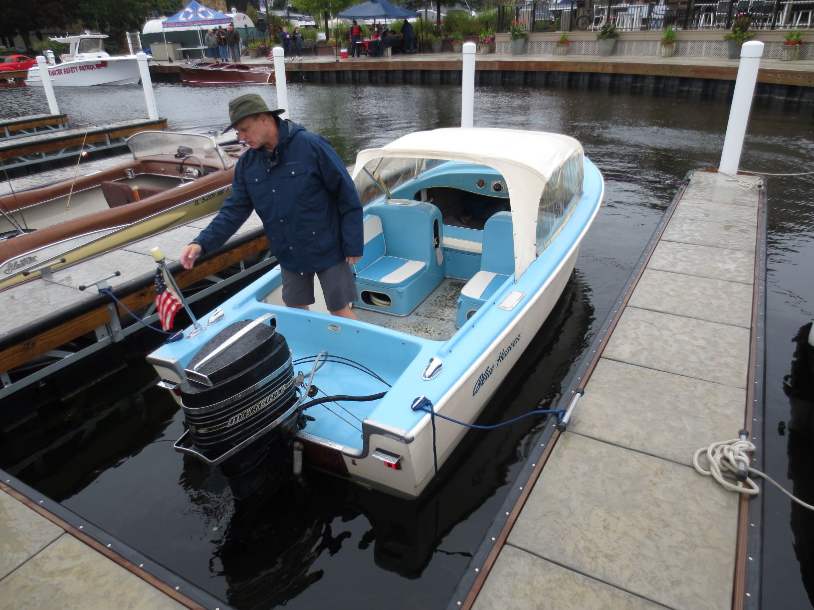

My '59 Thompson Sea Lancer has the vent scoops from the dealer/factory. I have 2 12 gallon tanks under the back seat which is enclosed, but there is open area on both sides of the splash well. With the battery and the power trim pump under there also they probably aren't necessary but it doesn't hurt.

Aren’t they typically facing opposite directions? Every outboard boat I had since 70s did, but maybe because they had more restrictions on both sides of seat internally. Maybe when skirted with openings on each side, perhaps they forced air into both sides in from the deck and out both sides of the skirt. I thought it was better to face one aft so that fumes exit out of the hull faster . Having 2 face forward like in the picture would seem to force fumes into the open hull before diluting and exiting the passenger hull area. Just wondering why both in the picture faced forward.

Actually it doesn't matter. In the mid 80's the USCG, ABYC, and NMMA did a study of natural ventilation. The findings were it doesn't matter which way the vents are facing because there are a lot of variables. If the boat is moving against the wind then the one facing forward is the intake and the one facing aft is the exhaust. But if you're going downwind then the opposite applies. If the boat is standing still, the prevailing wind determines which is the intake and exhaust. If no wind, then the temperature determines which is intake and exhaust due to the temperature differential outside and inside the boat. And, if you have a blower running then the one the blower is on is the exhaust. Before that most boatbuilders put one facing forward and one facing aft. Now they do whatever looks good. On my boat I have two facing forward and one big vent facing aft that combines a natural vent and a blower exhaust.
