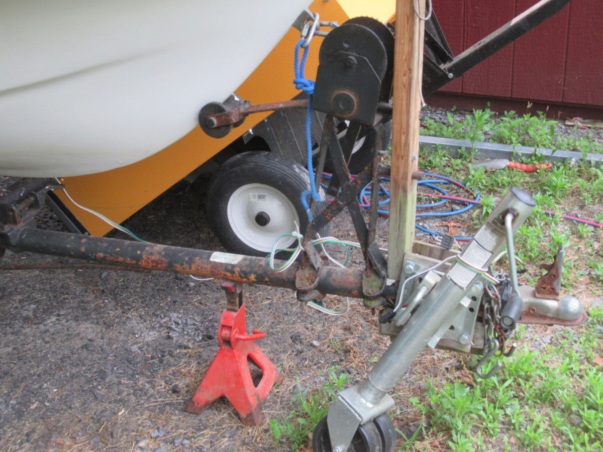

Second question - is there such a thing as a trailer jack for a round frame? I believe this is as classic a trailer as the boat, and it has a round frame. You can see how the P.O. jury-rigged one that does not work well and makes the whole rig dangerous when using it. The winch post is adapted to a round frame, why not a trailer jack?

The round trailer tongue can be a real pain when it comes to a tongue wheel. After several mishaps with the clamp twisting on my Balko tongue I tried to through bolt it but found out the swivel would hit the bolt head, even a carriage bolt wouldn't fit. Finally wound up just tacking a few welds on it. Scary when your standing in the boat while it's on the trailer and all of a sudden the thing decides to take a tumble :woohoo:

For the trailer ? Maybe try (2) pieces of C channel with the flanges toward the pipe, welded to each side of the Outside diameter of the pipe to give you two flats ?

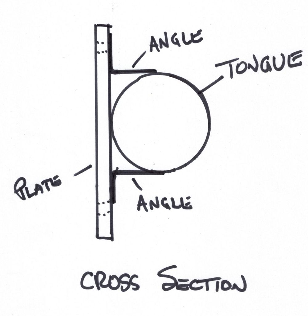

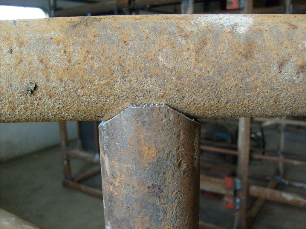

Looks like you have the paint thing sorted, as far as the trailer jack, I would go with a pipe mount swivel jack. That would require a coped tee joint, but I think it would look the best. Alternatively, a piece of 3/16 or 1/4" plate, cut and drilled to match existing jack and welded to the tongue with a couple angle iron supports.
