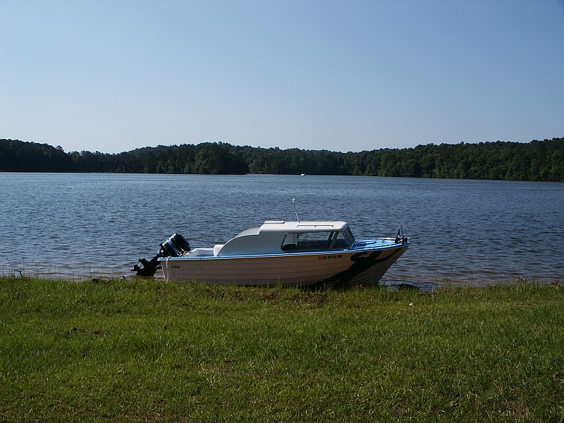

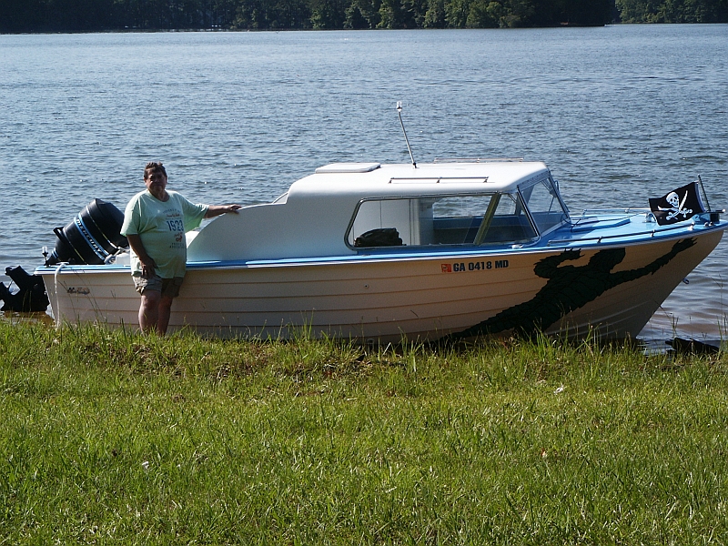

ok went and bought 200.00 in life jackets rope a seat cushion 35.00 and other things to get the boat on the water 98.00 in non ethanol gas 20.00 in 2 stroke oil 10.00 in additives and 20.00 in drinks and crackers. put it in about 10.00 Saturday and first thing there were a lot of tree limbs Logs bushes sticks all kind of debris from up river we are in West Point now. so we tried to steer clear and it was getting harder and harder so we stopped next to a beach for a few minutes. pushed off and trimmed the motor a little and started back the motor would not pick up power. revved the engine and it felt like the gears were slipping but at low speed we could putt along but trying to come up in speed it wasn't really surging but like your trimming the motor in and out of the water. thought of mud i picked up when we stopped but we didn't churn up any silt. limped back loaded the boat and saw the front of the foot all chipped up paint was chipped and the prop had scratch marks on it. the debris was bad ,several other boats came back in with us. now i am worried about what i might have done while in the debris field. i talked to Joe so i am looking at several things
but that's not what i wanted my first trip out to be. note we were doing good for awhile when we first started out then i kept feeling objects hitting the bottom of the boat and now probably the foot and prop. i went online and read articles about the river rising and floating all the dead stuff down stream and dumping into the lake reports of several lower units tore up and people wondering if insurance is going to pay. well ill find out whats wrong and eventually fix it and try again.
