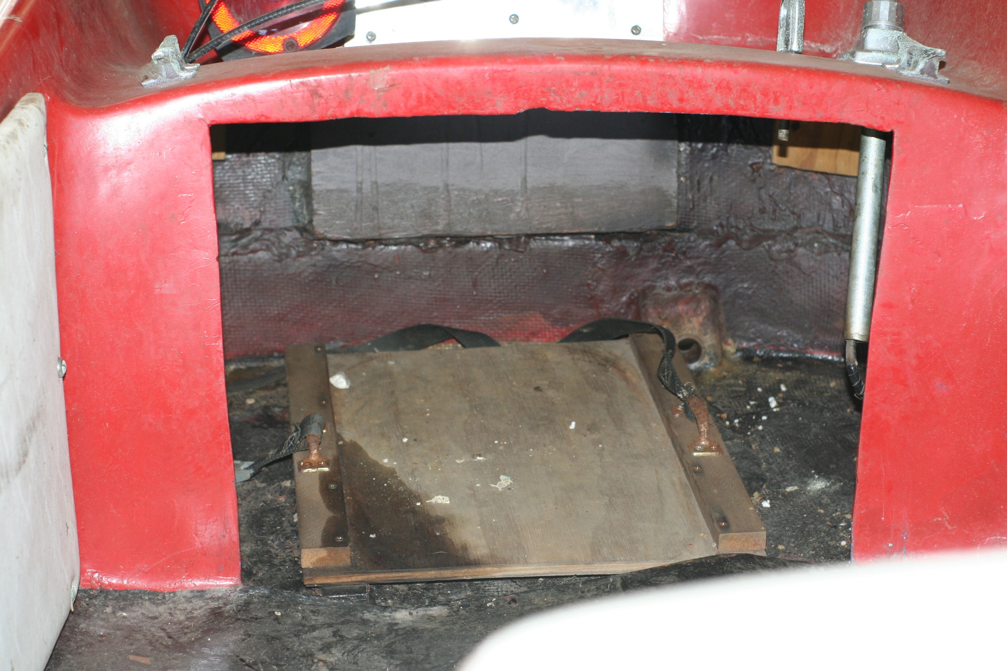

I have recently acquired my father's old Volksboat with a 1957 Johnson 18hp Seahorse. I looking to restore this boat with Mercury Mark 30.
This would be my first boat project but i'm not afraid to get my hands dirty to restore my father's back to its original glory. My first question is where do I start? The motor I want to use is about 35 pounds heavier than the old Johnson. Would I need to reinforce the transom to compensate for the extra weight? It definitely needs to be repainted, and the white paint on the hull is chipping away. Any help to point me in the right direction would be greatly appreciated.

First thing I would do is make good and sure the transom is good. Light tapping with a small hammer all throughout the transom should just make solid noise. If not solid, you may need a new transom. Where are you located? Maybe someone knowledgeable about such matters could come over and give you some advice. If the transom is good, there shouldn't be a problem with the 30 unless the boat is rated for something less.
Best of luck to you!
Volksboat project 7 years 3 months ago #139874

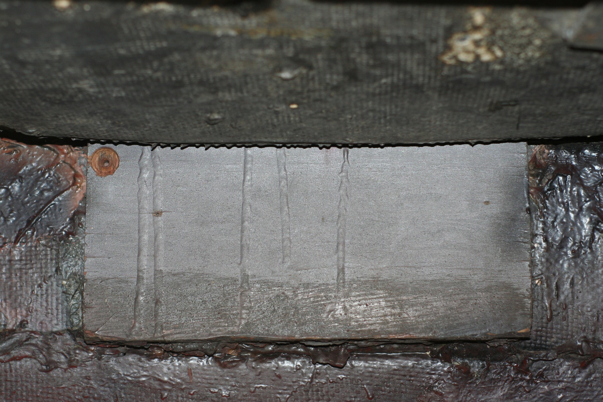

I'm about 25 minutes south of Chicago. The transom feels solid, has a little flex though when I was tugging on the motor a little bit. The boat is rated up to a 25 hp motor.
Volksboat project 7 years 3 months ago #139875
Basically, the transom should not flex. Hmm.
Volksboat project 7 years 3 months ago #139880
That is not a project. It is an undertaking. That transom should not "flex" it should be rock solid.
Strip and gut the boat so you have nothing but an empty shell. Remove all the trim where the upper and lower sections are connected and then separate the two. Flip them both upside down and then peel off that stuff on the transom and replace it with 1 1/2" of treated plywood epoxied together with glass mat. Address any issues that show up in weak areas. When you get that bottom flipped upside down it's easy to make strong repairs where needed.

I dunno Bill. Drilling a small hole from the inside might just crumble the entire transom :laugh:
From those pictures it looks like a someone already tried to put a patch on it and the crack on the outside is enough proof for me that the entire piece needs replacement.

That's why I suggested you separate the two parts so you can really get in there and do a complete job. If you plan on putting a larger motor on it you will need a stronger transom than what I see in your pics. I would go entire length, port to starboard. Another suggestion if you don't want to do the entire transom and just a motor section you should run two gussets from the transom to the hull floor. If you plan on pulling a ski or tube you will need the strength.
