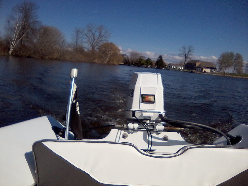

I have a 1959 Redfish, but the motor is a 1983 VRO 70 hp Johnson. I purchased this boat recently, and so am learning all about her. It seems to me that the engine is not the right fit for this boat. The previous owner put sandbags up under the bow, and it's a bear to get her planed out right, very sluggish until you find her sweet spot, plus even with this big engine, she only goes about 25 mph. My only point of reference was my dad's 1957 Redfish which seemed to plane out perfectly and quickly, with a smaller engine - and of course, no sandbags. Any suggestions about what I can do to get her fitted with the right size engine for her size/ and or modifications with this engine to fit the boat better
