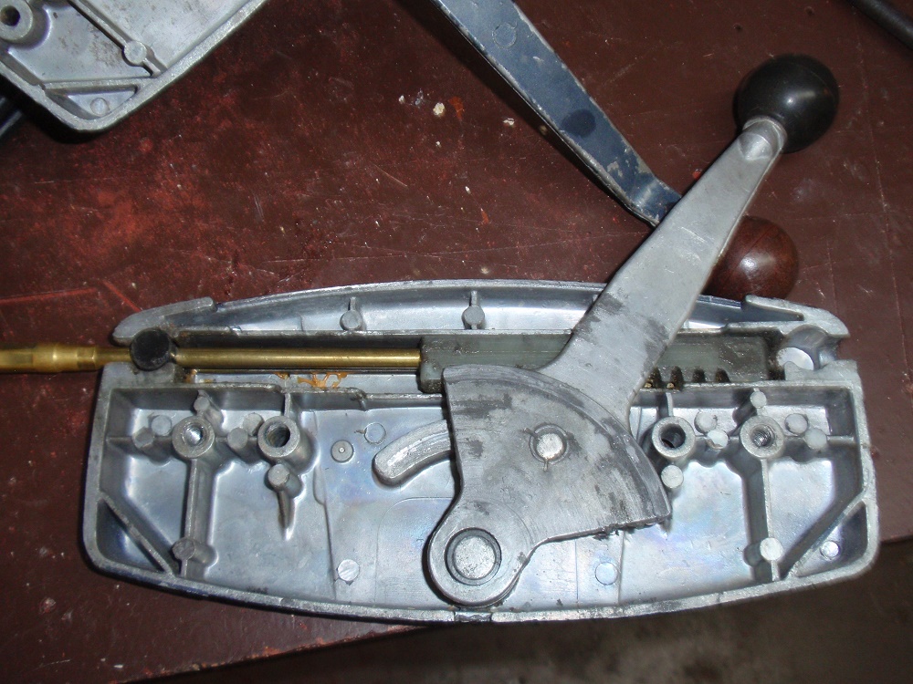

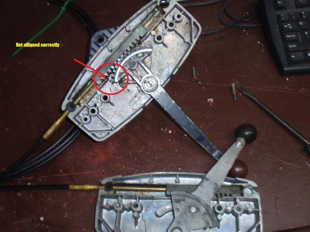

If I read your post correctly it sounds like you are on the right trail.
You can shift the gears at the motor using the lever so you know the problem is not on the motor end.
Sounds like the problem is in the controller and it is not throwing the motor lever far enough to engage the gears either forward or reverse? Or will it shift into forward but not reverse? visa-versa?
Here are pictures of an older shifter but the insides are similar. The cables are connected to a rack of gears and are moved forward or backwards with the lever that has matching gears. If those teeth are not aligned properly they will not move the cable fully in either direction. My suggestion is for you to remove the top cover of the shifter.(BE CAREFULL, IT WILL BE GREASY AND THINGS MAY FALL OUT) Take pictures of it before you do anything.
Disconnect the cables from the motor and then move the shift lever full forward. The gears should be in their final position, ie. first tooth on the lever matching with the first groove on the cable rack. If they do not match up just physically lift the rack and put it in position. You can see in the second picture that those gears are not right. They are one tooth away from where they should be.
If everything is correct inside the controller that like Herters said the adjustment would probably be at the motor end of the cable where the black thumb wheel rests in the cable mount.
There is nothing else to adjust. As an afterthought make sure that when the PO assembled the LU he correctly connected the shift lever coupler.

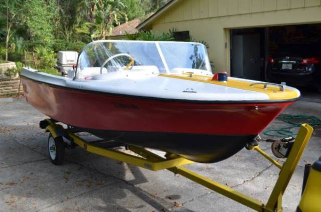

Johnson Ship Master Controller 7 years 4 months ago #139596
]Wow. Nice clean boat. I can see why you want to keep it pristine. Sounds like you're doing all the right things, getting advice and keeping safety and fun in their proper orders.
Looking forward to your decisions and maybe some pics on the water.
