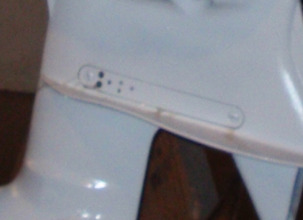

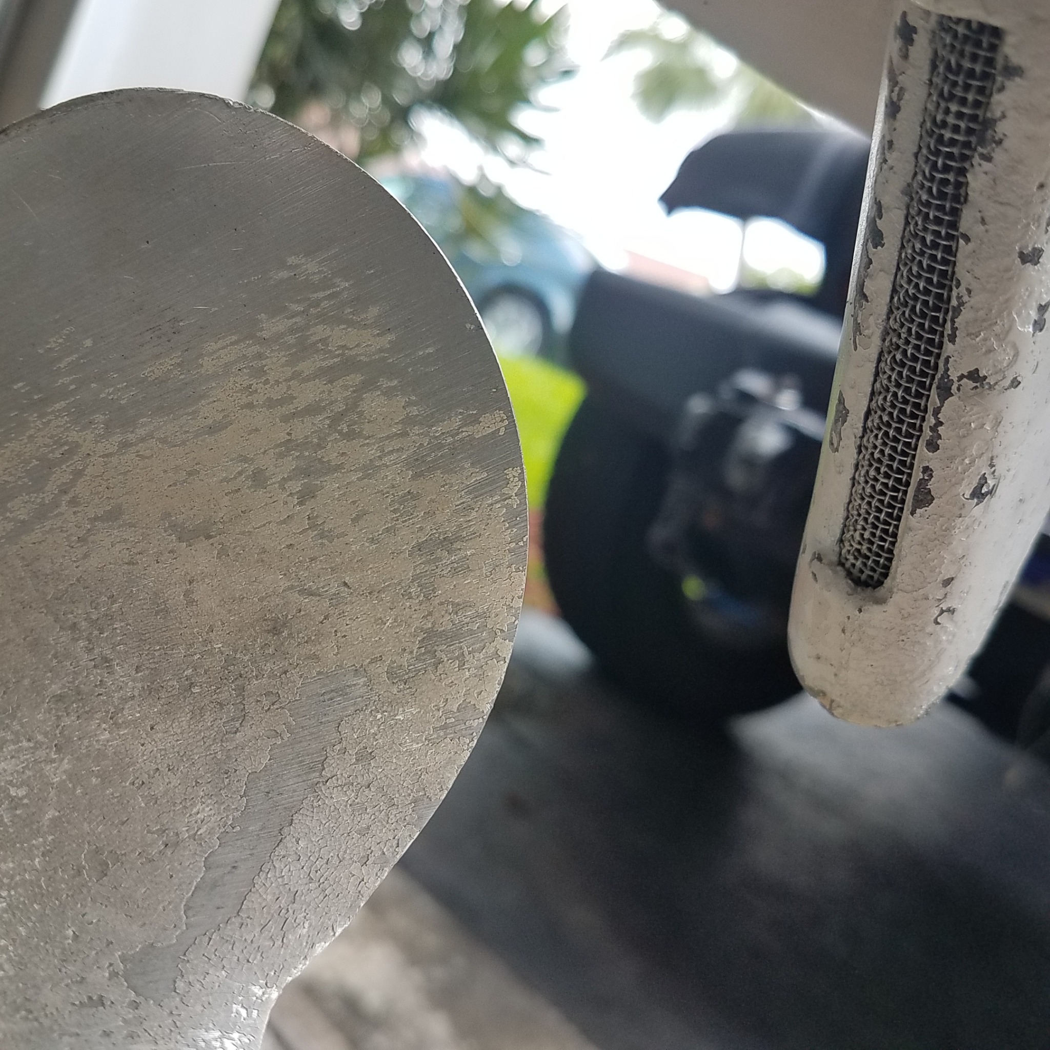

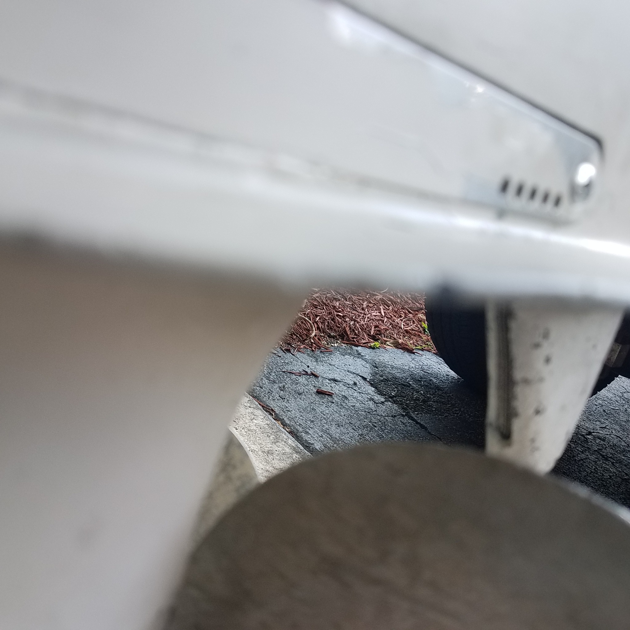

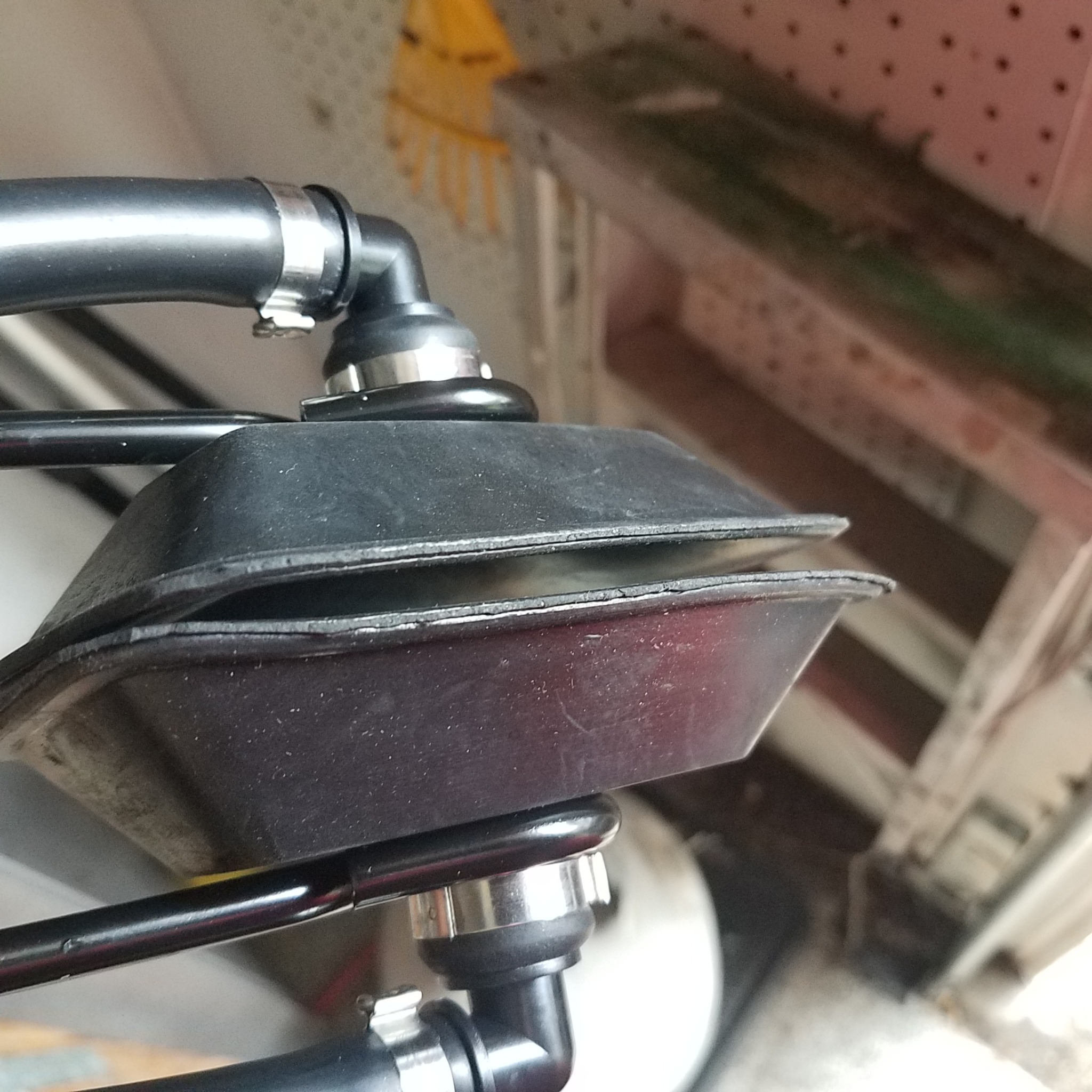

OEM Flush 66 Johnson Super Sea Horse 40 RDSL-28 7 years 4 months ago #139565
Thanks for your response and apologize for not being clear. 20190514_101026.jpg[/attachment I do have the oblong ear muff flush attachment and it fits over what appears to be one water intake as you show in your photo. What appears to be another intake is located above the propeller. As I understand it, all other intakes need to be covered. See photos. The only way I know of to cover the second intake is to use duct tape and it does not seem to hold. I'm told there was an OEM one that covers all intakes but I've never seen one...or know if it's true. Just trying to flush properly as I plan to run newly acquired boat/motor in salt water in Florida. Understand option to use flush bag or garbage can but prefer not to if other viable option is possible.[attachment=51773]20190514_101026.jpg[/attachment I do have the oblong ear muff flush attachment and it fits over what appears to be one water intake as you show in your photo. What appears to be another intake is located above the propeller. As I understand it, all other intakes need to be covered. See photos. The only way I know of to cover the second intake is to use duct tape and it does not seem to hold. I'm told there was an OEM one that covers all intakes but I've never seen one...or know if it's true. Just trying to flush properly as I plan to run newly acquired boat/motor in salt water in Florida. Understand option to use flush bag or garbage can but prefer not to if other viable option is possible.
OEM Flush 66 Johnson Super Sea Horse 40 RDSL-28 7 years 4 months ago #139566
Gotcha. I never found it necessary to cover that skeg inflow while using a garden hose. Put your muffs where you usually do and run the motor. You should have sufficient water flow coming out the exhaust and the cylinder heads should be running cool. That skeg opening guarantees that water is being pushed through at running speed. The prop forces water in there while underway. I believe most household water pressure is around 40 - 60 psi and is quite sufficient enough to pass through the cooling passages for a flush. It'll be fine.
