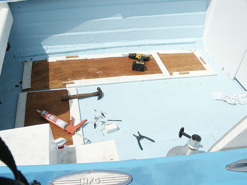

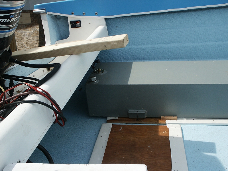

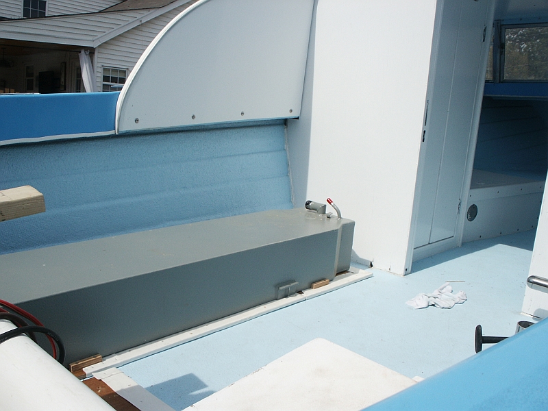

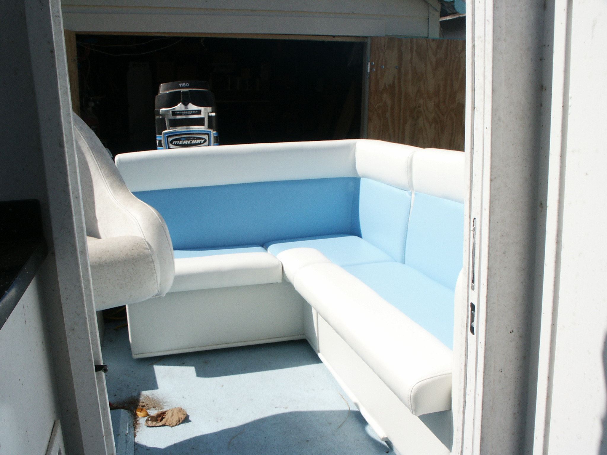

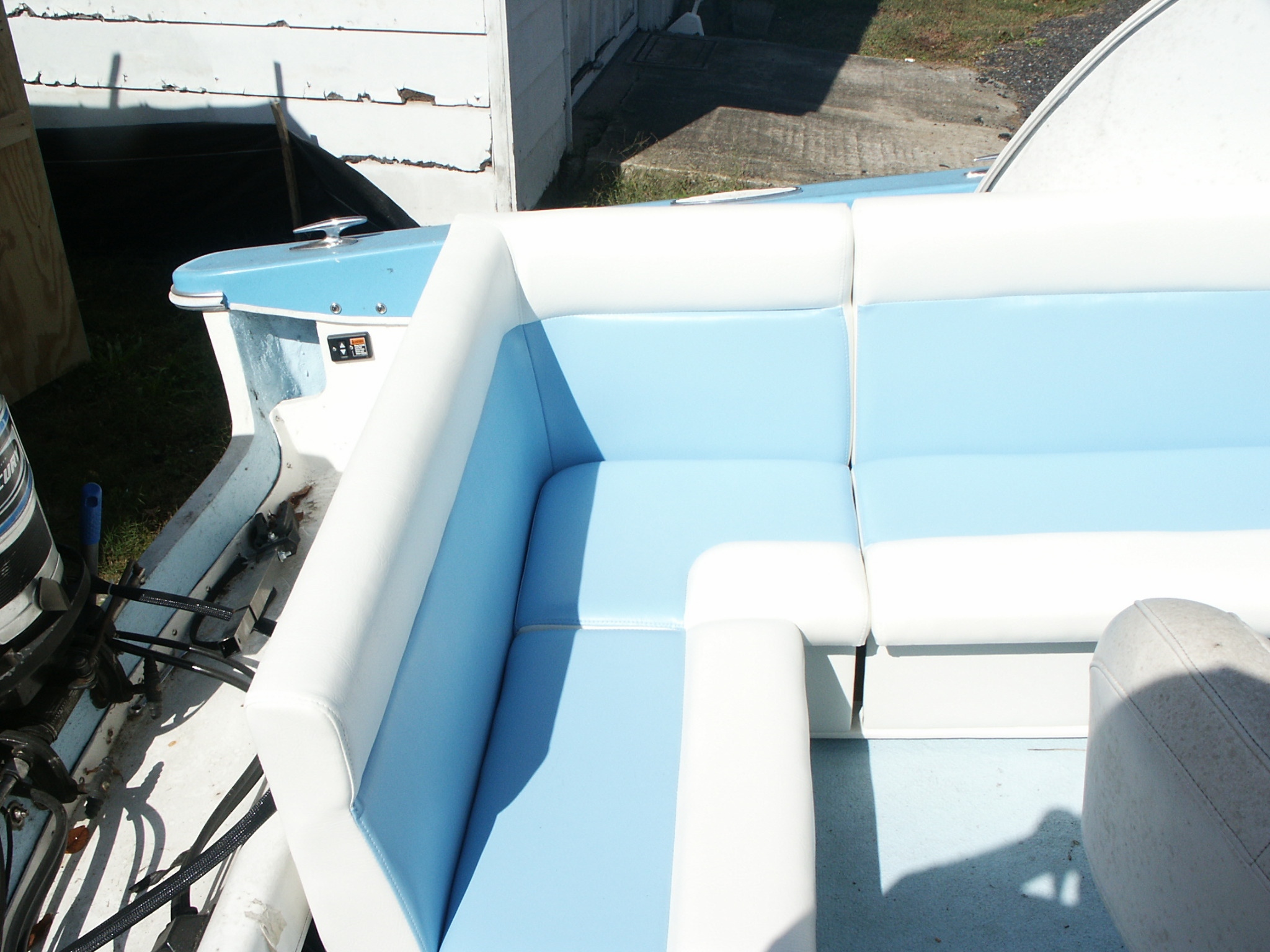

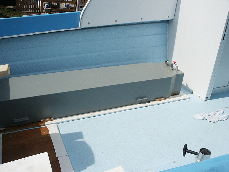

ok i have cleaned the mildew off the cabin. i used EZ house wash armor brand works great. spray it on ad rinse it off. then i used starbrite mildew blocker spray it on / wipe it off. i dont know about that stuff yet. we will see. and i installed the sending unit in the tank, installed the pick up tube, added the reducer for the mercury fuel line, and put rubber strips on the bottom of the tank. i mounted the seat bases , after dry fitting everything. i drilled holes and put 1/4" wooden pegs in before i removed them to locate the spot now. i installed the tank, i need a longer screws . i had my armrest to fit on the seat after it was installed. now i have to put the fill neck and hose on first , then slide the seat and armrest down as one. all that's left is fitting the batteries and battery switch and i have to change the impeller and both solenoids. oh did i mention the seats are being cut down 1 1/2" on the back. a bolster to fit behind the seat, and a movable upholstered cup holder . new decals for registration and twelve years later Done !!!!! .
